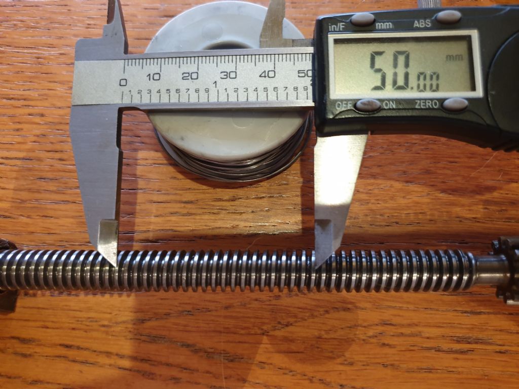

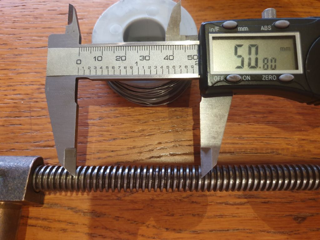

                      Measure twenty threads on the screw. If it's 50mm you have a metric screw, if it's 50.8 (or 51 to a steel rule) then it's an inch screw. Inch screws are 7/16" x 10TPI LH

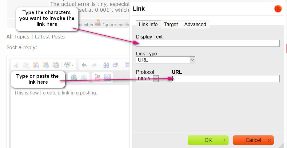

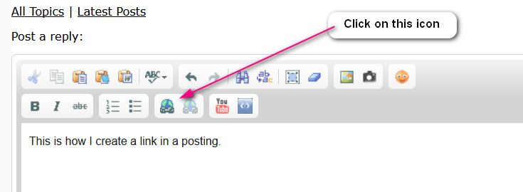

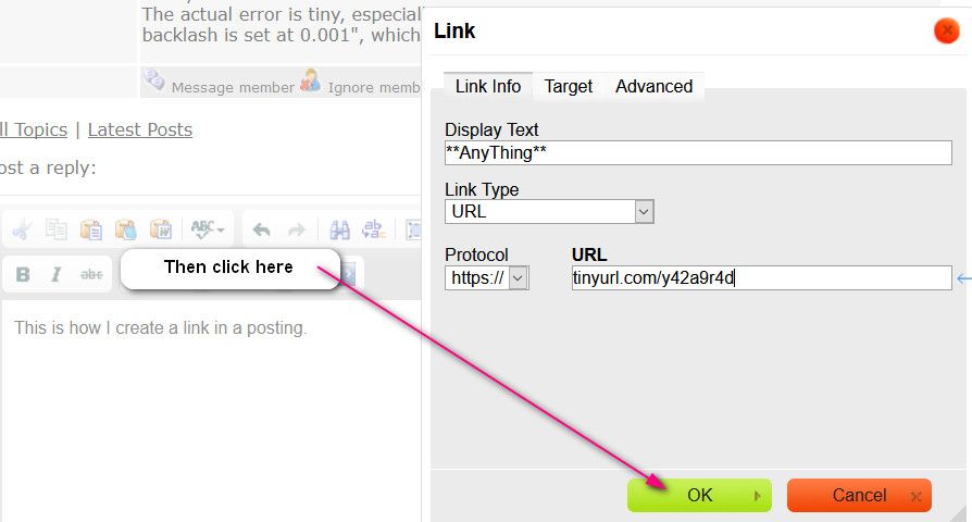

                                Here's how I insert a link into a posting.
                                Copy the URL of the link you want, either by writing it down or using the Windows COPY facility (ctl+C).
                                Then click the LINK icon above to bring up link window and enter the information required. When you click OK the link data is saved t the cursor position.
                                **AnyThing***

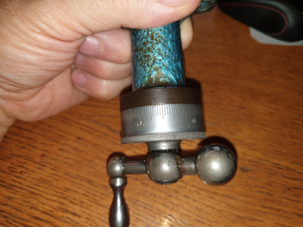

                                    Can you describe the graduations on the cross-slide dial please. How far does the cross-slide move when you rotate the wheel one turn? Take a marker pen and trace round the crest of the thread and tell us what you see.
                                    There is a possibility it could be 5tpi two-start.

                                              That is another give away – what dial do you have?

                                                Mystery is solved!
                                                I carefully read all your very useful suggestions and information.
                                                I drilled and tapped a piece of scrap aluminium and it fitted comfortably on my spare lead screw which confirms that the spare is imperial. I am still a little puzzled that my 7/16" x 10 ACME tap doesn't seem to fit the existing brass nut on this leadscrew.
                                                Using the tip above from Pete Rimmer the measurements he gave confirmed the spare leadscrew as imperial and the one on my lathe with the worn brass nut as metric. This also explains the graduations on the cross slide dial which are numbered 0, 0.5, 1, 1.5, 2.0, 0 with 50 graduations between each number (a total of 250 graduations). Unfortunately I do not have the imperial cross slide dial, only the leadscrew and nut.
                                                What tap do I need to cut a metric thread to match the metric leadscrew? I presume it is a trapezoidal tap but the sizes confuse me and they also seem quite expensive compared with the imperial ACME tap I have already purchased.
                                                Imperial leadscrew (my spare):

                                                Cross slide dial:
