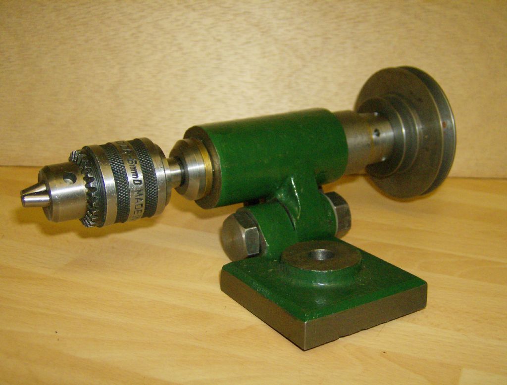

                              This is how they didikt in the old days, 'Potts Spindle' castings still available.
                              I made this out of an old pistol drill, I fitted the epicyclic gearbox in the steel block, the motor is in the old spice container. Drills well, doesn't mill very well due to end play.

                                        Used to be available from Hemingway, but I think it's been discontinued, although they sell castings for two other Potts projects.
                                        If you can weld, it wouldn't be hard to fabricate and you might actually get a better result.

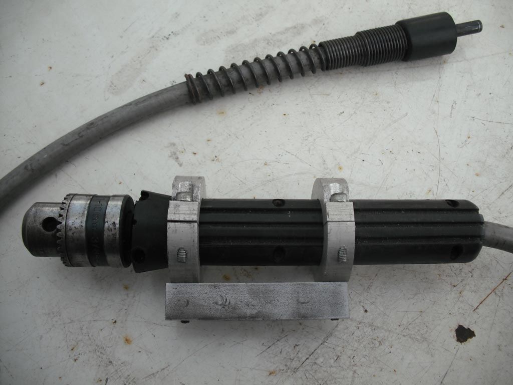

                                                This is one I put together several years ago for a certain job. I don't think I've ever used it since then. The spindle, chuck and flexible drive came as a complete assembly, but I can't remember where I got it from. All I had to do was make the brackets to hold it in the tool post. It was driven with a portable electric drill held in a bench vice.tolpost_spindle.jpg
