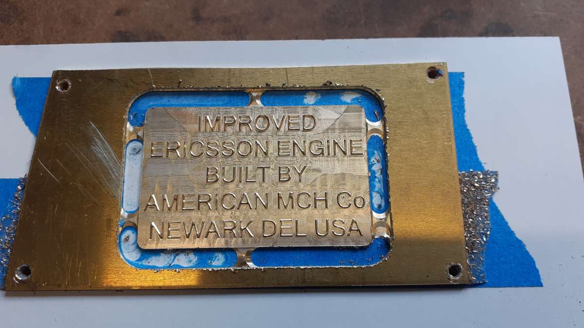

                                                Fairly standard practice if you are mounting work where depth needs to be fairly accurate, I often skim the top of a mounting block if held in the vice or a backing board if fixed to the table. When you are setting your machining heights to 0.1mm increments or less then you need the work and what it is fixed to to be flat. particularly if you ar estarting with stock that is already the finished thickness, not such an issue if it is thicker as you just skim the top of the work and often the bottom as a second op.
                                                Good example here where I set the depth of the outer profiling cut to be just a bit more than the material thickness and you can see I have cut through but not gone as far as cutting into the board below. So within two thicknesses of tape.

                                                  #743856
                                                  Paul L
                                                    @paull58212
                                                    Jason,
                                                    Can you tell me how you got the letters engraved please?
                                                    Im trying to make some labels out of two colour plastic.
                                                    When I import the DXF into Desk Proto it wont create the cutter path around the letters because they are to small. I just need the letters to be a single line but they appear in the DXF like this so it wants to create two cutter paths
