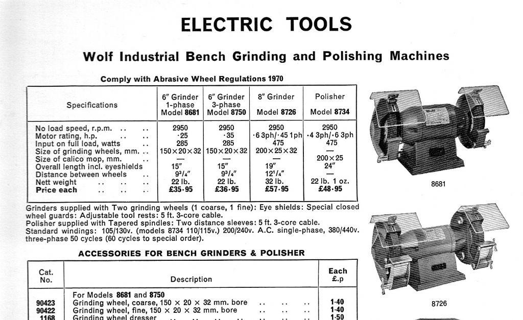

                                    I will try and explain things there is a white lead coming out of the grinder with a plug joiner like you would get on a lawn mower, this was plugged into what looked like an orange lawn mower lead with a 13 amp plug on the end. the man at the car boot sale said he had tested it and it run ok. I got it home and plugged it in and it sounds and runs very nice, then i looked at the label that said 110v and switched it off. the owner that is now dead was an electrician by trade and an engineer as a hobby so lots of Moore and Wright tools for sale so anything may have happened to this nice grinder.

                                        Hi Paul, looks like model 8726 which was made in 105-130V 200-240V A.C. single phase and 380/440V three phase.scan_20150416.jpg
                                        This scan is from a 1974 catalogue.
                                        Regards Nick.

                                            panic over it is 110v 15amps on start up and had too much stuff running, but at least i have found a nice helpful forum
