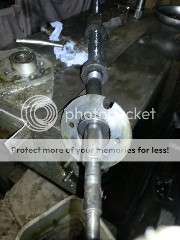

                                                With the circular plate removed from the dowels the leadscrew will slide out of the side of the bed.
                                                [​IMG]
                                                And finally, the leadscrew is removed.
                                                It took rather a long time to achieve this, but hopefully now it is written up, if anyone else ever needs to do it, it should be a lot easier.surprise
                                                The only real damage was the end of the leadscrew where the handle fits has got a bit bent whilst I was drifting off the dials, hopefully this will get straightened out in the hydraulic press.

                                                      Not sure if it shows in the picture but the "depth" of the mating surface when referenced against the casting of the knee is very different across the length of the surface.
                                                      It looks almost like it is worn at one end, especially as it feathers out onto the casting, but looking at the depth of the oil ways they are all pretty consistent.
                                                      The bottom left of this picture is the side that looks particularly “flush”
                                                      [​IMG]
                                                      So question is, is this where the knee would have been ground flat when it was manufactured and the differing depth is due to the original casting being rough?
                                                      Cheers
                                                      Paul.
