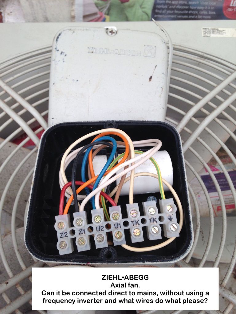

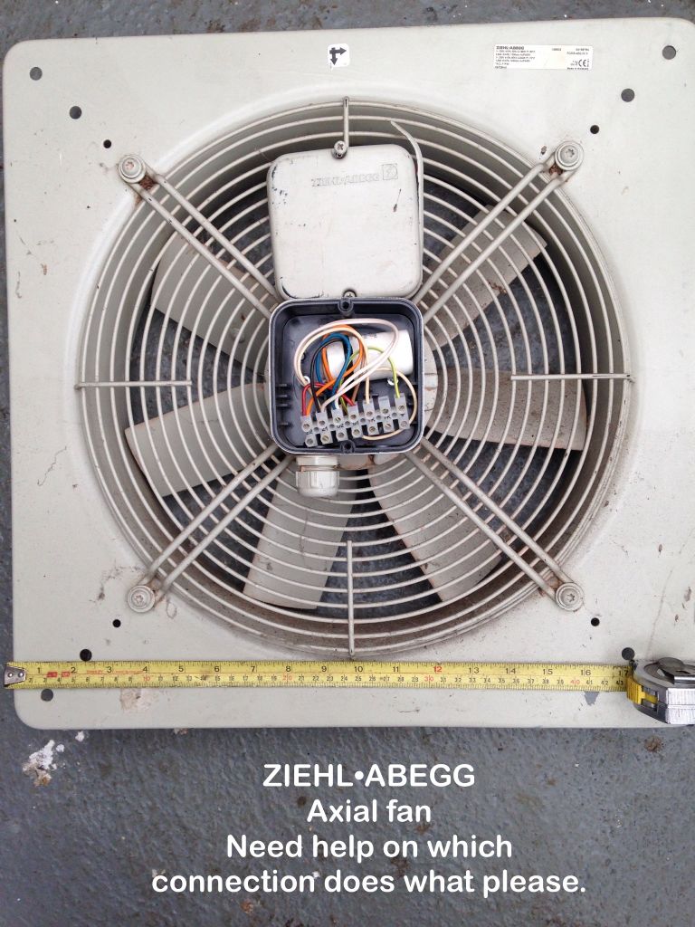

      Help needed connecting it up to power please.
      #237175
      OuBallie
        @ouballie
        Neighbour gave me this fan when I mentioned that I was looking for a means of extracting the dust from the Carport, when I start doing the final grinding to get the Austin Seven's body down to bare metal.
        Can it be powered without using a frequency inverter please and If so, what connections to use?
        Certainly not worth buying one, as I could no doubt get 3/4 pedestal fans for the same cost.

          HERE might be a good starting point; I should say, I've no experience of these things myself, so if you blow yourself up, son't blame mewink.

            Geoff, You don't need an inverter and variable speed wouldn't help in your situation anyway – you want 'suck my wig off' full blast anyway.
            This diagram is looking helpful but wait for a bit more input. A picture with the wires and capacitor spread out or connections listed might help.

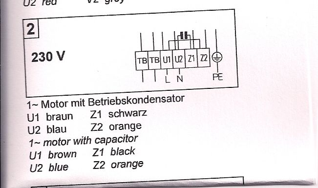

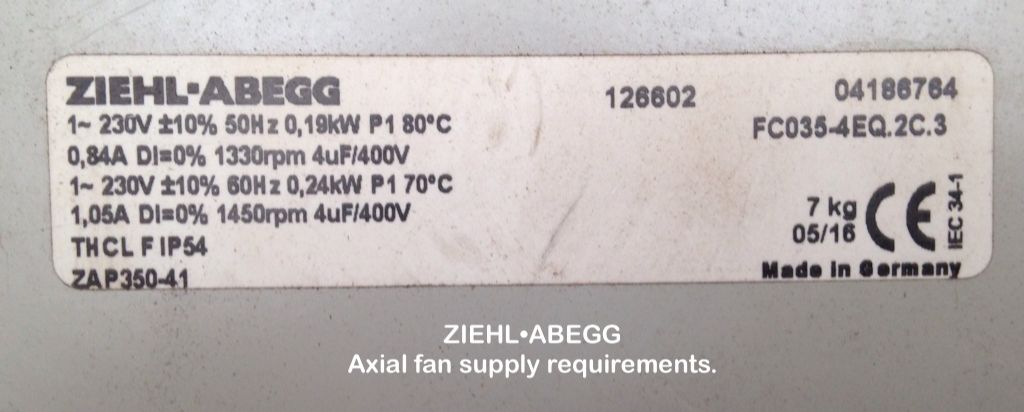

              Peak4's link (the tab where it says "wiring&quot suggests you connect L and N to "U1" and "U2" – and connect up the ground also, as it doesn't appear to be double insulated. Looks sensible to me – Germans use "U" where we use "V" for voltage.
              It's a single phase 230V motor, so nothing fancy required beyond a 2 wire connection. I suspect the cap may simply be for power factor correction but am prepared to be wrong.
              If you're not certain, use an RCD and make sure you have the correct fuse fitted – 3A probably enough, otherwise 5A.

                U1 and U2 are the run winding, Z1 and Z2 are the start winding. The TK connections are for the thermal cut-out switch. It should have a control box to go with it. If it was mine I would try and trace the wires and check with a multimeter to make sure that the U and Z connections were, in fact, the winding connections. There may also be a centrifugal switch inside the motor housing to switch the start capacitor out when its running (but it may be that the start winding is unswitched). You should also be able to see how the start capacitor is connected – it looks as though its connected to z1 and u2.
                Lots of possibilities here **LINK** – some of the diagrams show that connection L to u1 and N to u2 would be ok, other diagrams use one of the TK connections as the live, presumably so that the live is fed via a temp sensitive switch.
                It looks as though your thermal switch is connected to TK and the bottom half of the U1 connector block. If that is so, and you want to use the switch, then L should be connected to TK and N to U2. If you want to bypass the thermal switch connect it as Muzzer suggests. But I'd like someone else to verify that or come up with an answer that is more authorative.

                  As Muzzer says, Live to U1 and Neutral to U2. If you want to use the thermal cutout connect Live to the TK connection next to the U1 connection.
                  There is no centrifugal switch, it's a permanent run capacitor. We use dozens of Ziehl-Abegg fans and motors at work, so if you need a copy of the actual wiring diagram let me know and I'll dig one out tomorrow. Slight bank holiday brain fade today!

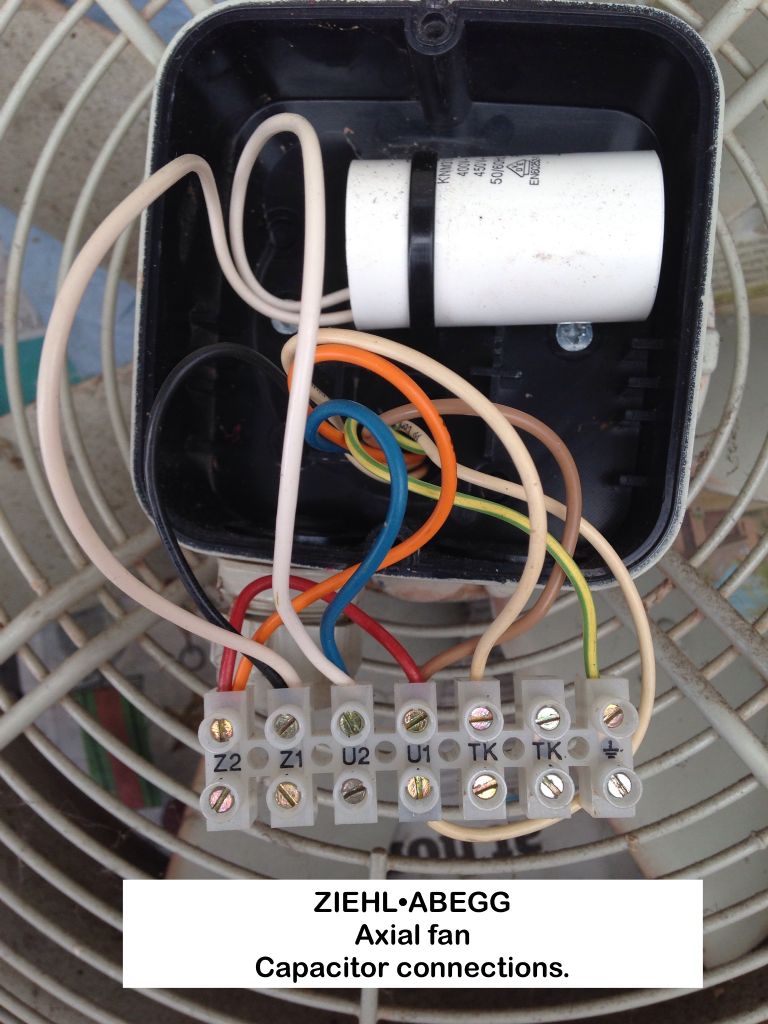

                    Will take another photo of cable connection Bazyle.

                      Bazyle,
                      Photo as requested.

                        Geoff, see the diagram below, but wiring as my previous post.

                          Just spotted the better picture of your wiring – the thermal cut-out is wired in, so either put the Live in the TK terminal next to the U1 terminal, or take the cream wire out of the bottom of U1 and put the Live in there.

                            Thanks guys for the help👍

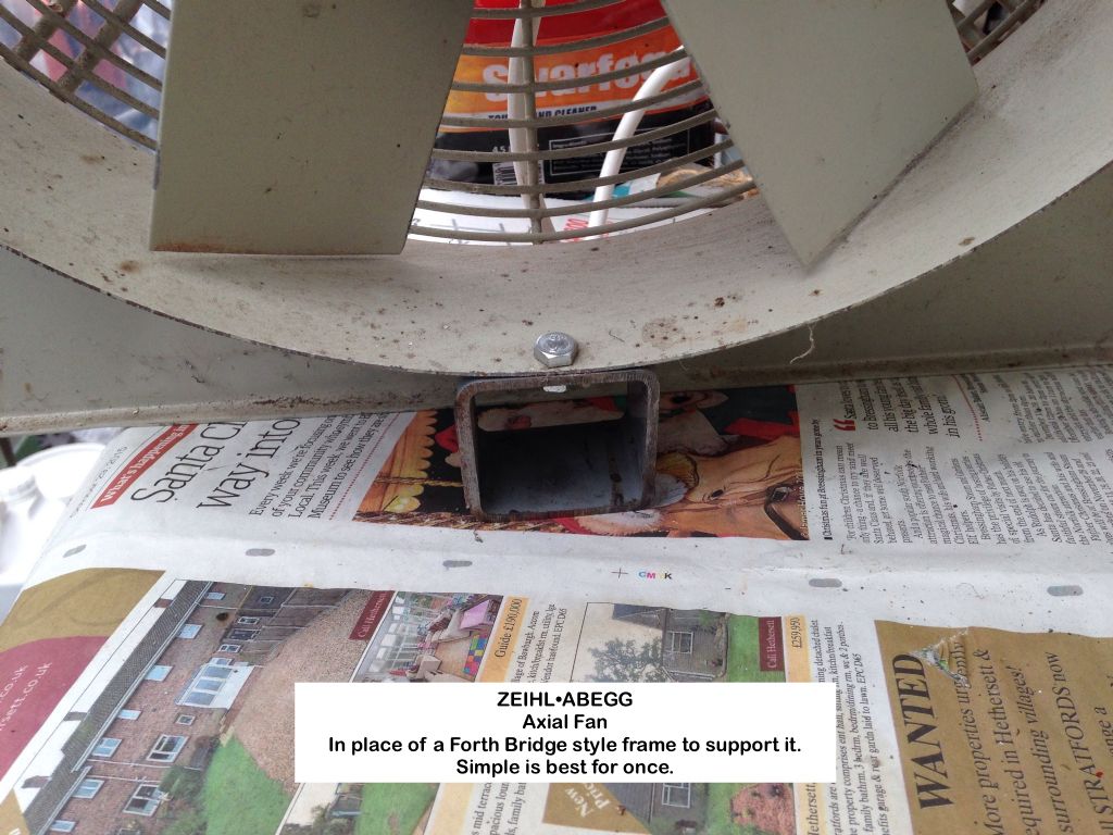

                            It's working and blows a gale.
                            Was about to design a frame to hold it, that would have done justice to the Forth Bridge, but fortunately caught myself just in time, and studying the unit soon realised that a bit of 2" sq steel tube bolted to the cowl would do the job.
                            Took all of five minutes, as against a day/s!
