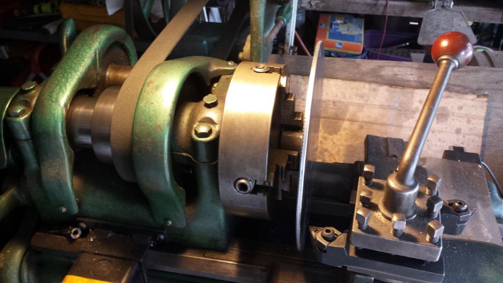

              #235056
                Use a left hand tool to reduce the diameter rather than the right hand one you show in your photo as it will fit without the risk of catching the overhanging jaws
                First deduce about a 10mm length to 40mm then hold by that in the outside jaws while you turn the 64mm dia, bore and part off.
