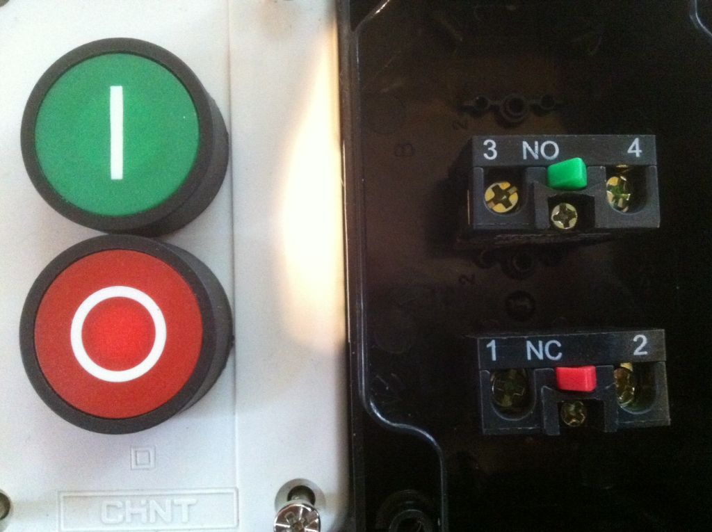

              Thank you Michael and Russell for your fast replys. it does want to be a direct connection with the motor yes. The idea in my strange head would be as simple as cutting a standard 240v cable in half, connecting the plain section from the motor to the green and red push button switch, and the plug half of the cable from the switch to the wall socket!
              Here is an image of the switch:

              #93599
              John Shepherd
                @johnshepherd38883
                James
                From your picture it looks as if you have got the wrong type of switch as Michael and Russel have said.
                You have two options, 1. buy a no volt release switch. This will have a momentory push buttons for on and off. When you press the on button a relay will latch on and maintain power to the motor until you press the off button.
                The second option is to use a simple on off switch.
                Option 1 is safer because if the power is disconnected, the motor will not start without pressing the on button again. With option 2, if the power is removed and the switch is left in the on position the motor will start when power is restored.
                If going for option 2 it is advisable to use a double pole switch that switches both line and neutral. In both cases the switch needs to be able to handle the starting current of the motor.
                Hope that helps

                      James
                      Axminister power tools sell a no voltage release switch. I am using one on my lathe and they work fine.
                      #93616
                      John Shepherd
                        @johnshepherd38883
                        James
                        The one you have highlighted should be fine (providing your motor is not rated at more that 6 Amps).
                        With this and similar ones though, remember you will need to provide a box, suitable cable clamps and possibly spade connectors.

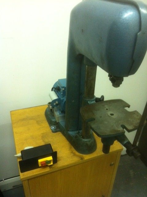

                          Hi guys,
                          Thanks for all your help. Here is the finished tapping machine with single phase motor and switch. All bolted down to a cabinet:photo (3).jpg
                          #95837
                          David Lawrence 2
                            @davidlawrence2
                            Hi all, nothing wrong with that switch but it needs a relay as well to turn the motor on. Often the relay or contactor is in another box away from the motor so vibration does not shake it apart. best thing would be to buy the no volt release switch from axminster tolls and put this switch unit back on e bay. david
