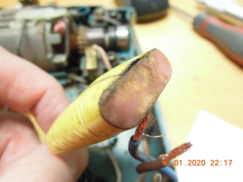

      Hi all you electrical specialists….
      I've had a Makita variable speed drill for nearly 30 years. In the long distant past I remember on one occasion getting an electrical 'pop' from around the switch area when running at low speed. It did it again yesterday, only this time it tripped the circuit breakers in the garage (where I was working) and the one in the house that feeds the garage. Thinking it was probably 'terminal' this time, I immediately stripped the drill to see what inside had failed.
      I stripped the switch unit (which contained a small circuit board) and could see nothing amiss. No damage or signs of burning. I cleaned it all up and relubricated with Barrierta and reassembled. The device next to it was a dual capacitor. This looked old, a little swollen, but not conclusively busted in my modest opinion. So I put it all back together and tested the drill. All is well !
      So what inside the drill might make a big pop noise, trip the trips and yet appear to be unaffected / undamaged ?

          You said it, almost 100% sure to be that swollen capacitor. They're strapped straight across the mains and their purpose is to filter out interference that would otherwise broadcast freely off the mains wiring. The capacitors are highly-stressed, but, when they go pop, they fail open-circuit after upsetting the trip. When power is restored, everything works again apart from the capacitor. No problem except the drill is now unsuppressed. Without an electronic nappy the drill (EDIT mind the language) down the mains, which can upset nearby radios and internet connections!

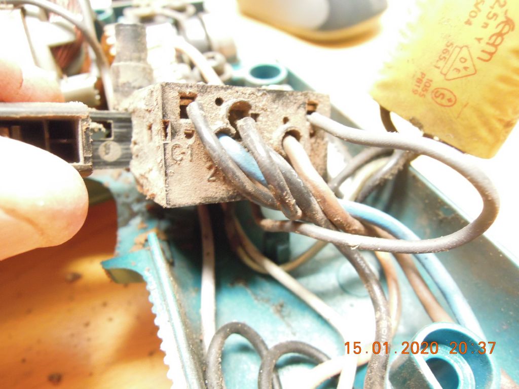

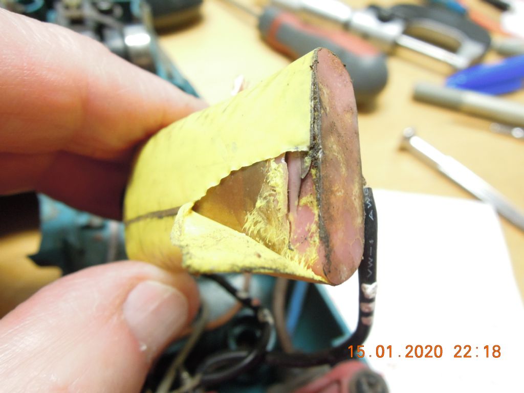

                  The drill is double insulated so no earth leakage. Not sure how then I would would get a L to N differential to flip the trips ?
                  There is some blackening on each end of the capacitor but decided it was probably dust from the seams of the clam-shell where the ends of the cap. resided. Perhaps I'm wrong. Your thoughts would be welcome.
                  Here's some pics.

                    Hi Gerry, that would be your suppressor blown, which would have been a short across the mains and activated your trips, needless to say the suppressor no longer works.

                              Hi Gerry, although your suppressor may be self healing, it doesn't necessarily mean that it is self repairing. As .Andrew has explained; the film evaporates and removes the short circuit. The black mark and the slight lifting of the outer wrapper on the end, suggests that this is what has happened. At best if it is still working, its efficiency is probably reduce somewhat and may cause radio interference, it should not affect the drill operating as it always has though. Maybe Andrew will enlighten you if it is any different.

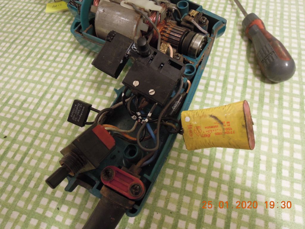

                                          Oh dear sometimes things are straightforward, sometimes not. I ordered 645011-4 and I'm sent 645006-7. Its probably an appropriate equivalent however the real issue is that its completely the wrong part . Had I delved deeper when I opened the drill the first time, I would have seen the real suppressor was lurking below the reversing switch – left hand object in the picture below.
                                          What I was expecting was the 3-wired yellow thing on the right. The black suppressor has the Makita part number on it which ties up with the number given on here. However the yellow thing has lots of numbers but nothing resembling a Makita number. Strangely I cannot find even a parts diagram for this model drill that shows this item. Perhaps the yellow thing is part of the electronic switch unit, or even the field winding (as one lead disappears into this unit), I don't know. But if this particular part is unidentifiable, let alone buy, perhaps I should just keep using the drill and put up with the once-every-two-year 'pop and trip'.

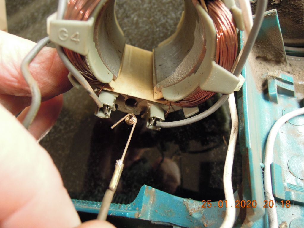

                                            As I mentioned in the previous post, the middle lead from the yellow thing goes into a hole in the laminated core of the field windings. I pulled at it and it came out relatively easily to reveal a coppered spiral spring-like thing. As a single lead it cant be a temperature sensor. So any ideas ?

                                                      I'm pretty sure that the 'yellow thing' is a mains suppressor, comprising three capacitors in a delta network, and it's certainly the culprit. The second line of print on it (obscured at the start) is probably decoded as '1 off 150nF and 2 off 2.5nF'. It's followed by a 'Y', which presumably identifies the capacitors as Y-Class. 3-capacitor delta suppression networks are used all over the place, made by many manufacturers, and available from places such as RS Components. Cheap. Component values won't be critical. No need to hunt for a 'Makita' one, just get one around the correct values (there won't be much choice) and a suitable physical size. And search the 'net for delta suppressor capacitors or similar, for more info.
                                                      One leg to live, one to neutral and the third to ground (earth). The spring will just be the ground lead's connection to the motor's earthed frame.
