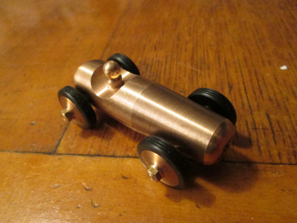

                    Mick B1
                      @mickb1
                      Posted by JasonB on 11/06/2019 17:19:39:
                      Rustins though you need to be careful not to get brush marks as it dries quickly and will drag.
                      Yes, you need to be quick, but you get a good finish if you are.
                      This racer for the grandkids (in Brio gauge ) is phosphor bronze and delrin – I varnshed it with Rustins a couple of weeks ago:-
                      Hope it keeps its shine.
                      Edited By Mick B1 on 11/06/2019 22:08:33

                        #413815
                        Daniel
                          @daniel
                          Mick,
                          Just love the racing car. yes
                          ATB,
                          Daniel
