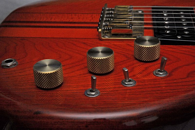

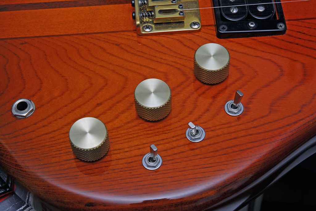

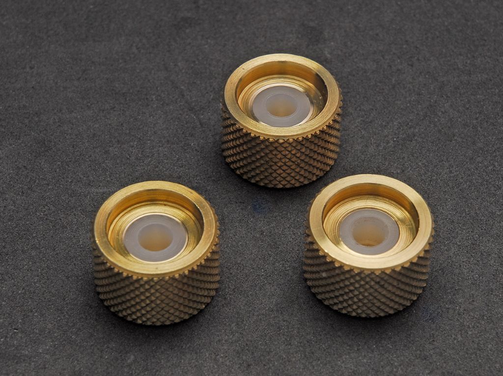

                I spent some time on the lathe today and I think I'm just about there using the press fit method.
                I drilled 10mm holes which finish at 10.14mm and turned down some 10mm nylon rod(10.34mm as supplied) to 10.24mm, so an interference fit of 0.1mm ish.
                The plastic inserts are then drilled 5.8mm and are a good push fit onto the splined pot shafts, a bit tight actually so I might try a 5.9mm drill. As a bonus if I mess up a plasic insert I can just drill it out and replace it. If I can get consistency, the jobs a good `un, then it's off to the local laser etcher to have some characters added to one knob in each set.
                I think I might owe a couple of beers to few people here
                Thank you all again for your expertise and encouragement.
                Ed.

                    Nice work Ed!
                    I'm also impressed with your clean knurling. That's a job I never enjoyed doing.
                    Sam

                      And a nice Guitar, can't figure out what it is…
                      N.
                      #237813
                      Ed Duffner
                        @edduffner79357
                        Thanks chaps.
                        Neil, it's a Westone Thunder 1A (A for active circuit) 1984 I think. Refinished in Nitro Cellulose Laquer, various shades.
                        Ed.
