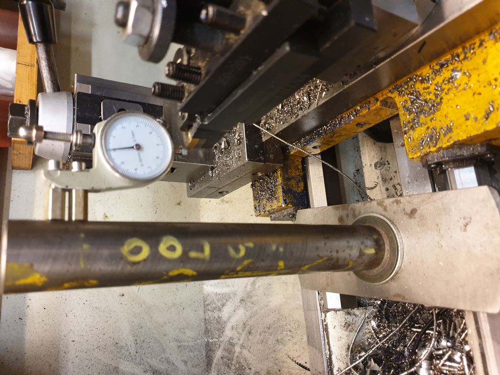

                                  My method is:
                                  Place a bar of known diameter in the chuck ( I use silver steel )
                                  Measure the eccentricty with a DTI or Finger clock (depending on how confident you are in your chuck ) I use a Vernier Height Gauge., but an adjustable pillar with ends faced square is quite acceptable, to measure off the Bed or the surface of the Cross Slide.
                                  Note the reading.
                                  Deduct (Half the eccentricity + half the bar diameter ) from the reading. Here "eccentricity" means the MAXIMUM .
                                  THIS figure is your Centre Height from the Bed or Cross Slide. By whatever means you choose, Slips / Height Gauge and Clock / Adjustable pillar, (Adjusted with Micrometer, Calliper ) set your Centre Height Gauge to this dimension.
                                  For tools mounted in the Front Toolpost, the underside of the blade should be set to this dimension.
                                  For tools mounted in the Rear Toolpost, the tip of the tool should be set to the upper surface of a blade.
                                  The Upper surface of a Lower blade sets the tools in a Rear Toolpost. The Lower surface of the Upper blade sets tools in the Front Toolpost. .
                                  The time spent on this procedure, saves a lot of setting up time, and unless something moves, no pips when facing!

                                        I use a cheap "thickness" gauge.
                                        Works pretty well.

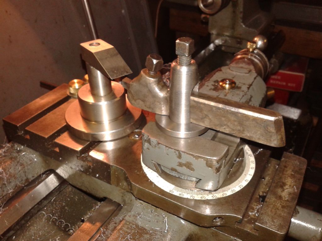

                                          For final finishing I have found this tool quite handy, especially on 'difficult' materials. Shear tool
                                          It is not picky regarding height as it is automatically on center due to the design. Indeed, I raise and lower mine with the QCTP to present a fresh edge for the final finishing cut.
                                          Notice that I said "Finishing Cut" – only good for the last 0.001" or so but what a lovely finish.
                                          If I had the time it would be interesting to experiment with the cutting angle for various materials. I have noticed that brass with a finely honed HSS edge can appear as a mist of tiny motes when the light is right.

                                            Danny thanks mate for the link to the shearing tool.

                                              I use a length of aluminium round bar faced off at each end,the length is the centre height of the lathe (bed to Centre) at the top end I have an offset steel penny washer secured with a small screw the washer overhangs the ally bar by about half an inch on one side, To set a cutting tool the top tip of the tool just slides under the washer,I used alloy bar so that if dropped or knocked over it does not damage machined surfaces of the lathe, I got this idea from my first job,a similar tool made from steel was used to set tooling on a Ward capstan, to set the rear toolpost tools the top of the bar just slid under the rear tool . Simple !!!

                                                  That shearing tool works on the same principle as a skew chisel in woodturning. Hard to use woodturning to avoid a dig in but that wouldn't happen here. I'll have to make one because I find it difficult to get a good finish. Thanks for the post.
