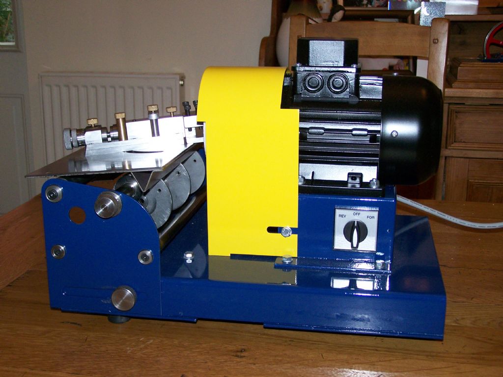

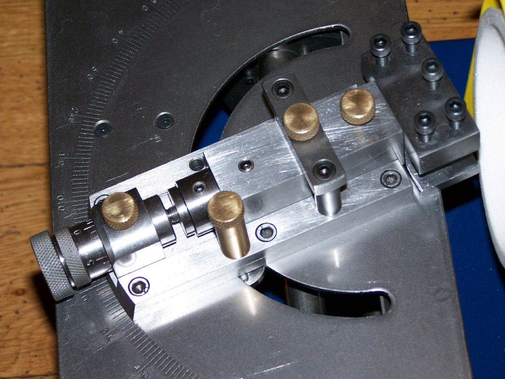

                            Mine was my Worden T&C grinder built from a Hemingway kit.

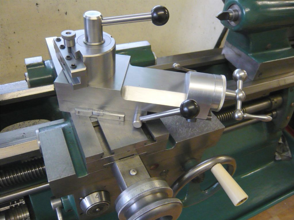

                                      Mine is a Lever Locking Topslide. This is the latest version on a Chipmaster lathe. It is so useful to be able to position and angle the topslide anywhere on the cross slide and instantly lock it in position. It also has a screwcutting retract and a slide locking lever below the feed dial.

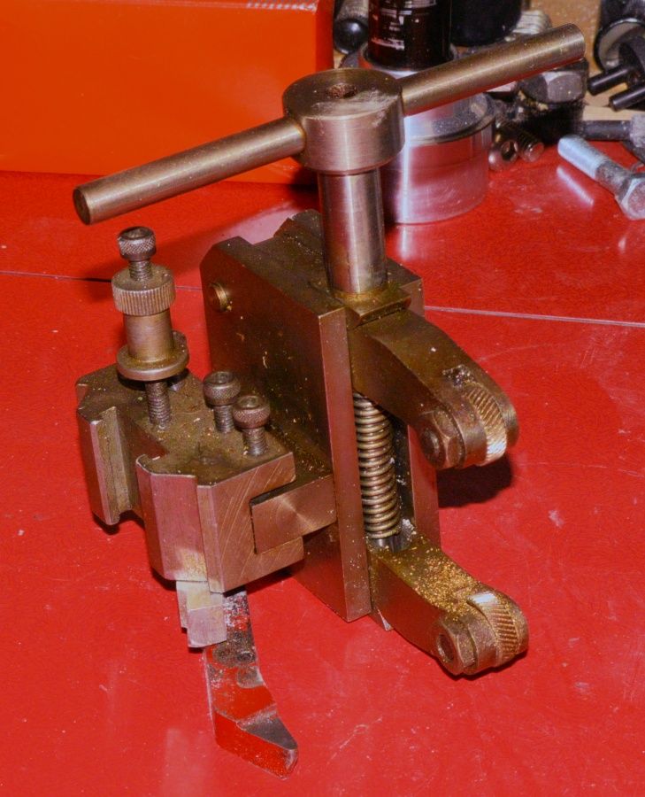

                                            I have to bend the tittle and little. I did start making one of these when I bought my first miller but changed lathe and it came with this. It's easily the home made tool that gets the most use by a large margin.

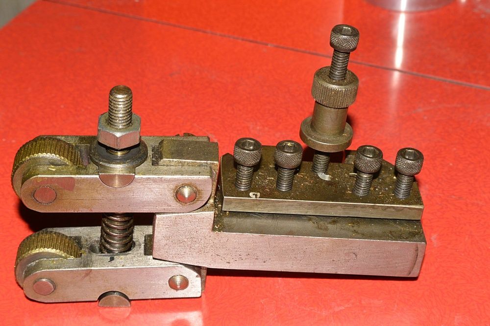

                                                John, that's a nice knurling toolthumbs up. I've recently repaired (again!) my piece of Chinese spaghetti known as a straddle knurling tool, and I always swear that I'll make a decent one. Maybe integrate your RH plate and the QCT holder into one piece…
                                                #213003
                                                Ajohnw
                                                  @ajohnw51620
                                                  Posted by Roger Head on 18/11/2015 12:05:23:
                                                  The only problem with that one is the knurls it's based on. It would be best to pick a size of good quality HSS knurls that can be bought easily with different patterns and degrees of coarseness. On the other hand when I have used a coarser diamond pattern I have often found it to be too sharp to hold comfortably.
                                                  The owner of the lathe made 2. Or maybe the owner before him made it. The other one is a different design. I'll post a shot shortly. The arms need to be longer on it. So far it's done what I want when needed.
                                                  #213008
                                                  Ajohnw
                                                    @ajohnw51620
                                                    I have elongated the slots that the clamp passes through on this one but should make new arms – when I need too. The pivots on the clamp need to be larger too allowing more angular movement leaving more space for the nut or handle as per the other one.
                                                    They aren't difficult to make really. The fiddly parts are the various screws – home made slotted heads. It might be possible to modify bought high tensile ones. They only need to be threaded for a short length directly under the head. Grub screws would keep the width of the heads down.
                                                    You can see that the last thing I used them on was brass. They are ok on al and fc stainless too but that one takes a lot of pressure.
