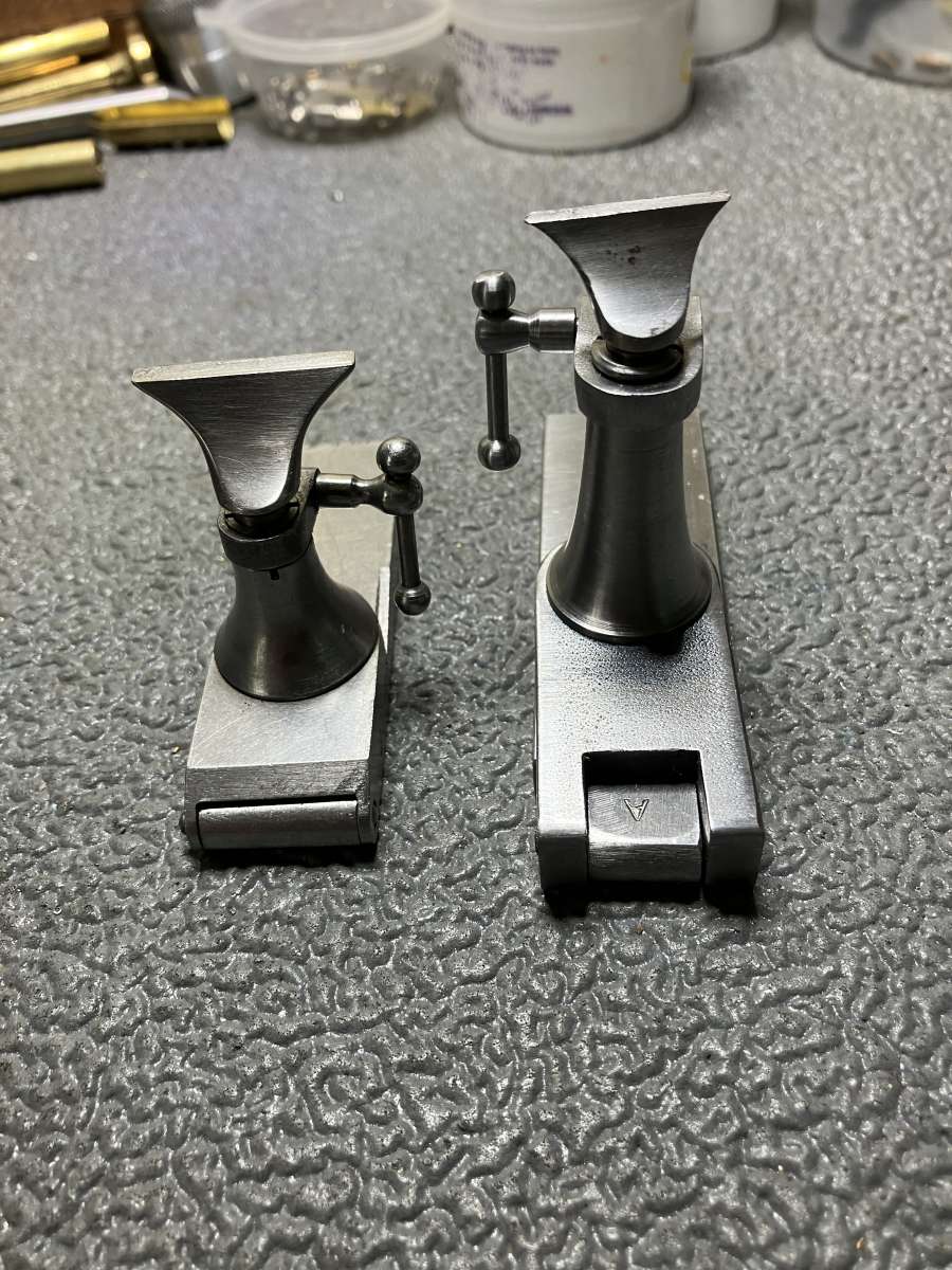

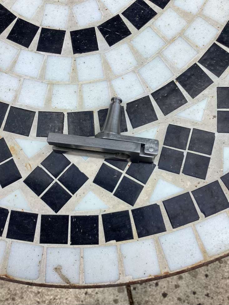

      Dell
        @dell

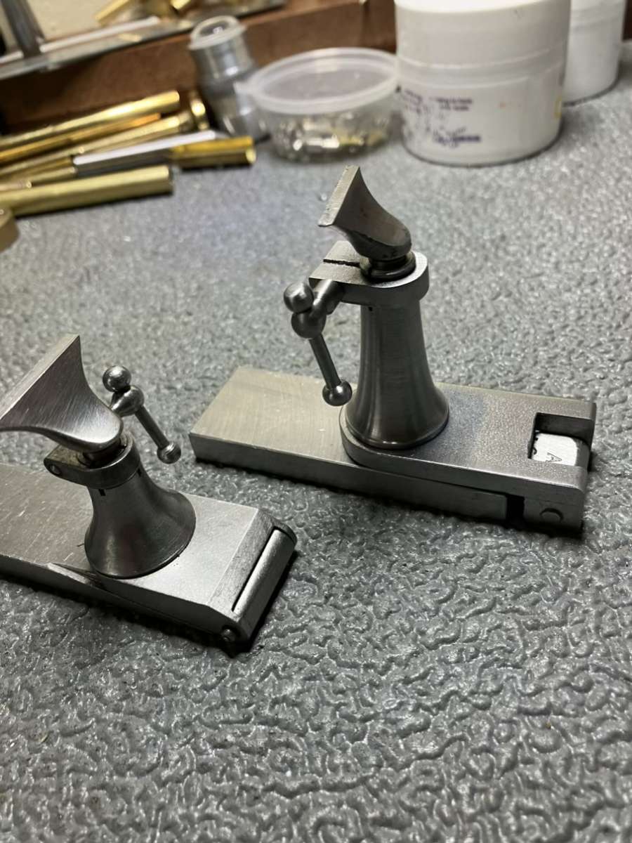

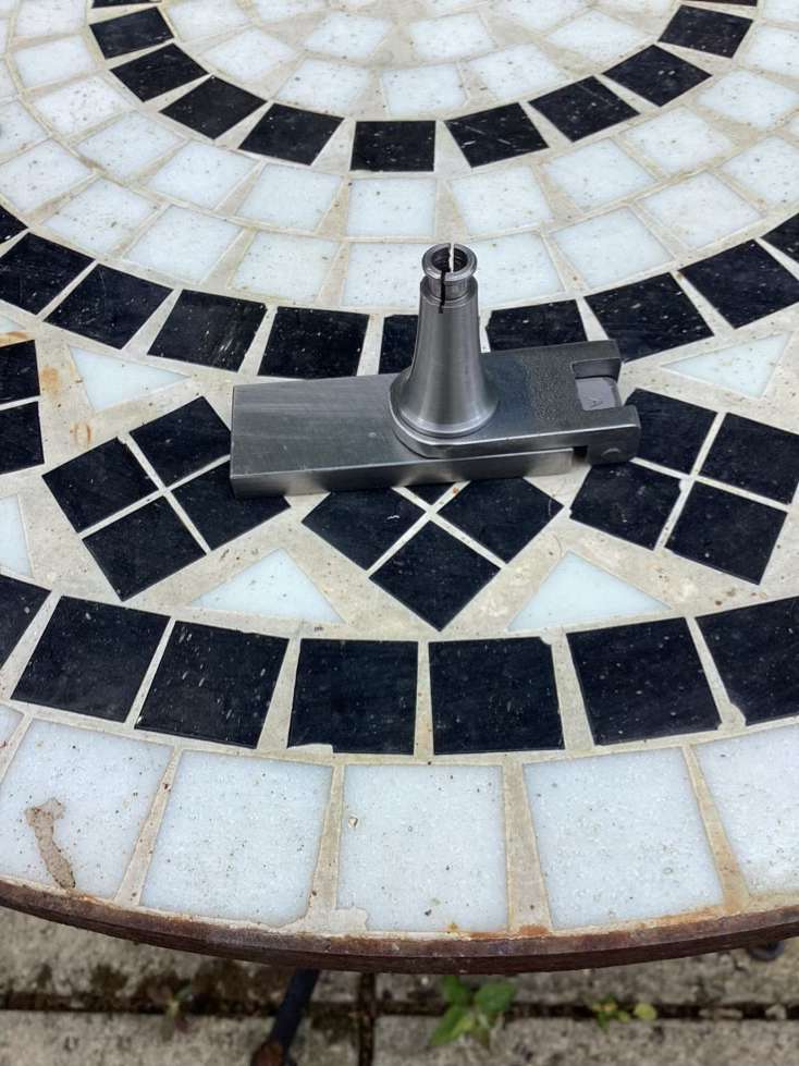

        I made a taller copy of my Pultra P type tool rest for my recently purchased Pultra 17/70,I used an original base to save me having to mill a T slot but everything else is shop made including the flip over part, not a perfect copy but close enough for me.IMG_3856-compressedIMG_3857-compressedIMG_0294-compressedIMG_0293
        #800897
        Diogenes
          @diogenes
          Looks like you had a very satisfactory outcome there, Dell.

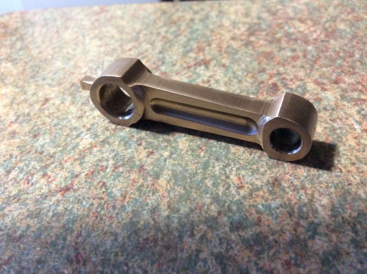

          bernard towers
            @bernardtowers37738

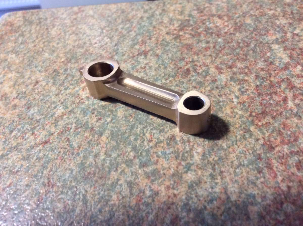

            IMG_3904whippet con rod finished tonight lots of little set ups with very little machining and seems to fit the crank ok, time will tell!IMG_3903

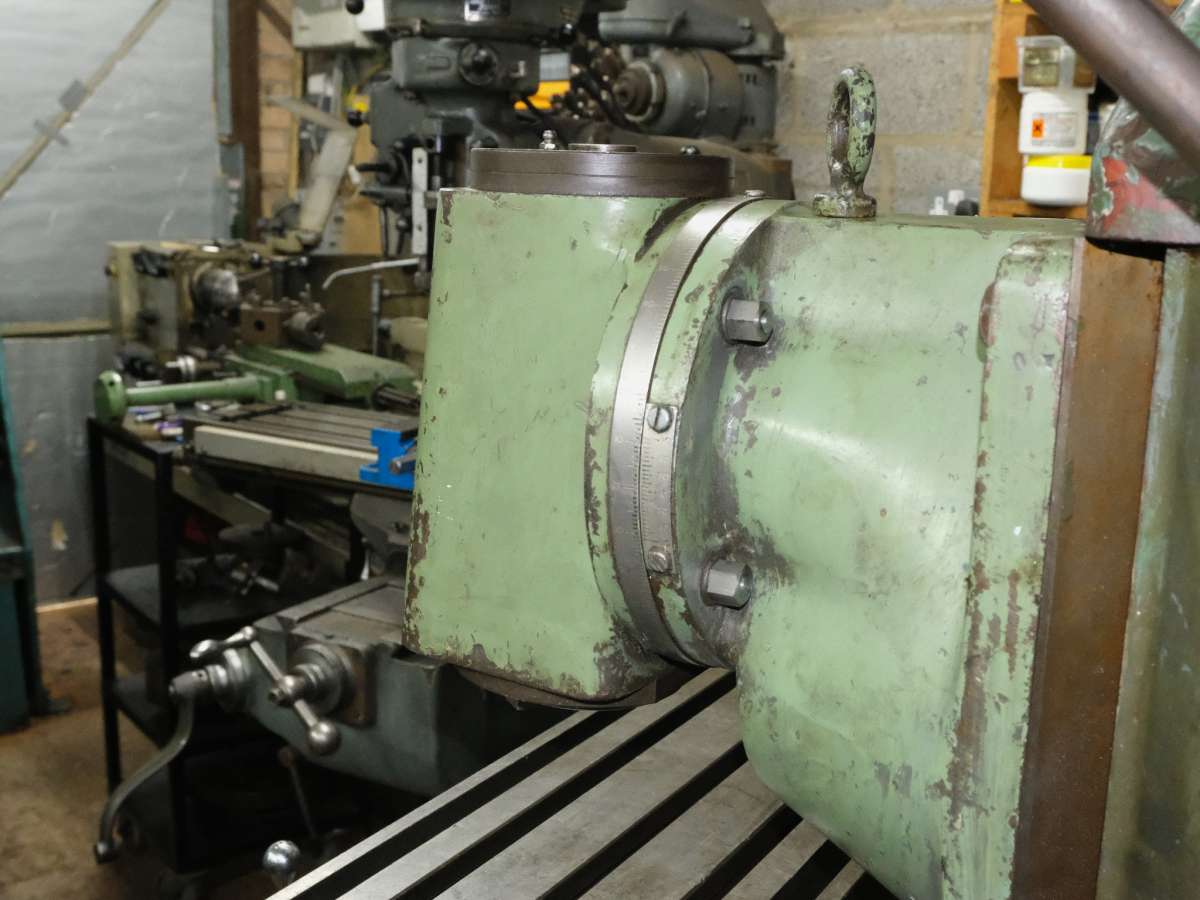

                When machining a part recently that required the vertical head on the horizontal mill to be tilted one of the T-bolt clamps broke. Having finished the machining I decided to take the head apart and look at the T-bolts. The result was one T-bolt broken, one T-bolt that has been brazed and two ordinary bolts. Plus two nuts 1/2″ long and two standard nuts. Clearly I am not the first to have had problems!

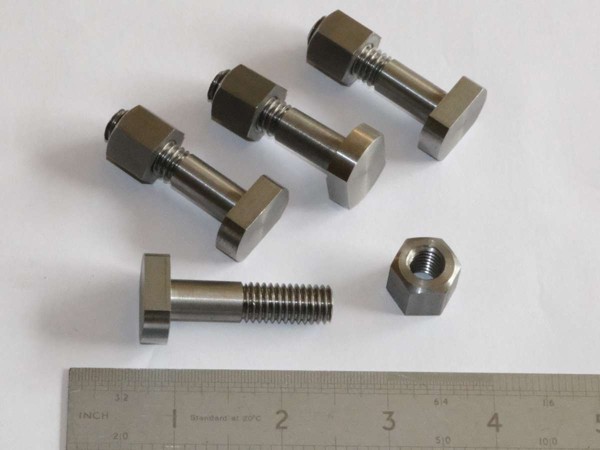

                I decided to make a complete new set of T-bolts:
                T-Bolts and Nuts
                The nuts are made from 0.6″ AF hex EN1A and the bolts from EN16T as I had it in stock. The thread is 3/8″ BSW and the threads are screwcut. Everything back to together and working:

                Diogenes
                  @diogenes
                  Nice clean work – looks like if one isn’t careful with the choice of spanner it’d be easy for the ring to ‘cam-over’ the bolt shanks and put considerable sideways thrust on it – awkward..

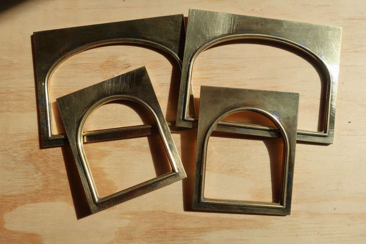

                  Diogenes
                    @diogenes

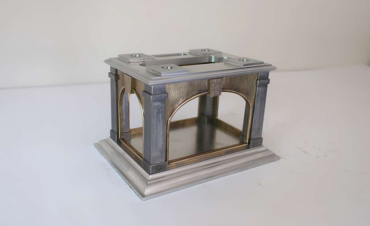

                    Soldered the beads into the panels – still have ‘keystones’ to do but need to order some stock for that..

                    Julie Ann
                      @julieann
                      On Diogenes Said:
                      ….looks like if one isn’t careful with the choice of spanner it’d be easy for the ring to ‘cam-over’ the bolt shanks and put considerable sideways thrust on it – awkward..
                      Got it in one; access is poor for nuts that will be used frequently! I suspect that is why the bolt broke in the first place. I’ve ordered a 3/8″ BSW spanner that should be better than the adjustable I’ve been using.

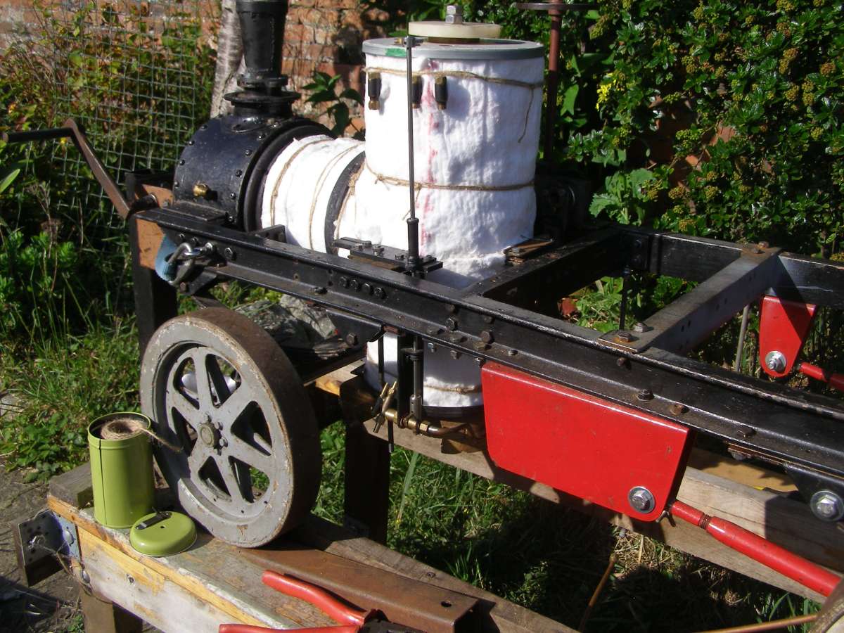

                      Nigel Graham 2
                        @nigelgraham2

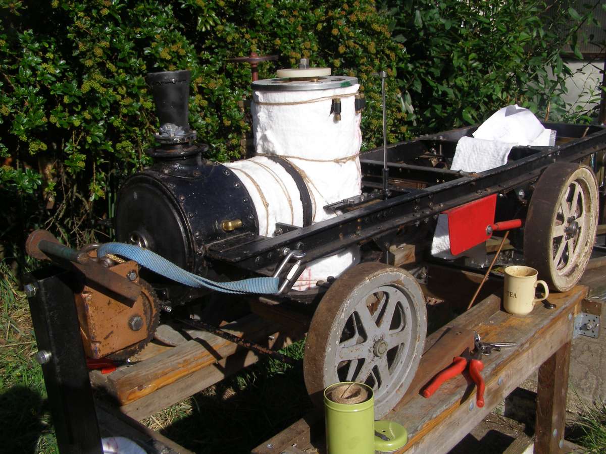

                        Another small step forwards with my steam-wagon.
                        I spent the day lagging the boiler.
                        Boiler Lagging 4 11Jun25
                        Boiler Lagging 3 11Jun25
                        The string is sisal garden twine, more likely to withstand the heat than plastic cord.
                        I am not sure what the matting is, only that I bought it from EKP Supplies. I have not yet obtained the sheet-steel for the covers but the odd shape will necessitate fairly involved developments for them, and practice with cardboard or some old galvanised sheet I have.
                        The two black crinolines on the barrel, one close up to the smokebox, are of thick plywood liberally treated with preservative. How well they will survive remains to be seen… I realised a problem when making them. The smokebox, a slice of standard steel pipe, is significantly larger than the boiler barrel, in fact more than an inch larger diameter than the vertical outer firebox, and this would make the cladding very awkward unless I fit a reducer. This is in the profile of the forward crinoline, but it does not show in the photo.
                        Yes I know the injector is at a very odd angle. I have now set it right!
                        The creamy-coloured disc on top is part of a special boiler-lifting cradle, here used to support the flanged sheet-steel, lower cladding support ring around the bottom of the firebox while that is disconnected from the top cladding cover. Both components are spun, using a chunky bronze (or copper?) bar held in the tool-holder as the pusher.
                        The chassis’ large red plate is a bit preliminary but it or a replacement will become part of the transmission-gear frame.
                        I found an oddity on the front wheels yesterday, only (harrumph, lots of ) years after making them. The hub in one is drilled and tapped to take, eventually, a Stauffer-type grease-cup. The other should be, and isn’t! I have no idea how I managed to miss that, but it cannot now be provided in the same way. It means the plain bearing can be lubricated only by oiling the outsides and hoping some will penetrate the bearing; but I might be able to remove the wheel and drill a diagonal oil-hole.

                          Can you drill the axles and lubricate from the ends?

                          Nigel Graham 2
                            @nigelgraham2
                            I could, though not easily.
                            I had envisaged putting the wheel on the milling-machine and drilling diagonally into the hub itself.
                            However, I looked again more carefully with the vehicle back up on that bench for today’s gripping episode, and to my relief found I had in fact drilled both hubs. Cobwebs and grime had hidden the one I could not find while the wagon was on the shed floor!
                            I’ve still to make the grease-cups, but I squirted some oil down the holes.
                            I may, longer-term, make new stub-axles and bushes anyway. They are a bit shaky, and also I think making them quarter of an inch longer will slightly but usefully reduce the rather large turning-circle at some cost of heavier steering.
                            Right, that’s the lost hole found. Now, what the hell have I done with one of the wagon’s two crew seats? How do you lose a 6 X 5 X 4 inches wooden box, painted in light grey primer? And the blast-pipe connection. That might in said box, with its hinged lid.

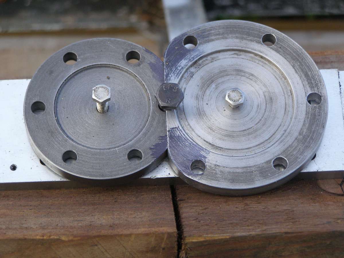

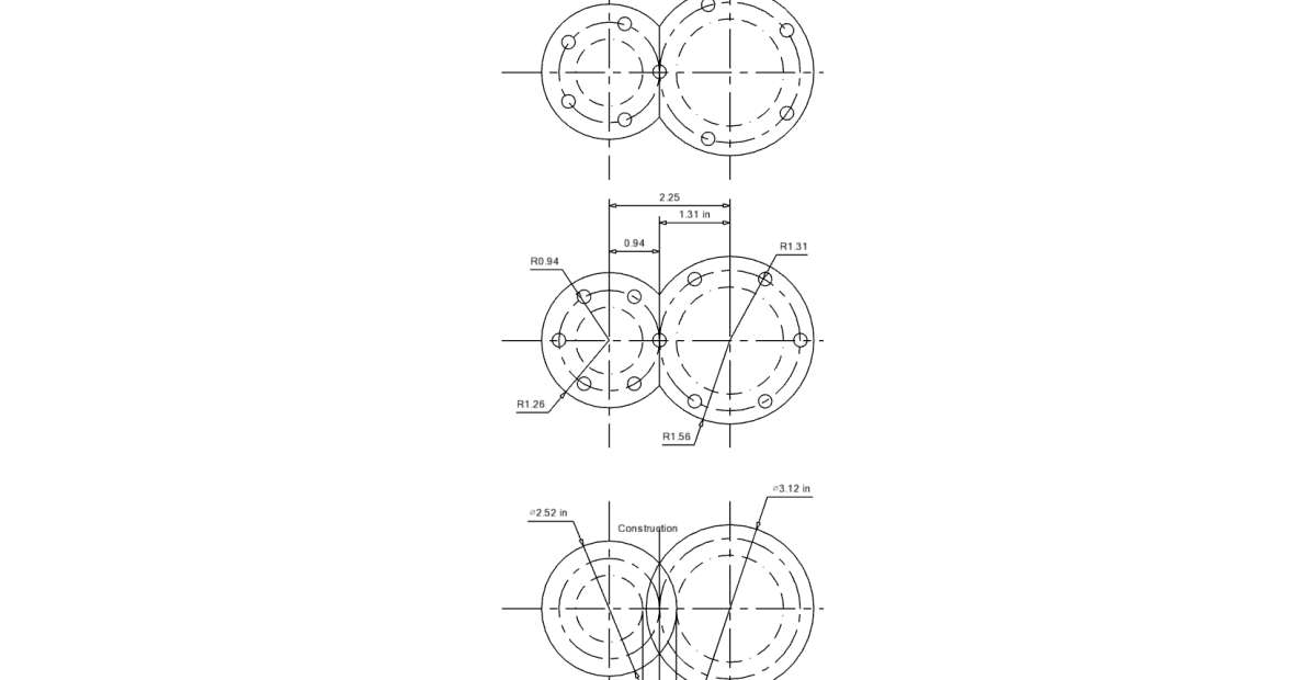

                                                Today’s Fun-&-Games…..
                                                Completed the top cylinder covers for the wagon’s vertical engine. Though I will make it a twin simple-expansion unit the original was compound, as general consensus was that wet steam from a 90psi boiler and compounding don’t work. However, I set out to make the very visible top covers pretend to be on a compound…
                                                How to ensure the flat aligns with the hole pattern? Place a pin through each hole adjacent to the one to be sectioned, and press those down to the top of an angle-plate while clamping the disc to the vertical face. Then use a slitting-saw to cut the segment away.
                                                Only…….
                                                Cyl covers -Top - 18 Jun 25 B
                                                Oh dear! Spot the error, only partly alleviated by two blend radii.
                                                All those hours trying to juggle outside diameters, hexagon-circumscribing circles and pitch circles to achieve a close match meeting around a central shared stud while maintaining the pretence, then when finished the centres were 3/16″ too far apart!
                                                They should have looked like this Alibre plan view (the 6-stud variant):
                                                Cylinder Covers 5 and 6 stud
                                                I don’t know where I went wrong – in setting the pitch-circle drilling, probably, because that then affected the segments. I worked out a work-round during the dinner-break and spent the afternoon modifying them by jig-borer, milling-machine and shaper until they fitted the test-jig to which they are screwed as the photo shows. The radius marking out is still visible: I scribed round a large washer. I drilled and tapped the jig on the mill, using the DRO, but it is a scrap machine part consisting of an accurately machined aluminium-angle.
                                                One is not happy, one isn’t, but I will have to use them for now. It is not clear from the original Hindley photograph but I think they were really a sort of ‘D’-shape. I don’t even know if the whole vehicle will work yet so correcting cosmetic cock-ups can wait. This is partly why I am taking so long to build the thing – I’ve probably modified or remade half of it by now.

                                                  #803530

                                                    As for your covers did you leave the slitting saw at the same height when you cut the second one? Should have been adjusted for each. Will they actually work as it looks like you have mooved the cylinder ctr distance closer together so will end up with a gap when on th enegine?

                                                    Nigel Graham 2
                                                      @nigelgraham2
                                                      Diogenes
                                                      No it isn’t when the centres are already set by the finished, one-piece crankshaft!
                                                      Jason
                                                      Ooh – I didn’t spot the sick-squid one! I did look at Blackagtes and others, including Chronos, but it is odd that the suppliers of gauge-glasses don’t also supply cutters for them.
                                                      I set the cutter height for each cover itself; by raising the table so a pin in the hole just touched the underside of the saw, then by 1/8″. Theoretically the depth down from the rim should have worked but the pitch-circle is the more significant datum for the segment.
                                                      I have not yet measured the covers to find the mistakes. The smaller one was pretty well correct though I still shaved a tiny bit off it despite that making the mismatch worse. The drawing above is correct: I verified the centres by measuring the crankshaft. There is little room between the two cylinders for a 1/4″ (or even M6) stud so that point is quite critical.
                                                      I think a 1:1 scale drawing in Alibre will print accurately to size on my system so I will try making a paper template to test against the covers and the jig.
                                                      The error might be from as stupid as not using the drawing to set the stud holes, then an accumulation of small errors. I remembered the studs are 1.125″ from the centre on the smaller disc, and nominally 0.5″ from the rim, but may have mis-read the dial when setting the jig-borer. An error of 0.187 – ish” is a big error though.
                                                      As made the covers will work but the mismatch looks ‘orrible. The archive photo is not very clear but the originals looked two separate ones of a rather odd shape, with a deep surface pocket that would be awkward to replicate, so what I intended is a bit of a compromise but still reflects contemporary practice.
                                                      I have bought a new blank for the cylinders and today’s beautiful thoughts may be starting on that – but with a drawing and crankshaft to hand!
                                                      Since the crankshaft, matching the first (compound) cylinder block, exists and designed long ago, that dictates the “works” above it.
