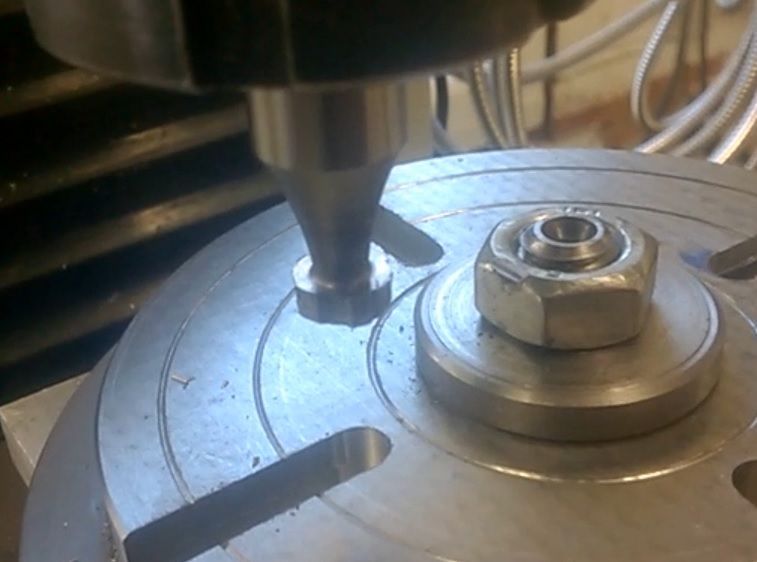

            Been at a bit of a loose end these last few days so I spent some time at the computer thinking up another piece of workshop tooling. This is a low-profile rotary table with a one degree rotational restraint system based on the simple indexer tool described in my album and in MEW 297/298. Here's a screengrab of the work so far. For scale, the height from bottom of the base to top of the table is 26mm, the table itself is 100mm diameter and the base is 130mm square, tee slots are just 6mm wide, so it's aimed at mini-mill users. There are a couple of refinements to add – like a table locking device and adding fasteners etc. I originally intended to add a simple form of adjustable jaws to fit in the tee slots but decided that, at least for the time being, I'd stick with clamps. It is only designed for use with very small components after all. You never know, I may even get around to making one now that we are going into COVID tier 3 on Saturday.
            Vernier table

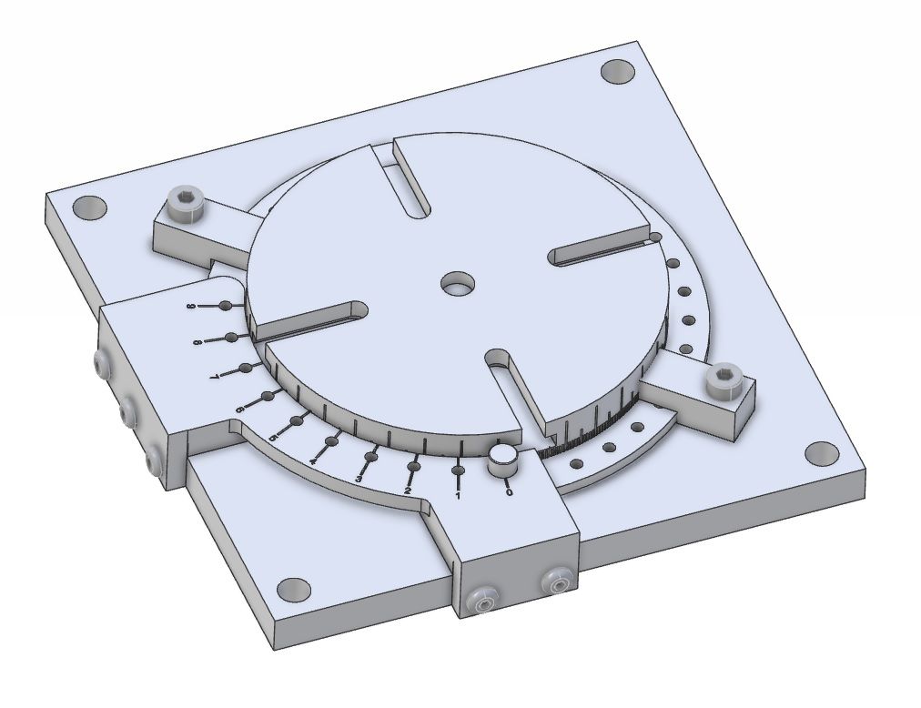

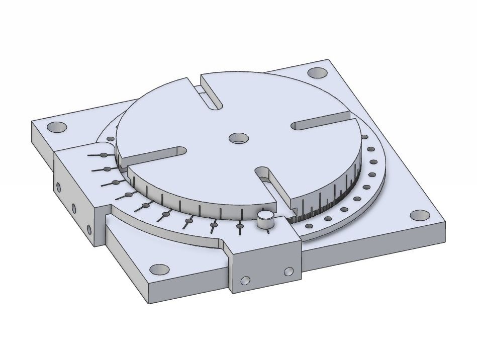

              Loose ends tied up, so finished the rotab design:
              Completed design
              The base ended up 130mm square to accommodate the locking clamps , otherwise it's substantially as it looked in my head. All designed 'on the fly' in Alibre Atom3D. Time to break out the metal catalogue!

                It would be good to see that when finished. yes

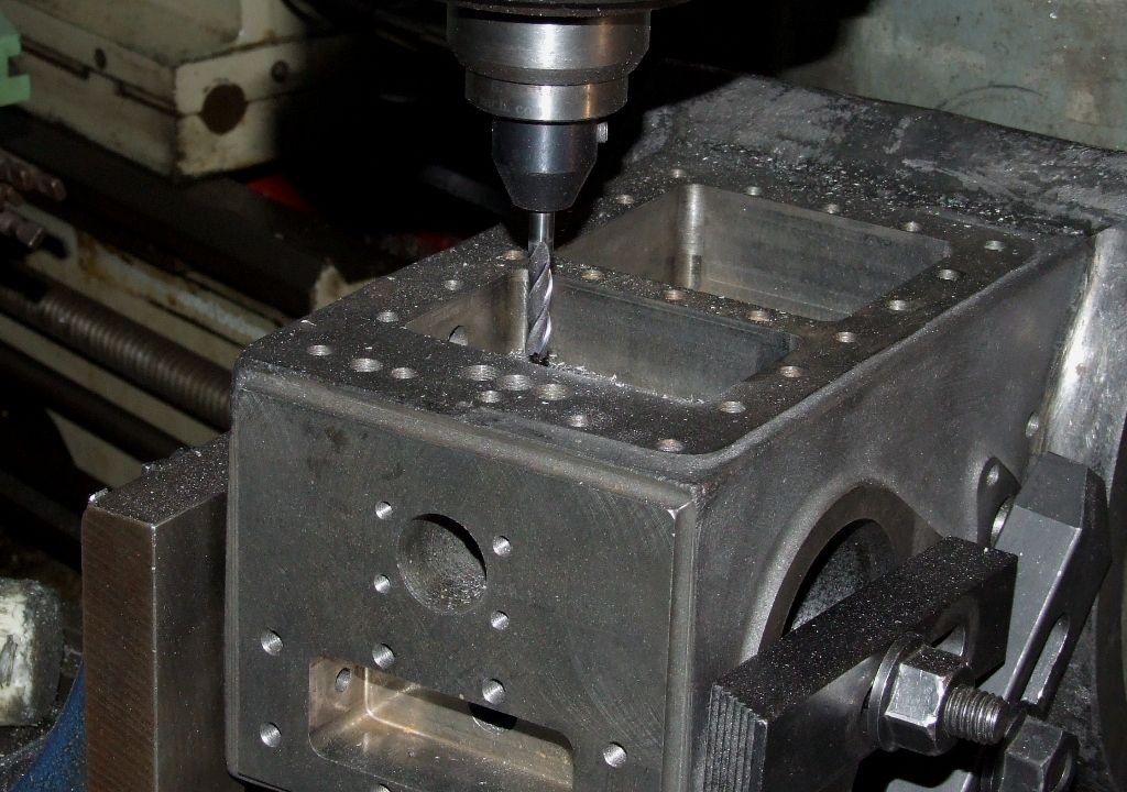

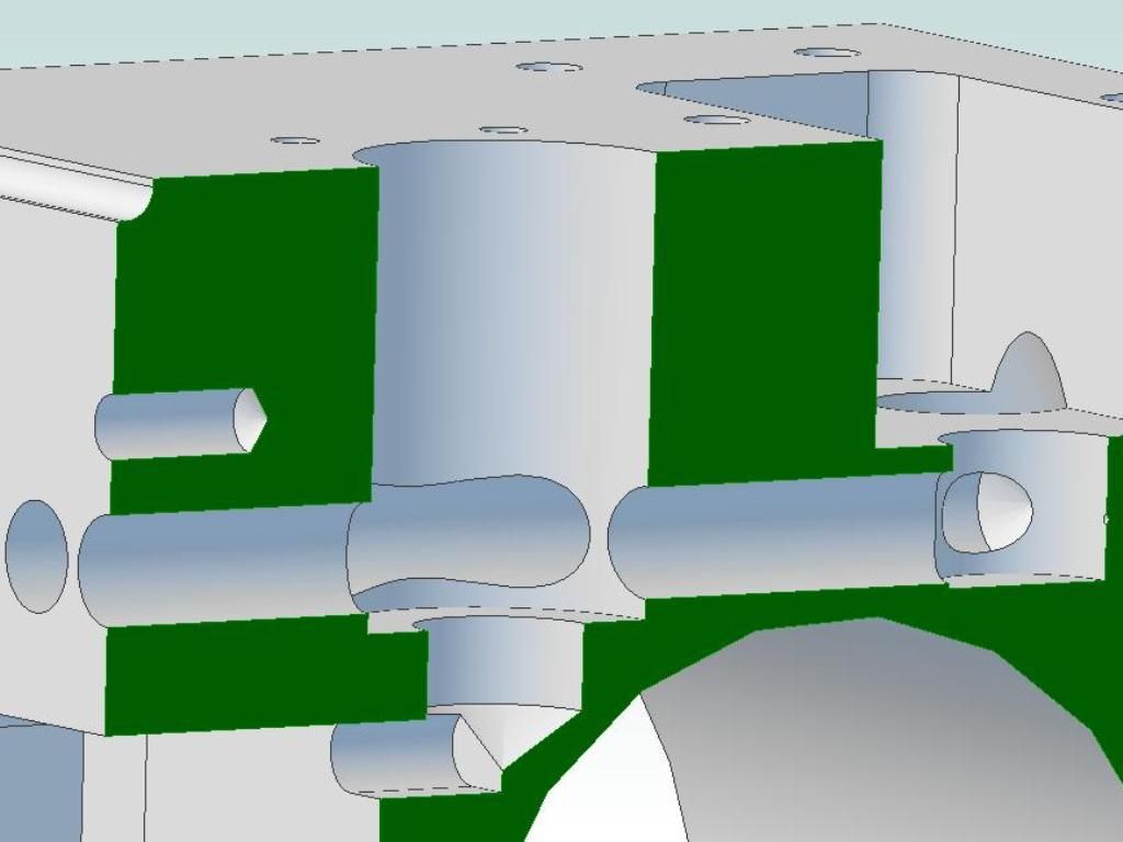

                      Over the last couple of nights I've been machining the hole for the balanced valve and body, and one of the steam passages into the HP valve chest, for the governor on my cylinder blocks. The result isn't easy to photograph and it's just a hole! So a section of my 3D CAD model of the cylinder might be more informative:
                      It's not a disaster if the hole breaks into the HP cylinder bore as a thick liner will be fitted. But it's a case of satisfaction if it doesn't. The large 1" hole was machined with a slot drill, usaing the knee rather than the quill to set the precise depth:
                      The oblong slot from the bottom of the balanced valve to the HP valve chest was drilled 6mm at each end. The middle was then "drilled" using a 6mm slot drill with a fair amount of stick out:
                      Finally the slot was cleaned up by machining from side to side with a step down of 1mm. Machining the slot is not as bad as it looks. The first 1" is fresh air and once engaged the cutter is contrained on two sides.
                      Eventually there will be two drilled passages from the HP valve chest to the top of the balanced valve, but they will be done after the valve body is finally fitted.
                      Andrew

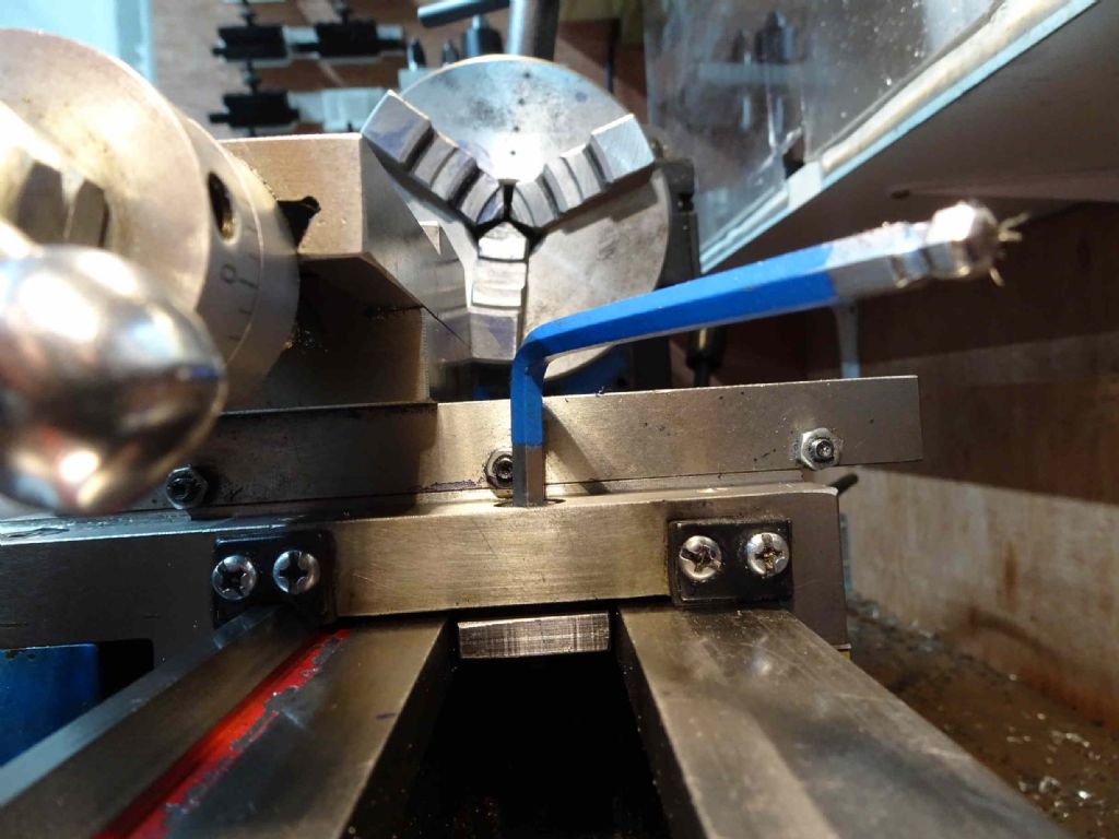

                        I've been a bit quiet the least few weeks as a bathroom refurbishment interrupted play. AS usual with these things, you peel a layer back and find more problems and so it goes.
                        However, in the background I've been making a saddle clamp for my mini lathe. This, in some ways was an act of desperation. Desperation for parting off (a common whine!).
                        Some considerable time back, I got a decent QCTP from Arc and the first few partings off of steel went really well (by my standards). Not much digging in, swarf not dust coming off and I was delighted.
                        However, either over time or at some point, this all seemed to stop working. parting off, grooving, treppaning could only be done with the utmost delicacy or very nasty things happened.
                        One of the you tubes I watched recently talked about saddle clamps, so I thought I'd have a go. I'd already made a topslide clamp which had no effect on the parting off at all.
                        As part of the process, I had a look at the saddle and put an indicator on it there was well over a thou of movement up and down, which I thought was a bit much. I then nipped up the nuts which grip the saddle to the underside of the bed and got to the point where the movement was something like 8 microns. I had to stop that that point (as if I could do better) as, although the movement was smooth towards the chuck, in the last part towards the tailstock it was very stiff. I'm assuming that there is just a bit of wear in the area where I've been cutting.
                        Anyway I found that interesting.

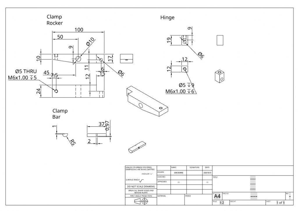

                        Here's a drawing of the clamp.
                        The hinge is bolted under the front of the saddle and a 6mm pin (not shown) hinges the Clamp rocker. Half way along a half round bar sticks through and when the screw at the back of the saddle is tightened it brings it up to clamp under the ways. The idea is to ensure the clamping force is central rather than at the rear end only which I've seen on some designs.
                        I actually only trimmed the ends of the Clamp Bar, which gave a better bearing for the bar and also prevented the bar from wandering out of the Clamp Rocker.

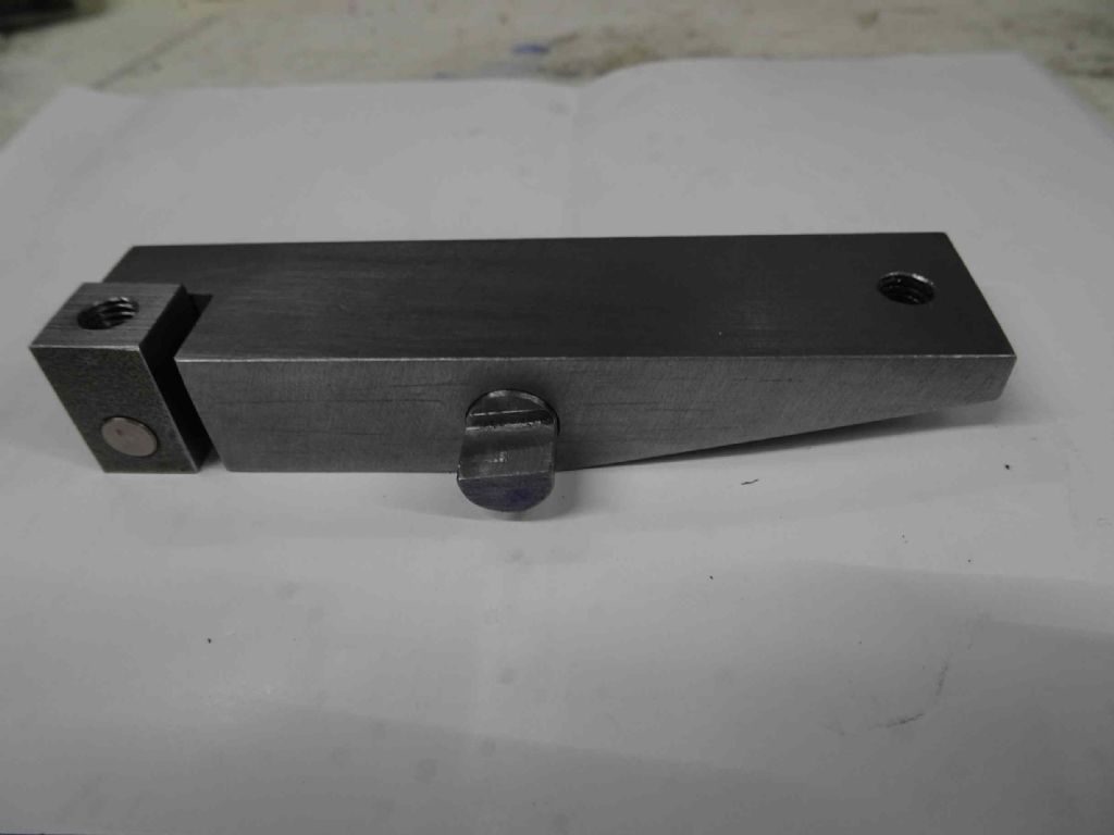

                        Here's the part

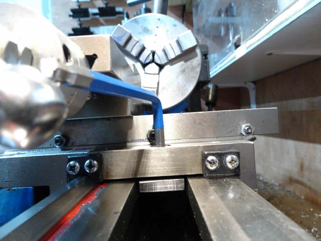

                        And here it is on the saddle with the clamp off
                        and less than a quarter turn later, no.
                        The socket head bolts at the front and back are counterbored to keep out of the way of the saddle mechanism (in the above image specifically the jib screws).
                        I did some sums and thought that I only needed a few thou to accommodate the forward and back movement of the clamp rocker as it raised and lowered. However, between possibly bad maths and imprecise location, I ended up with this end overbored (6.5 rather than 6 and 11.5 rather than 10.5 for the counterbore) to accommodate some movement.
                        I've not yet tried it out. I wanted to quite whilst I was ahead tonight. Also I will never know if the improvement was due to tightening the saddle or the clamp – though I suppose I could try without it first..
                        Iain

                              Belatedly I have looked moe closely at Ian's clamp above and eventually understood how it fits. Rather neat so myight look at how it could work on a Drummond. Thanks for the posting.

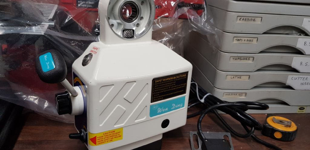

                                      This arrived today so lots of bushings to make / alter to make it fit. It is a x axis drive for a Bridgeport. Going on the little Tom Senior as a Z drive.
                                      Steve.

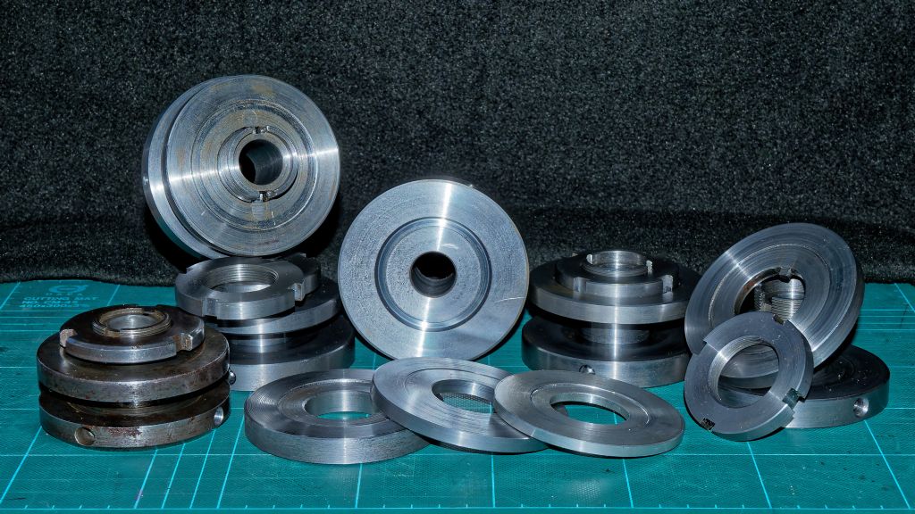

                                          Finally got round to completing another 5 arbors to hold pre-balanced grinding wheels for the Herbert.
                                          All essentially copies of the original at lower left.
                                          Four with 1 ¼" (31.75mm) cores and one with 32mm to suit a diamond wheel I have.
                                          22tpi Left Hand thread on the 2" slotted nuts, screwcut in the lathe. The main body is a shade over 3" diameter.
                                          I should work faster, they're already starting to show signs of rust before I've even mounted any wheels.
                                          pb10269Herbert Junior Wheel Arbors

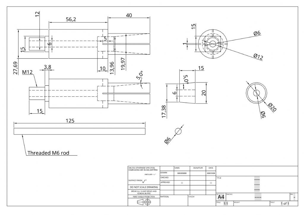

                                            A while ago I had a go at building a spindle handle / mandrel based in some ideas in Neil's excellent book.
                                            It was a failure (I blame the workman, by the way Mr Editor, not the writer!).
                                            So I thought I'd have another go. This was the basic idea. I think that the first attempt may have failed because the angle of the plug was too steep (and the machining probably too rough).
                                            The main challenge with this was cutting the slots and the square on the other end.
                                            To accomplish this, I build a little block which I could clamp the bar in and then set it up on my saw table (and later the mill). the picture below is entirely posed because I didn't have a camera when I did the real work.
                                            The scrap just in front of the blade are some bits superglued together to provide some support for the work – or it would go all over the place!.

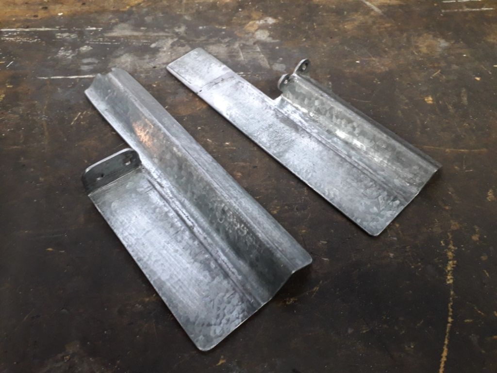

                                                      I've been going to make some slide covers for a while, the original plan was to machine them from ali but I came across some up and over door runners and harvested enough 2mm thick lengths to make these…
                                                      I quite enjoy a bit of tin bashing on occasion and these went quite well, I fitted them on top of the existing slide wipers and they looked like this:
                                                      I need something to stick along the edge end, I'll experiment with some rubber or a length of split tube to finish them off.
