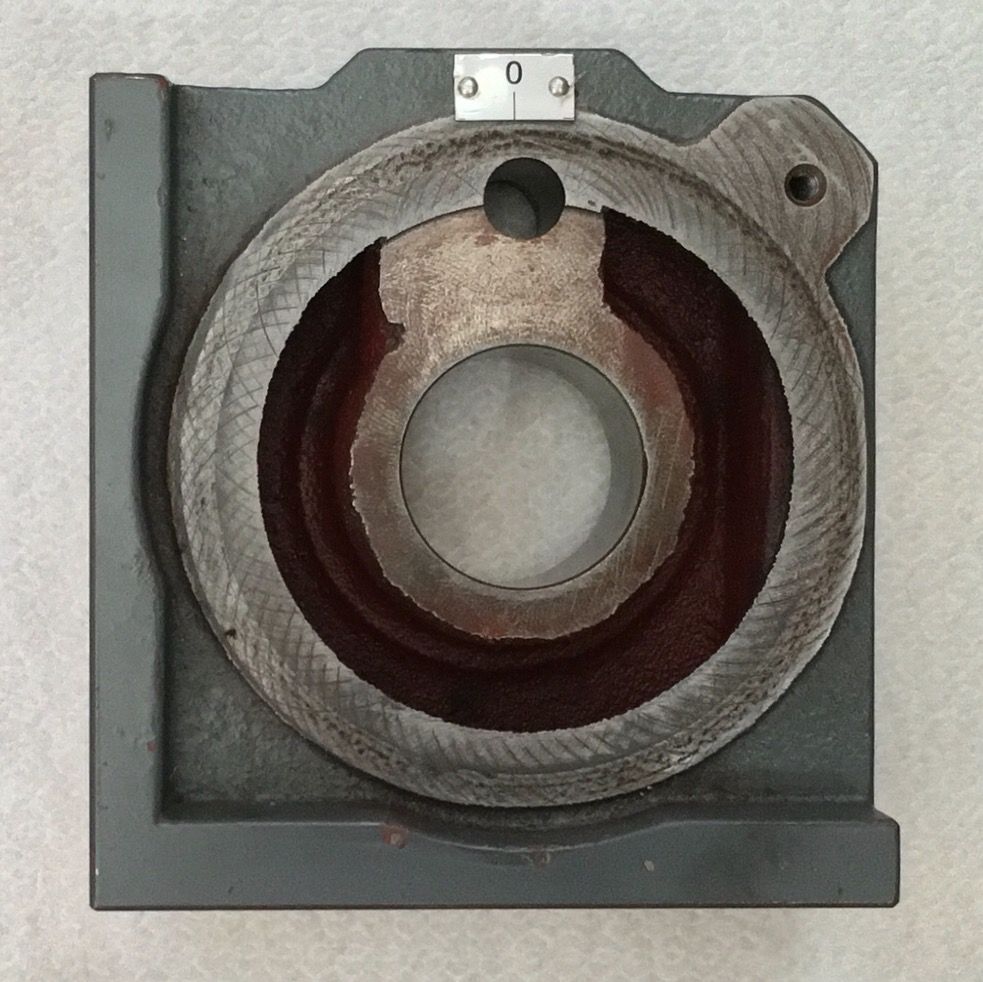

      This is where you learn the difference between a cheap Allen key and the others. It helps if the Allen screws are good quality too, unfortunately, there are poor examples of both, either of which will make you wish you were doing anything, absolutely anything else. Daveb.

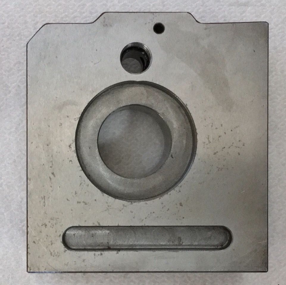

        Here you go, Ian
        Should be self-explanatory, I think …

          It looks like the early bird got the worm!
          (I'll get me coat.)
            < groan > smiley
            Yes, it's a 'Rapid Indexer'

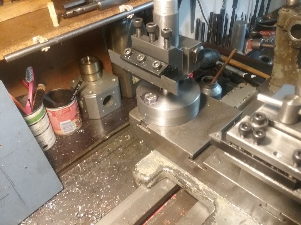

                      Mick20180830_121242.jpgFinished my rear toolpost, gave it a trial all well no hiccups, some tidying up to do and gine cutter a sharpen, tried it on some aluminium bronze and steel20180830_114221.jpg
                      #369719
                      Mick Henshall
                        @mickhenshall99321
                        And pic I missed

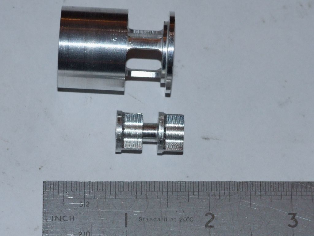

                                      Weeded one half of the drive early this morning. sad
                                      Then I made a balanced valve and body in aluminium as test pieces for the traction engine governor:
                                      The balanced valve was a mix of manual turning and CNC milling. The valve body was all manual turning and milling. I learnt a few things about making the balanced valve which I will carry forward when I make the final items in bronze.

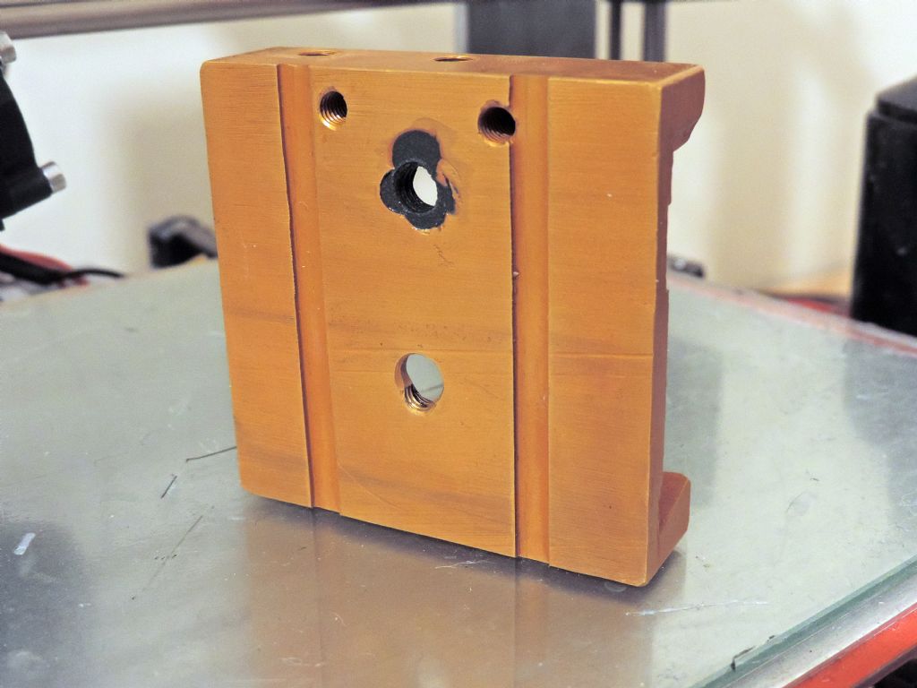

                                                      I tried my first experiment with anodising today.
                                                      Just a rough-finished block that I had knocked up as a temporary telescope dovetail clamp, as it was the right size. Don't judge the workmanship!
                                                      The result was a very impressive colour, although I had to microwave the (industrial) dye to get it to work and yes it faithfully kept all the original machining marks. I can run a hardened steel screwdriver ove the finish with light pressure and it doesn't mark it, which is good.
                                                      More noticeable was where I had filled some wrongly placed holes with Alutite – they went black in the caustic soda, didn't anodise and didn't take any die. They look like JB Weld but aren't!
                                                      Tomorrow I will try a couple of 'proper' parts.
