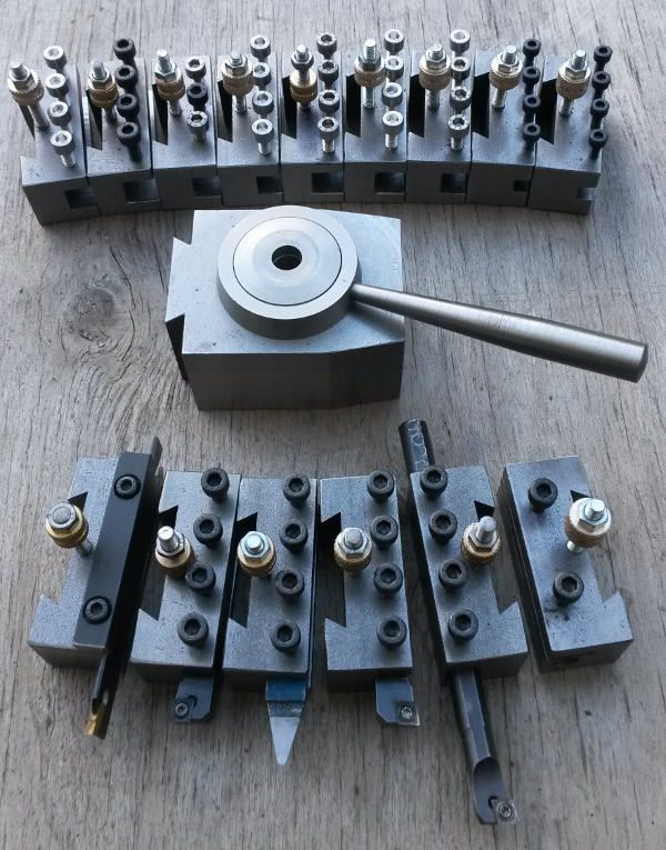

        #367556
          Posted by Limpet on 15/08/2018 20:12:50:
          Ok I've only finished it all today but it is also my first proper project in metal. The main question is have I made enough?qctoolposts.jpg
          An excellent collection!
          You can never make enough!
          I'm trying to work up the courage to make another batch. I might use a tough aluminium alloy like one of the 7000 series if I can find it at a reasonable price, as much to speed it up as save my cutters!
          Edited By Neil Wyatt on 15/08/2018 21:47:27
          #367560
          Simon Collier
            @simoncollier74340
            You need n+1 tool holders.

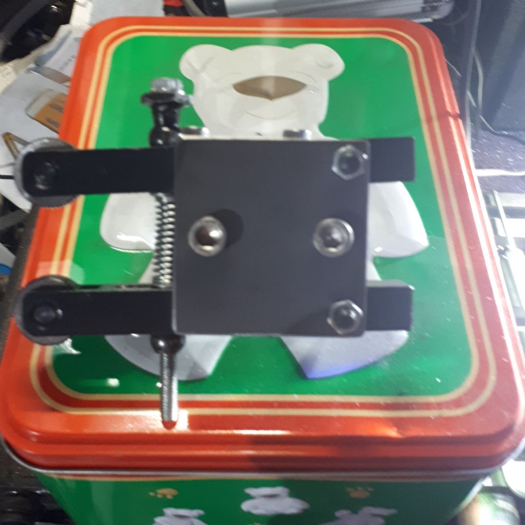

            #367563
            Michael Horner
              @michaelhorner54327
              Made a straight knurler along the lines of Vics' design. Slipped up with the lower pivot and have now corrected the oversight. Need to finish of the top. Maybe put a big knurled knob on it!
              #367570
              Hopper
                @hopper
                Posted by Simon Collier on 15/08/2018 22:03:32:
                No, you only need two. The one on the lathe that you just finished using and the one you can't find anywhere.
                #367576
                Limpet
                  @limpet
                  Posted by Hopper on 16/08/2018 03:41:54:
                  It's funny you say that as I milled the dovetail in 16 and haven't seen the last one since – must be the Devon pixie liked it.
                  #367577
                  thaiguzzi
                    @thaiguzzi
                    Very nice.
                    Answer – no, never enough for some reason.
                    #367712
                    Limpet
                      @limpet
                      Thaiguzzi, I think yours are a bit more involved than mine and look very nice. My next challenge is either a spherical turning tool or a knurling tool for the toolpost (well they will be challenges for me)

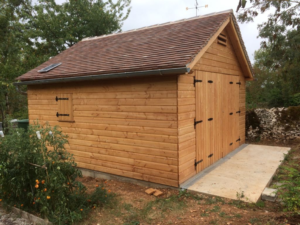

                            #367781
                            Speedy Builder5
                              @speedybuilder5
                              Like most of us, it was today that I finished the garage. 20 Square meters on a 4" re-inforced concrete base. Total cost including a pumped concrete ready mix base 6,000 pounds. Garage made from 28mm Douglas fir weatherboard supported by 4" x 2" framework with a clay tiled roof.

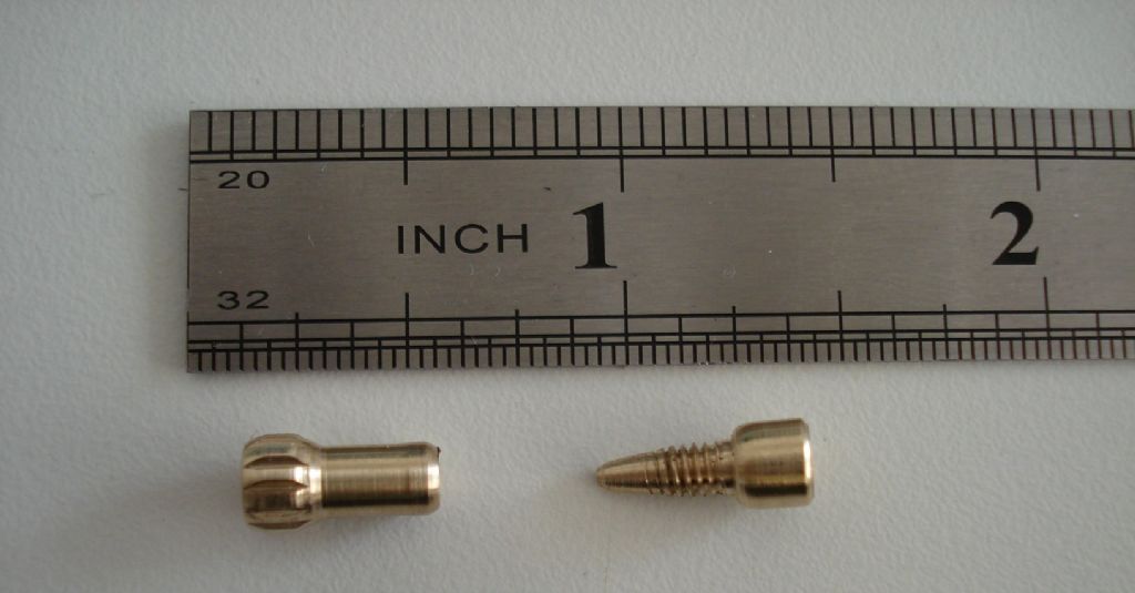

                                              #367962

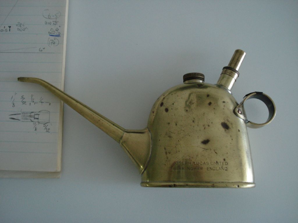

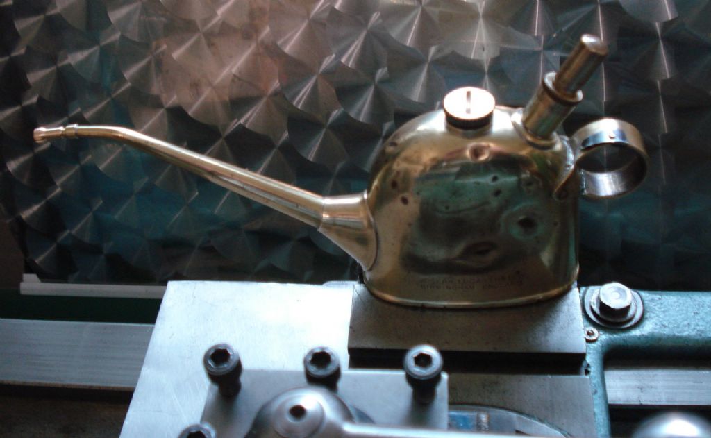

                                              Richard S2
                                                @richards2
                                                Finished repairing an oil can I was given the other day. Thick with oily dust, leaks and broken off spout tip initially. Been looking for a decent one prior to this, but will be fine for my needs-
                                                I.D'd the thread form as 1/8" Whitworth, so made a new tip and cap for it-
                                                1920s Lucas no 40 1/4 pint Oiler now working perfectly with original leather washers and will be lubricating the old Myford. Only cost was a few hours of my time-

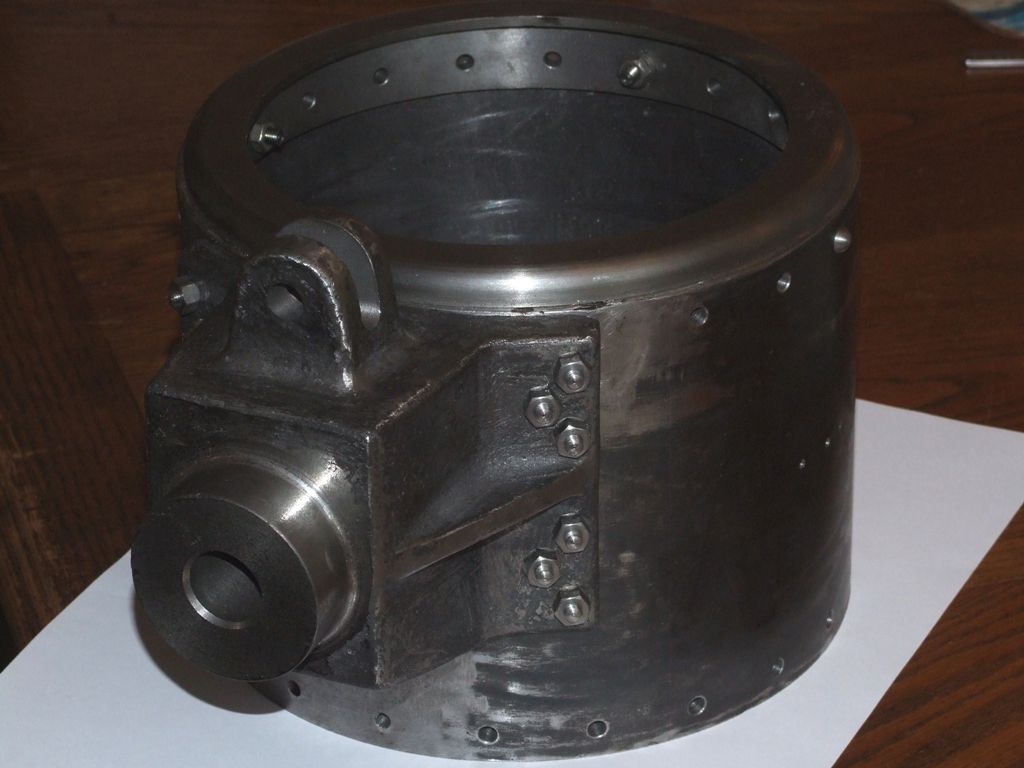

                                                Anonymous
                                                  Yesterday I fitted the perch brackets to the smokebox on my traction engines:
                                                  The casting thickness varies, so each homemade stud (1/4" BSF) was individually fitted so the same number of threads show on each one. Can anyone spot the "deliberate" mistake?
                                                  I thought I'd bought a 1/4" BSF die but couldn't find it. So I ended up using an old split die stamped AM (Air Ministry) and 1940. That would have been about the time my father started his apprenticeship at RAE Farnborough. Nuf sed.
                                                  Andrew
                                                  #367985
                                                    Posted by Andrew Johnston on 19/08/2018 09:10:28:
                                                    Two guesses … probably both wrong:
                                                    1. The upper and lower groups of three [as pictured] look to be differently arranged
                                                    2. You have not yet made the special washers, to get all the hexagons neatly aligned
                                                    Lovely job, whatever !!

                                                    #367990
                                                    Anonymous
                                                      Posted by Michael Gilligan on 19/08/2018 09:27:33:
                                                      The arrangement of the upper and lower groups of three are different as the web is not symmetric, so the upper group have to be closer together. However, you are in the correct area. Look more closely at the symmetry of the lower group of three.
