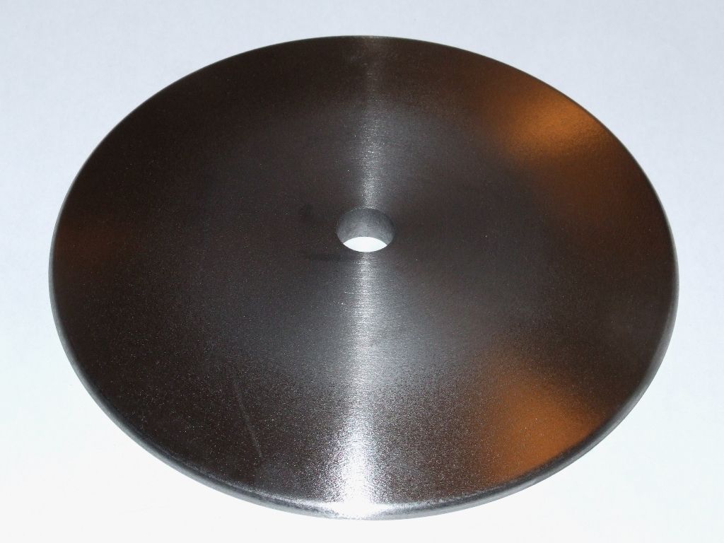

      Posted by Andrew Johnston on 09/08/2018 19:07:37:
      Machined the second smokebox door last night. I got a better finish than on the first one, simply by reversing the feed direction from inside to outside to outside to inside:
      If I'd thought about it that gives a rather better cutting geometry for the tool with less chance of interference, especially near the centre.
      Andrew
      Was the door a casting or a solid disk of steel.

        Posted by S.D.L. on 11/08/2018 16:20:19:
        Steve
        It was a casting. Initially I boo-boo'd and bought the smokebox castings from my nornal supplier. Don't know why I did that as they were light alloy. I bought more castings from Live Steam Models as theirs are cast iron. I live in hope of money back, or at least a credit note, for the original castings; plus a few others I will never use.

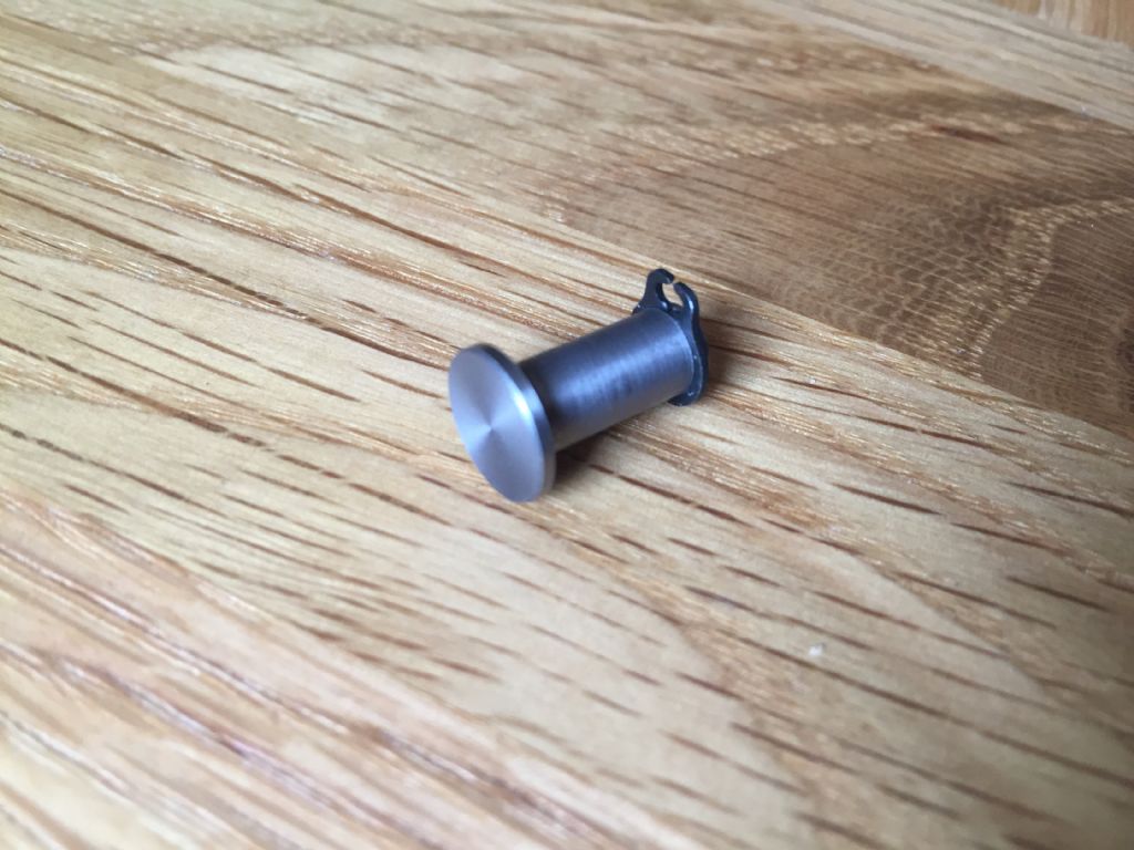

              A start on the clevis pins, this one with a circling slot the correct depth, not like the easy fit of the first two I made
                That looks very tidy, Nige
                … Much nicer fit yes

                  Thanks Michael. I was trying a tangential tool that Howard Lewis has loaned me and a new tool height gauge which worked a treat and accounts for the nice finish on the head of the pin. I measured the internal diameter of the circlip and actually turned the slot to the correct depth. I have been practicing making use of the micrometer to measure and then better use of the scales on the lathe to make cuts down to a calculated dimension.

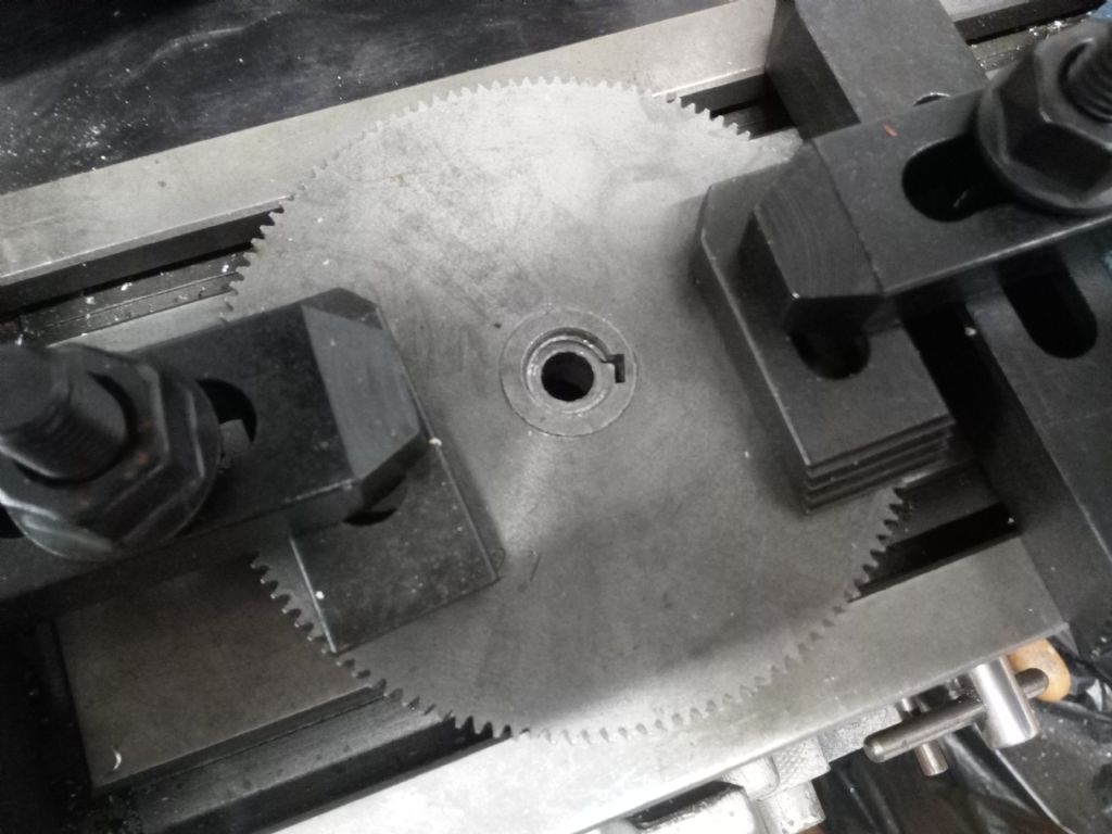

                          img_20180811_154827.jpgI spent several hours fitting my new 127 tooth change gear. First I had to get some good quality steel from my scrap box, turn the outside diameter to match the inside diameter of the new gear. Then drill and bore out the inner diameter to match the outside diameter of the spindle it runs on, then cut out a longtitudnal slot in the new bush for the key. Heat up gear, cool down bush and fit, balah bing.
                          Only to find that I then needed to mill one side of the hub boss off the new gear as it was too wide to fit the spindle as it was (photo to come soon).
                          Happy with all that I went to fit it to the lathe and found that I need to cut out a slot in the motor mount as the drive gear now fouls it, that will get done during the next week, all being well.

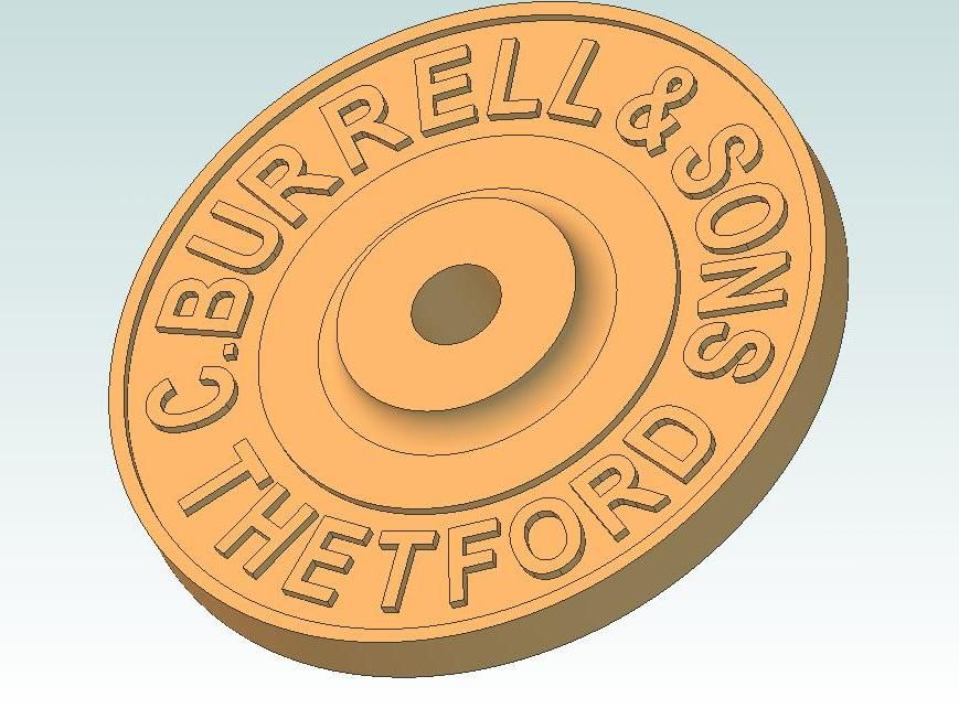

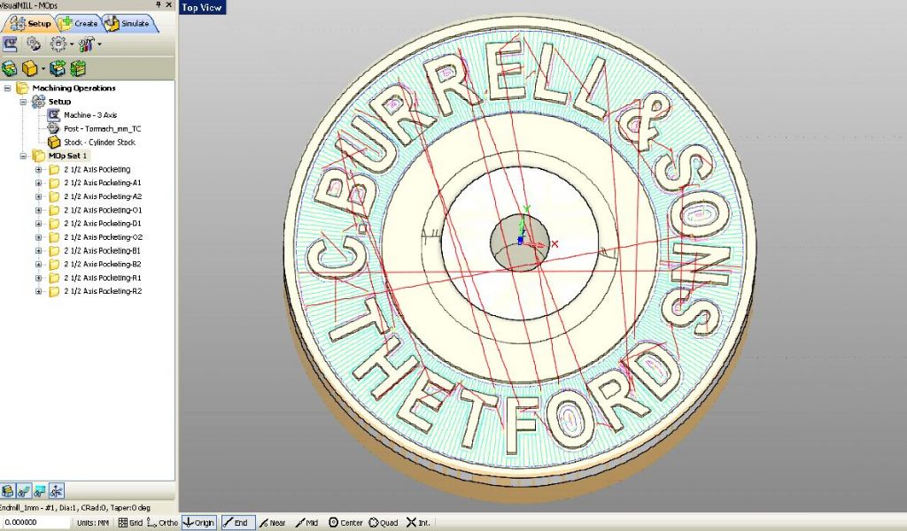

                              My tug pilot duty this afternoon has been cancelled due to the weather, although it hasn't actually rained yet. So I've been playing with CAD and CAM for the inner nameplate on my traction engines. Here's the 3D CAD model:
                              And here is the CAM toolpath:
                              Only one level is shown, in reality several identical step down levels will be needed, or I'll break the cutter. I estimate that with a 1mm endmill at 24000rpm and 350mm/min it should take about 90 minutes. That's fine as I'll only be making two, well three as I'll do a trial run in aluminium, given the cost of 3" diameter gunmetal.
                              Now let jam making commence! I live in hope that this time I won't let the boiling jam overflow, with the resultant sticky mess. smile

                                Andrew,
                                I think you are wise to try out on a bit of ally first. My attempts at this sort of thing with a 1mm cutter were a bit disappointing, the lack of sharp corners, particularly on the "N"s showed up rather badly. My thought was to go around again with a pukka engraving cutter but I really run out of the necessary speed on my little CNC mill.
                                Gòod luck,

                                      Andrew, given the machining time, I'd be tempted to do a run with acrylic rather than aluminium – just reduces the chance of cutter breakage further. I managed to take an hour to cut a 10mm dia pen cap decal with a 0.3mm dia cutter in acrylic, and it didn't break.

                                        Posted by Roderick Jenkins on 12/08/2018 18:05:09:
                                        Fair point. The main purpose of the test piece is to check toolpaths before using expensive material. But I'll definitely take the opportunity to see how it looks. After simulation in the CAM program it doesn't look too bad, but that's not the same as reality. Unless it looks really awful I think I'll go for it. At least I'll be able to say it's me wot made it, instead of buying a casting.

                                          Posted by richardandtracy on 12/08/2018 21:34:06:
                                          The reason for using aluminium is to check toolpaths and that I've got speeds and feeds correct. The final parts will be made in gunmetal come what may. I've made a couple of parts using 1mm cutters with run times over 3 hours; I just go and do something else after initial checks. If the cutter breaks, it breaks the machine won't worry and that's life!
                                              Bother, I knew there was something else I was going to mention last time around. The above is my experience with engraving cutters as well. Some years ago I spent a lot of time trying to engrave legends on some boxes I was machining for work. I tried engraving cutters of assorted styles, and chamfering cutters, but they all went ping. Like Rod I came to the conclusion that the maximium 5000rpm of my CNC mill simply wasn't adequate for engraving cutters.

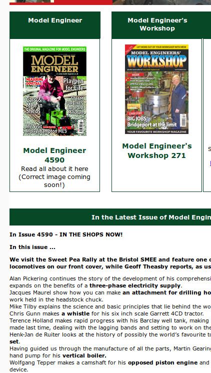

                                                Noticed a mistake on the forum. A special treat for all pedants. The ad for Model Engineer has got stuck in a time-warp:
                                                Not only that, but the correct image isn't coming soon.
                                                What a disaster, is counselling available for distressed gentlefolk like me?
                                                smiley

                                                  S.O.D.
                                                  You might like to read this thread about mew issue 271.
                                                  **LINK**
                                                  Can’t help you with 4590 though.

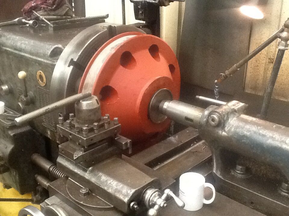

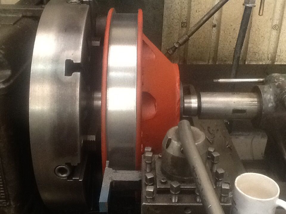

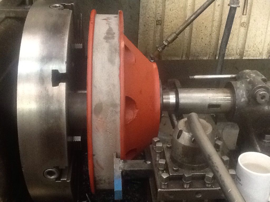

                                                      I've made a bit more progress on the full size Burrell. The brake drum was worn and pitted with corrosion in places, so it was mounted on the trusty Churchill Redmond lathe for a clean up.image.jpg……………A special cranked and beefed up cutting tool was knocked up to reach across the brake surface.image.jpg…………..The surface machined up nicely, after the wide brazed tip parting tool had a small notch ground into its cutting edge to eliminate slight chatter.image.jpg
