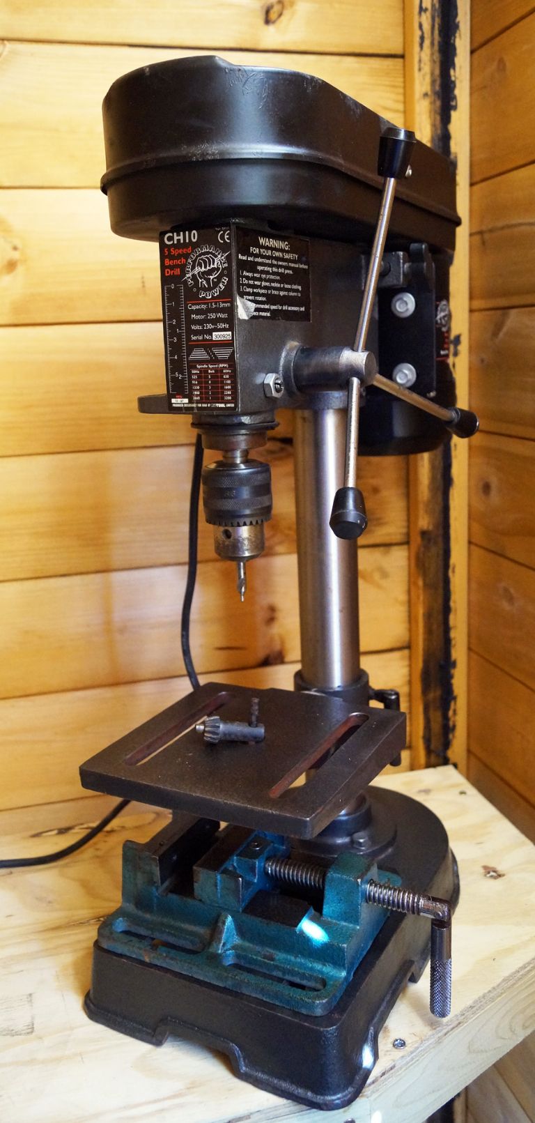

              Today I pulled my cheapie bench drill and vice from the back of the old shed, they had been in there for over eight years so wasnt looking forward to what I,d find.
              I was quite surprised though, there was some surface rust but not as much I thought there may be.
              Half an hour with a rotary wire brush and some 3 in 1, a few adjustments and they are serviceable.
              The drill is a CH10 model, it states on the label "performance and power"…wow…wink
              Actually it is not a bad little drill for a cheap import, I must have been lucky but the quill is very good for one of these machines and the chuck is half decent. Its quite useful for general drilling etc, so should see a fair bit of use.

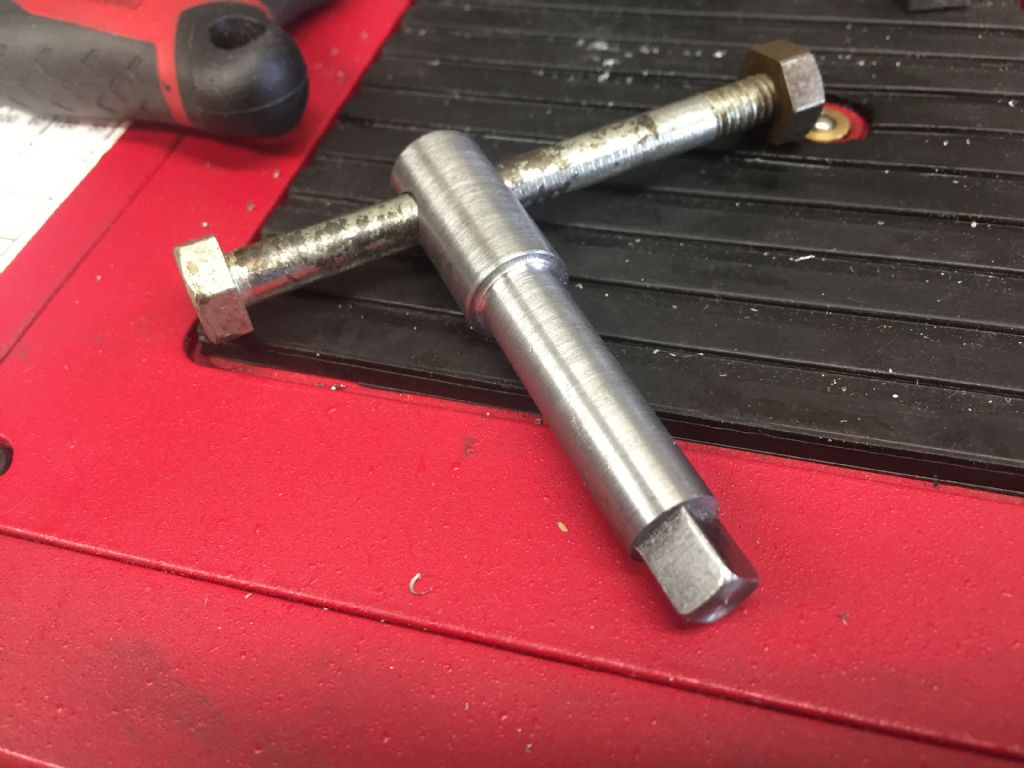

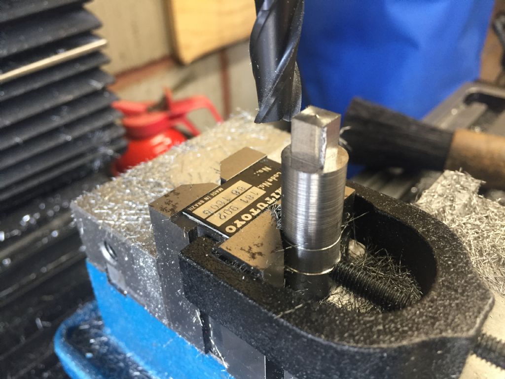

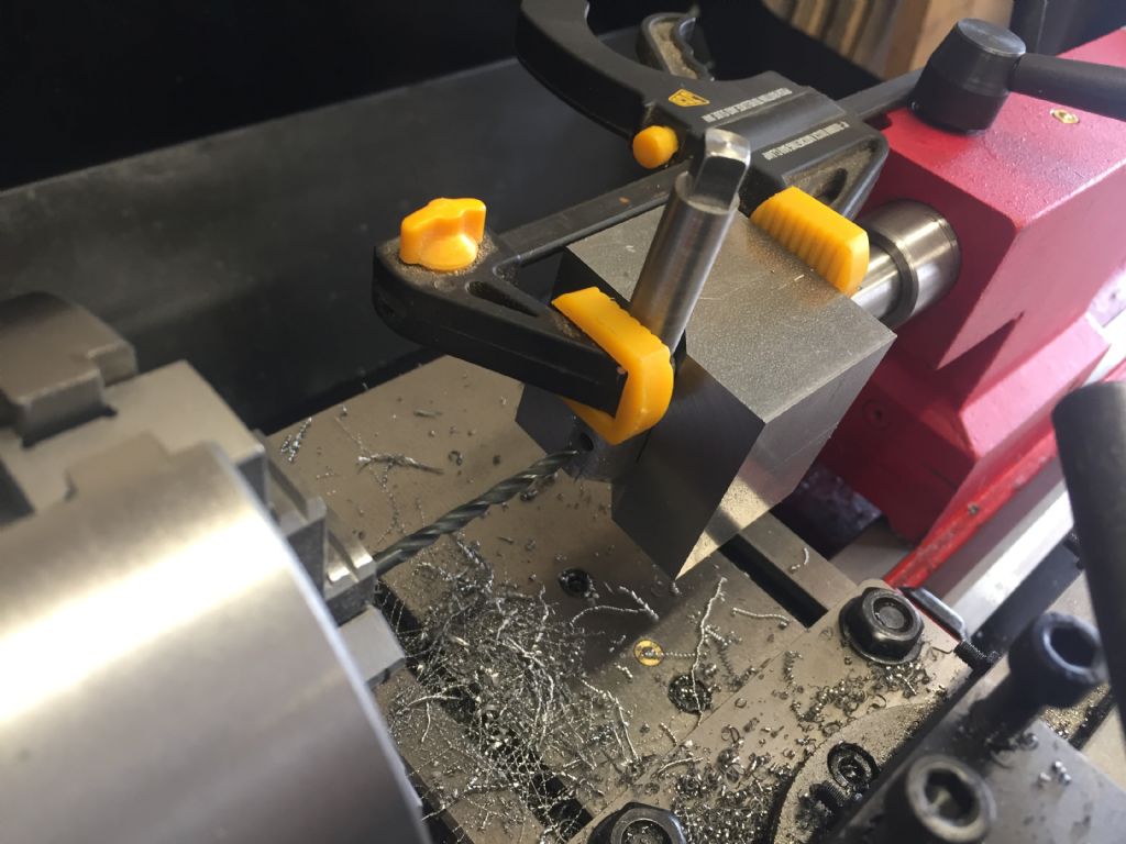

                    This is the first finished item I have made I think, a second chuck key for the 4 jaw: First thing was to mill the flats
                    Drilled the hole for the handle using the new support though had to resort to an unconventional way of clamping as I have finished the clamp plate or drilled the fixing holes for it
                    img-6474.jpgFinished Key. it seems to be a workshop rule that chuck keys have old bolts for handles
                    Very pleased with the result AND it fits

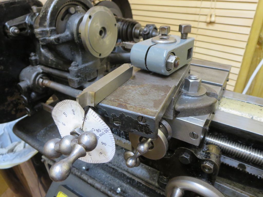

                      Well, yesterday in truth ….. attempted to fit a backplate to a four jaw chuck. Flopsville, cut the register too small (by a lot) and it's now sitting on the bench looking reproachful. Bother.
                      So today, I cannibalised another backplate off an old worn out three jaw and started to turn it to size. Learning from yesterday's effort I resorted to advanced metrology as below. Topside set to 7.5 deg. ish and a newly installed high tech micrometer dial and pointer.
                      So OK the dial is a bit of paper with 100 segments printed on it and the indicator is a parting off tool, but we all have to start somewhere!smiley
                      Actually it's working out quite nicely; I'm not kidding myself that the thing is really cutting to tenths, but it's certainly controllable and creeping up to the "warm fit" as recommended by Tony at lathes.com. Fitting a micrometer to the topside and leadscrew is next job on the cards, but I needed it now.
                      So to the serious bit … this is first time I've turned cast iron and boy is it messy. Is there a recognised method or procedure for cleaning the lathe down? The bedways on this lathe are really crisp for it's age, and this stuff won't do them any good at all; very difficult to completely shift though. Anyone?
                      Eug
                      Edited By Eugene on 23/06/2018 23:30:05

                                  Eugene, Don't you want the fine control on diameter? In which case you want the topslide closer to parallel to the bed.
                                  You can recover the old backplate by screwing on a mild steel disc and having another go.
                                  For CI cover the bed as mentioned above but rig the vacuum cleaner tube right next to the tool. Also good for dusty materials like wood and tufnol.

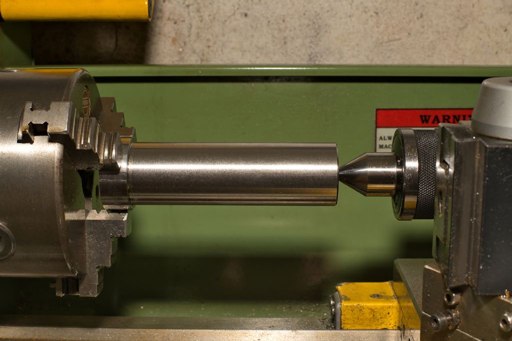

                                          Had a go at turning some 316 Stainless for the first time. I'm making some track tensioning pistons for a mini-digger 90mm long x 30mm dia'.
                                          It's actually ok for turning, apart from the stringy swarf which is quite nasty stuff. I was a bit surprised that the finish is better than the EN-3, EN8 or Silver-steel that I've tried to date.
                                          Here's a photo of one turned to diameter, just needs to be cut and faced to length with a compound radius blended at one end.
                                          Is there a way to get better (any) chip breaking from inserts, a different tip geometry CNMG perhaps?, or is it the nature of stainless to cut stringy? I'm using the carbide tips, photo below. Stainless is one of the materials recommended for these.
                                          Speed is about 450RPM, feed is set to the slowest 0.83mm/rev according to the change gear panel. Maximum depth of cut was 0.5mm (0.25 per side).

                                                Ed – the manufacturer's data for those inserts recommends 90 – 200 m/min surface speed for Austenitic steels such as 316.
                                                At a diameter of 30mm, that comes out at 950-2100rpm. Try increasing your speed to within this range.
                                                The "BF"chipbreaker geometry is designed for feed rates of 0.08 – 0.18mm / rev and depth of cut of 0.2 – 1.8mm. Taking a cut of 0.8mm pre rev sounds heroic! Again, it doesn't sound ideal.
                                                Murray
                                                PS – on reflection, it seems very unlikely you are actually cutting at 0.83mm / rev. I suggest you check your sums and gear settings!

                                                Ed Duffner
                                                  @edduffner79357
                                                  Thank you Murray, it was a typo.
                                                  It should have been 0.083mm/rev. So I'm already in the feed and DOC ranges, just need to increase the spindle speed.
