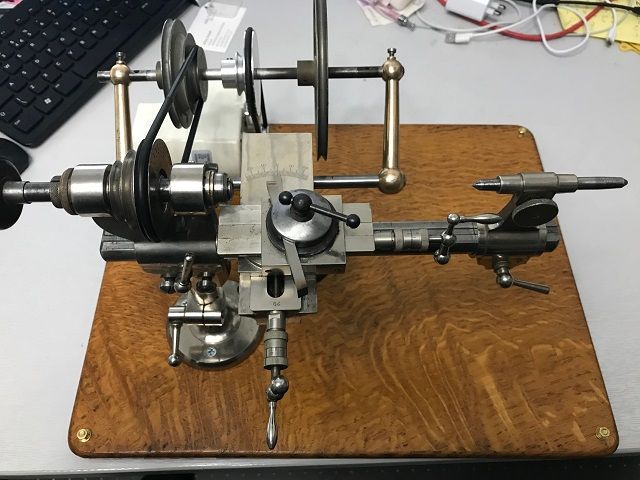

      Assembled Boley 8mm watchmaking lathe to a backboard to make it usable.
      Made the two aluminium pulleys, one for 6000rpm sewing machine motor and the other for the intermediate shaft.
      Runs quite nicely.
      Quick question for those who know about these things. How is the tool height adjusted. I appreciate I could use shims under the tool. On top of the top slide is a circular ring on which the tool rests and it is then held down by the cap, which has two slots in it (one for square tool and one for round). The circular ring is knurled al the way round, and I feel that this should rotate to raise the tool to centre height. It is on a central boss that the clamping screw is threaded into. The only problem is, it does not move, I think it may be seized. Have flooded it with releasing fluid but would like an idea before I either break it or damage the knurling.

        Colin,
        I have a similar top/cross-slide to yours. Once you undo the clamping screw the large ring should turn to allow you limited (2-3mm) adjustment of tool height. Mine definitely doesn't have any locking screws in the ring.

              Tom,
              Thanks for confirming the milled ring should move. I have WD40 or equivalent soaking into it.
              Is it a standard right hand thread, I,e. anticlockwise to raise the ring?.
              I need to find some way of holding the ring without damaging the milled edge. Did try to grip with a small 3 jaw chuck, but did not want to damage or break anything. Now I know it is meant to move I can have another go.

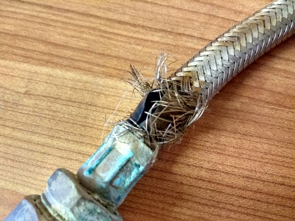

                This afternoon I heard the sound of a tap running in the bathroom. Went in an nothing on, but a wet floor.
                Rushed to workshop got a screwdriver, into downstairs loo and levered off a panel to shut a ball valve. Quicker than trying to get to the stopcock in the street.
                Water pouring through a large area of the living room ceiling, mercifully missing most things of importance, but not good for walls and ceiling.
                Damn – I need one of those 'easy fit' isolation valves.
                Managed to narrow it down to the cold tap supply to the washbasin. I managed to lever off a few large tiles without breaking any, luckily the plasterboard behind them was soaked and not full height. Then some reverse origami (facilitated by a speedfit-t) and I got this out.
                Can anyone suggest how the stainless steel braid got this hole in it? Looks like its been dripping for a while before it burst -see the corrosion.
                Fixed now, but I think I might replace the hot tap connector as a precaution as it uses the same sort of connector.

                  Neil,
                  Had the same thing here abt 4 years ago – pipe was only 2 years old and it did the same as yours. Problem is really poor quality of manufacture. The crimp is supposed to contain the stainless braiding over the full crimp length, but in my case went in only half way, with maybe 8 or so strands perhaps 3mm into the crimp. The inner rubber/plastic water tube is thin and bulges – it would burst but for the stainless braid, and that bulge pulled the poor crimp free and that was that..

                    Ian, I'd say the steel braid was mechanically damaged a long time ago – probably by a human gorilla who happened to be in the plumbing trade. Primates of that kind are not rare, sadly. They're the same species that typically overtightens compression fittings, causing the olive to wasp-waist the pipe, so that the very thing their overtightening was intended to prevent (a leak) happens.
                    The splayed ends of the braid have probably been munching lesiurely through that rubber core for years. Usually it's the hot flexi that gives up the ghost first because the high temps degrade the rubber faster. Rigid copper with sweated joints was all the rage at one time, and there is still much in its favour, all things being equal.

                      Would I be correct in saying that water companies do not allow their use in new installations anymore?

                        No, apparently WRAS ones are OK anywhere , but cheap ones have caused legionella outbreaks in hospitals!
                        These day every mixer tap is supplied with a pair.
                        I fitted the one in the photo, only about four years ago. It wasn't under any stress, the olive at the bottom was fitted to a short length of 15mm pipe then pushed into a speedfit T, so definitely not twisted or damaged.
                        I think Joseph is right, the braid probably wasn't fully in the ferrule.
                        The web has plenty of horror stories.

                          Sorry, I meant Neil. And I assumed, wrongly, that poor workmanship and by someone other than you, was to blame.

                            Not a rash assumption with me involved

                                        For Colin H,
                                        Apologies for the delay in responding, but yes it is a right hand thread, so anticlockwise to release and raise the tool.

                                                Tom (tomfilery),
                                                Many thanks for that. At least I now know I wont be attempting to tighten it further.
                                                I will give it another dose of lubricant and keep my fingers crossed.
