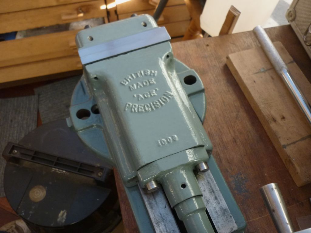

      Posted by mark smith 20 on 09/09/2017 19:24:07:
      Posted by thaiguzzi on 06/09/2017 05:41:29:
      Posted by mark smith 20 on 04/09/2017 19:00:56:
      Got the vice together apart from jaws, stoned all the dings /burrs of all the slideways, had to make new jib strip . Also
      put the `t` back in British.smiley The vice opens an closes pretty stiffly ,almost impossible by hand but easy with a handle. I suppose tighter is better where milling is concerned.
      Very nice job!
      Thanks, finally got jaws on it and its a very nice solid vice. Bought some 12mm x 40mm ground stock and used it.Got one of the jaw mounting holes off by about 1/2mm but it was enough to cause a bit of swearing as i couldnt see in which direction ,also the original holes were also slightly out of level.
      One question, what is the purpose of the 4 sloping holes visible ,are they just to poke something in if the jaws ever get rusted onto the body,to allow you to knock them off????indecision
      Edited By mark smith 20 on 09/09/2017 19:27:49
      Hi Mark, had a look at mine yesterday. No holes whatsoever compared to yours. Somebody has stuck those in post leaving the factory. For what reason only the driller will know.

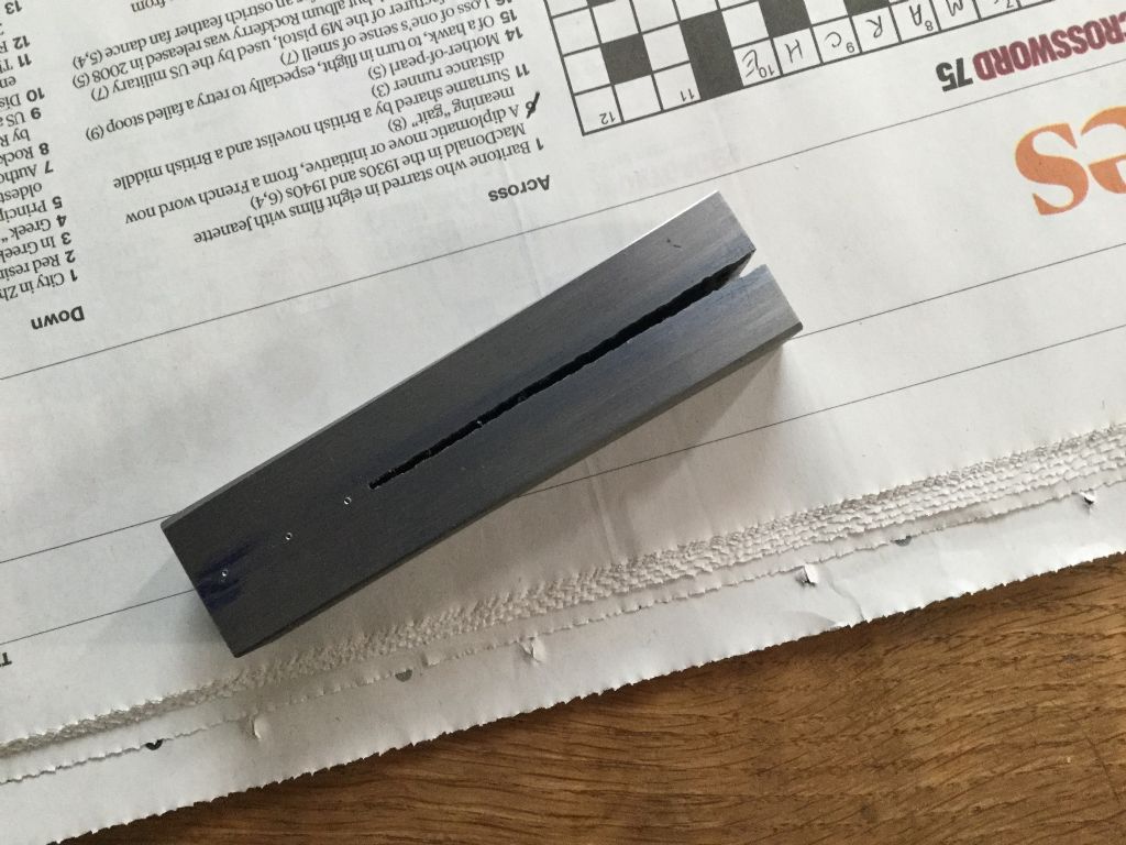

                To be honest I've never really bothered, or even noticed, how much a bit of cold-rolled moves when it is cut. But, not having the right size stock on hand today, I had to do a ridiculous bandsaw cut down the middle of a bit of 25mm square ms.

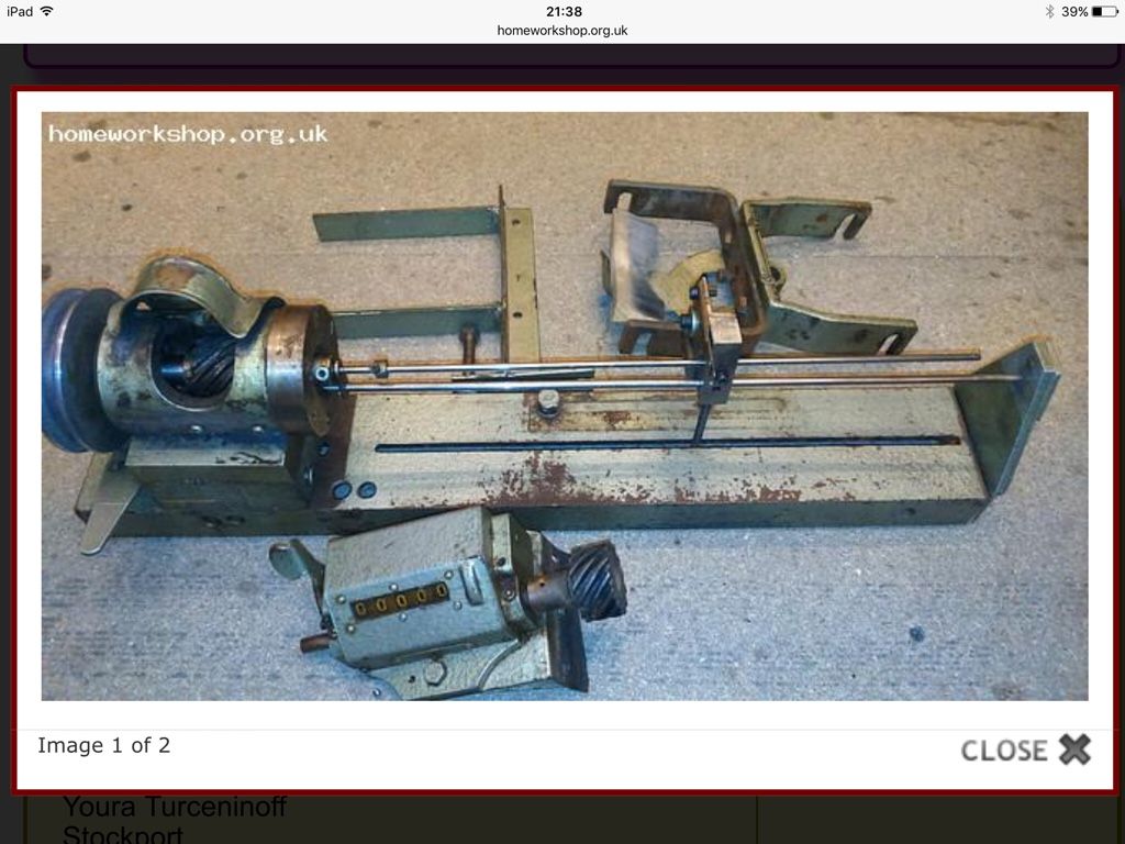

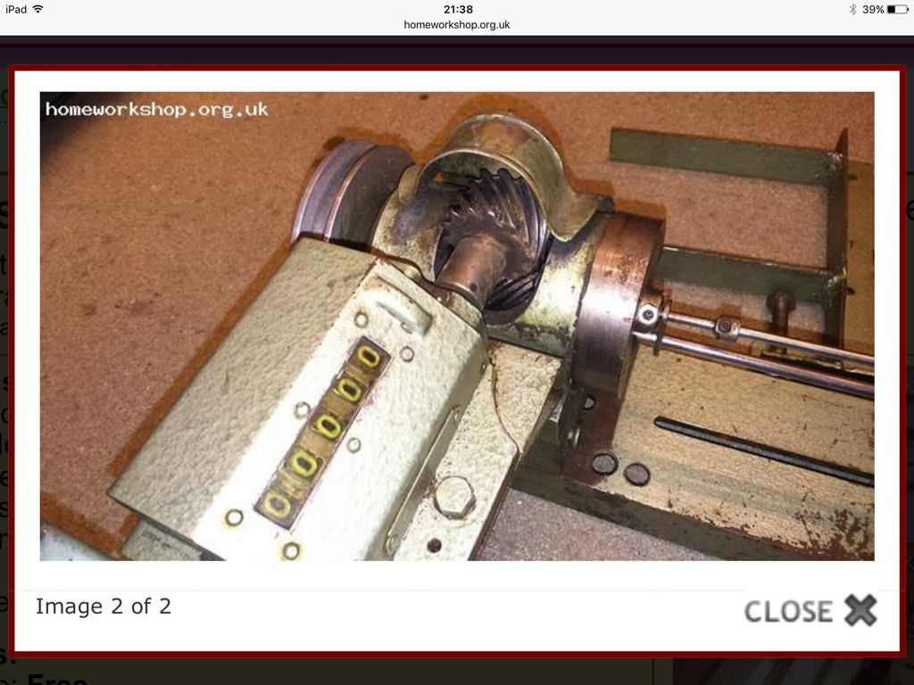

                    Posted by Michael Gilligan on 10/09/2017 18:12:04:
                    Yesterday; thanks to a kind gentleman advertising on 'homeworkshop' I acquired this:
                    We assume it to be the remnants of a Coil-Winding machine.
                    Today; I stripped it down for the bits I want [basically the headstock and the counter]
                    The build quality of the machine is horrendous, but those two items are good.
                    Question: Does anyone recognognise this assembly question
                    Clues: The machine came from France; the counter is by 'Zivy & Cie' of Paris; and the headstock casting is aluminium alloy with a steel front plate. … and the gears are very nice !!
                    Grateful for any thoughts.
                    It's a machine to coil resistor wire, in the manufacture of heating elements. The wire is close coiled around the rod, making like a giant spring, this can then be set into ceramic blocks like a snake winding a path up and down, and connectors soldered each end for the supply. How do I know, well I've just finished working at such a company, (owner was a bit of an eejit, to put it politely), they had a much larger version for this purpose, around 7 foot larger!
                    Of course it could also be simply a spring winder. The counter been used to count the revolutions between the windings.
                    To me the device that's sat in the middle of the machine between the two rods, is the feed device, and the two clamps at the rear of the machine in the picture is actually what's used as a means of bobbin holding the bobbing sliding across a third shaft elevated above the work.

                    Boiler Bri
                      @boilerbri
                      You would have to heat it up to cherry red and let it cool down if you do not want it to bow.
                      Normalisation to remove the stress.

                        Posted by Jon Cameron on 18/09/2017 22:58:18:
                        Thanks, Jon … That makes a great deal of sense.
                        I have already put the poor little thing out of its misery.
