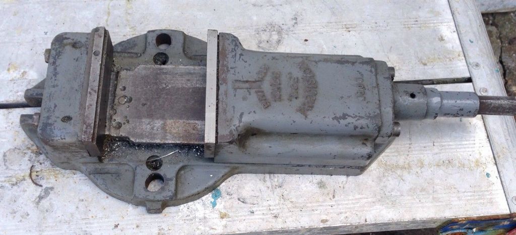

                        Bought this vice off ebay ,needs a little work but its the right size i was after (4 1/2 " jaws) and i like older stuff. Its a Ace Precision Vice. Anyone know who made them ?ive only found one reference to them being supplied by Adcock and Shipley.
                        need jaws sorted as the fixed jaw is bent and the moving one is raised in the middle along the length. Is something like 40mm wide ground flat stock suitable to make two new jaws??

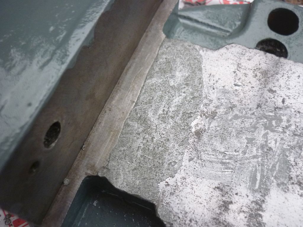

                        Has the usual drill pecking to the based which ive just filled with epoxy and zinc powder (didnt have any iron powder). The epoxy was some ive used loads of time from here. I think its quite reasonably priced and always seems good quality. Also you dont even have to pay immediately,which is rare nowadays.
                        http://www.shop4glue.com/epoxy-resin-adhesives-and-glues-18-c.asp
                        Seems ok ,ive scraped it down with a very sharp chisel whilst still soft ,and left it raised about 1/2 – 1 mm above the surface until its fully hardened.

                          Good vice!
                          I have the exact same vice, now sat on my TS M1 mill. I chopped the front lug off, as it sits better on the table, and its a big old lump for a 4 -4.5" vice. My new jaws were made from stainless (what I had laying about at the time) on the shaper, about 3/8" thick.

                                      Good vice!
                                      Thanks for the reply , so at least one person has one of these. I cant even find another photo of one on google. There must be more around.
                                      I unfortunately dont have a shaper or surface grinder ,as that would be an easy solution for the jaws. So probably have to use flat ground stock , not cheap though when i only want around half of a standard 500mm length.
                                      Im surprised no one sells blank jaw plates without holes in the UK ,only in the US i think.

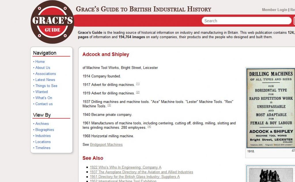

                                      This is the only mention i can find of ace, even Tony Griffiths site says they dont know who made ace lathes,if they are even the same company who made the vices.

                                          Got the vice together apart from jaws, stoned all the dings /burrs of all the slideways, had to make new jib strip . Also
                                          put the `t` back in British.smiley The vice opens an closes pretty stiffly ,almost impossible by hand but easy with a handle. I suppose tighter is better where milling is concerned.

                                                  I also have one of these, picked it up for very little money, missing its handle but had one in the 'one day it will be useful' drawer. Fits well on my Ajax AJT4. Milled the base and fitted a 5/8" bar to locate in the tee slots. Had not seen another one until now.

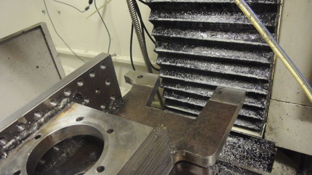

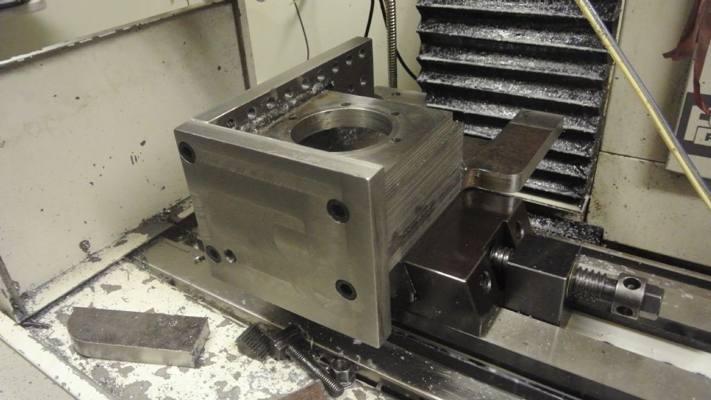

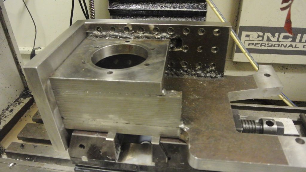

                                                    The Tormach CNC Lathe attachment (Rapid Turn) is a much better accessory that it's predecessor which was a Mini Lathe adapted and equipped with 4th Axis capability, however it lacked power to do any serious work.The Rapid Turn is equipped with a 1 H.P. motor and is much more capable, however it lacks multiple tooling capability being equipped only with a single small quick change tool post that clamps to the spindle nose thus rendering it necessary to change tools between different operations.
                                                    Other people have made Gang tooling to suit so I decided to have a go at making my own. Here are the results so far.
                                                    The holes that you see on the top plate are to permit long allen screws to be fitted into the bearing retain ring, though six holes are drilled only four are used leaving two permanently in the housing the lower plate is attached to two holes drilled and tapped in the rear of the travelling head. Note my scrambled egg welding.
                                                    dsc_4283.jpgThis view shows the side of the gang tooling fixture, the holes are all drilled and tapped M 12 to take allen bolts fitted through the tool holders and allow for the holders to be fitted at various heights nd distances along the Y axis.
                                                    This view shows the front plate of the fixture, the large tapped hole is there to take the securing bolt from my Quick change Tool post on my BH 600 lathe that I have at least 10 holders.
                                                    dsc_4281.jpgThis view shows the two rear holes in the lower plate. A spacer is fitted on top of the machined portion of this plate before the screws are passed through from beneath and screwed into the travelling head.
                                                    It's been an interesting project so far. I have started making some tool holders which will be able to take the small size Quick change tools that I bought for the original attachment, these will be height adjustable so I should be able to set them at the same height. They will also be bored to take round shanked tooling such as boring bars and the Tormach modular tooling that have a 3/4" shank dia.
                                                    Once I get some of the toolholders finished I will set up the lathe on the mill and take some shots of it and maybe some video of it in action.
