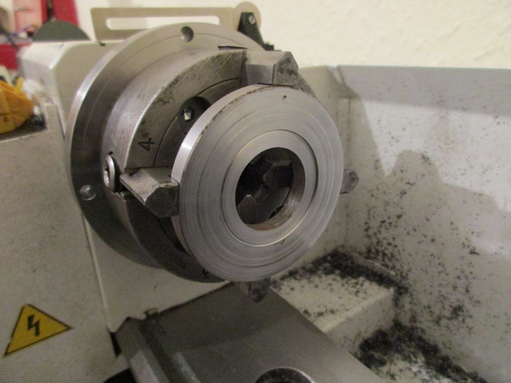

              Below is a thick washer that I have trued up and machined a shallow recess to take a steel blank for a small locomotive wheel, that I hope I can make.

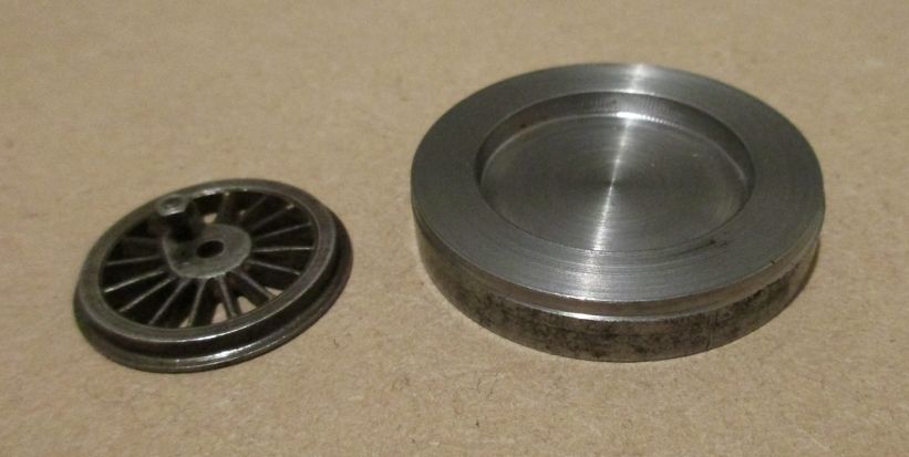

              Below is the back of the pre-paired blank that will be soft soldered into the recess in the thick washer. Alongside, is the wheel I hope to copy.

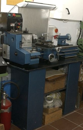

                                          The next part of the V10 Re-furb saga…
                                          ALL painting ( except a few few icky handwheels..) is done – Garage interior as well…
                                          Cabinet Assembly is mostly complete, lathe is part assembled to permit calibration and alignment of Headstock vertical and horizontal to bed, ditto the Tailstock. The leadscrew alignment is also done, as well as Halfnut alignment to leadscrew. Those are the slow and painstaking tasks out of the way, so final assembly tomoorow and wiring up the next day! Nearly there…
                                          A reminder of what it looked like at the start:

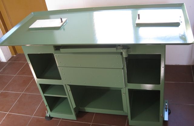

                                          Cabinet Assembly underway:

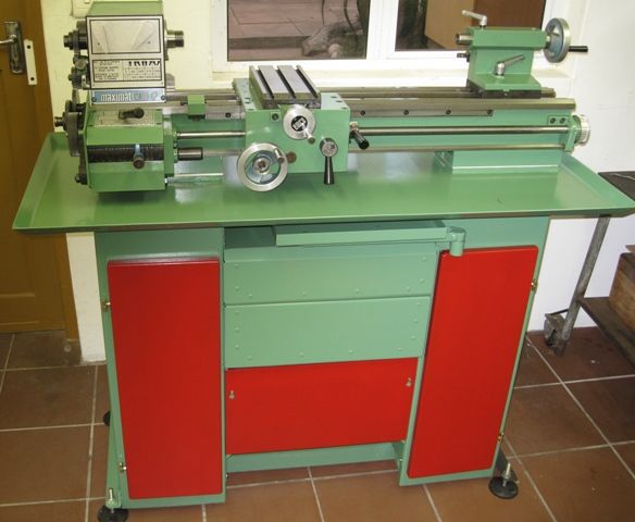

                                          Everything fitted as needed to complete calibration and alignment.

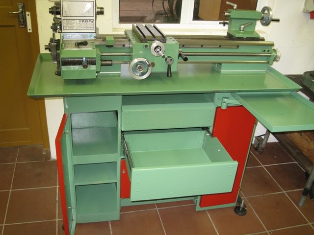

                                          Assembly continues Tomorrow!
                                          Joe….

                                                Very, very, very nice.

                                                  BrianV10 Re-furb: what a nice job, makes me quite envious.
