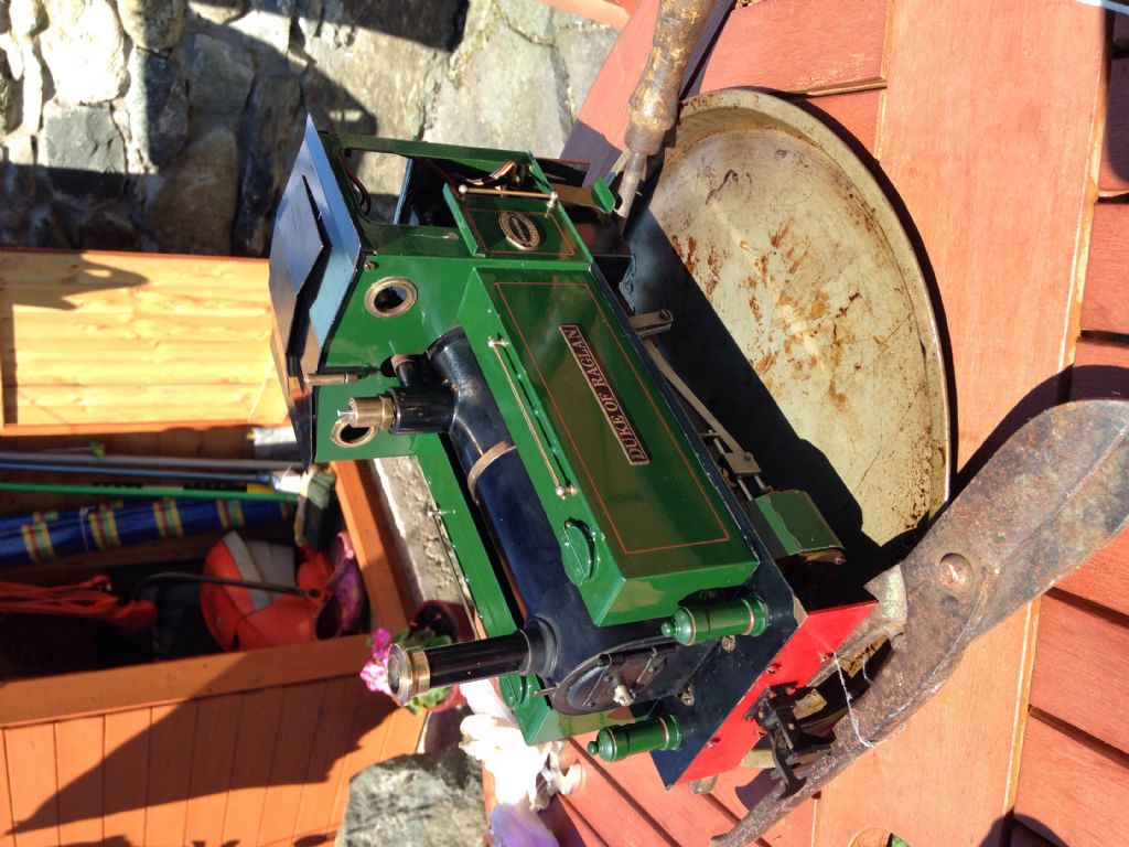

                                  Tried to decide if the loco I bought at auction is sm32, g guage or sm32 g guage or sm45 or ?
                                  These smaller gauges are a mine field.
                                  Turns out the wheels can be moved to make it either sm32 or sm45!
                                  Decided it's better on the sm32 as the track is cheaper to buy, now there's a yorkshire mans decision. Final!

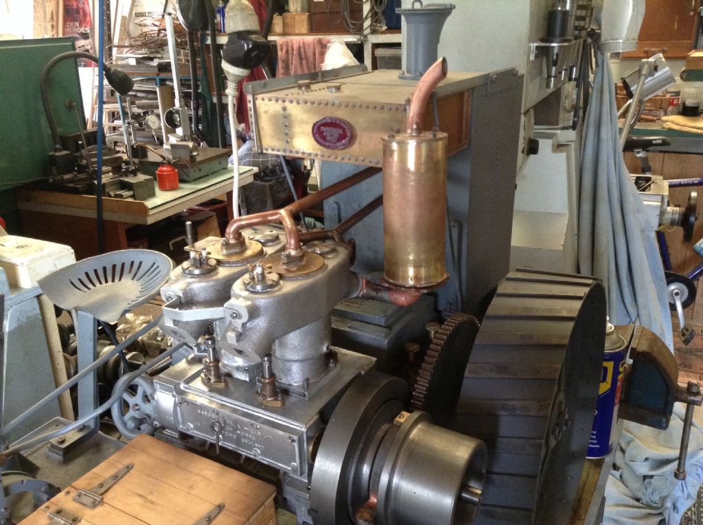

                                                Yesterday I made and fitted the I exhaust manifold and silencer to the engine of the Saunderson & Mills tractor.This has started to fill in some of the gaps around the engine and makes it more interesting to look at . Today I used the CAD drawing program to design the inlet manifold and carburettor. This is quite a complex unit and it has to line up with both the governor, exhaust manifold and control systems. I intend to first make this unit out of wood to check that it will line up as some of the clearances are small. Looks like another busy day tomorrow!
                                                George.image.jpg. Today I

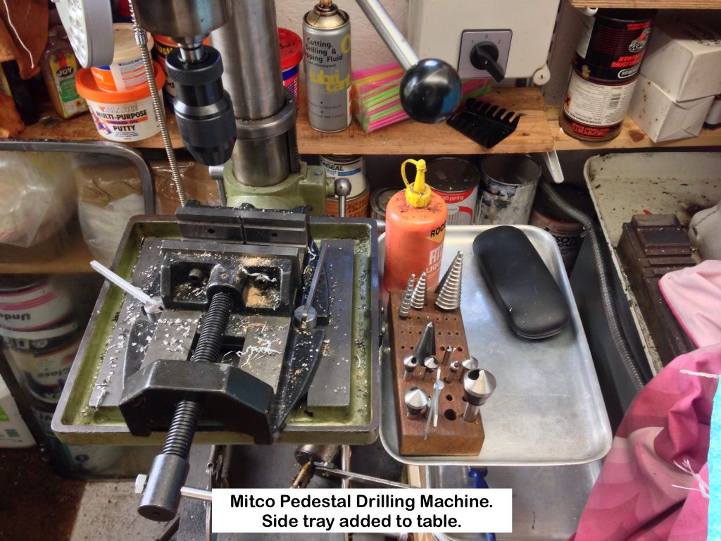

                                                  Tray added
                                                  Mitco pedestal drilling machine.
                                                  It was high time I organized where to put the most common bits and pieces used, so I fitted an aluminum tray to the side of the table.
                                                  Some time ago I bought a few 12"x8" aluminum trays for just this purpose, and to be used with the other machines as well.
                                                  Space restrictions, in the form of the Garage side door and shelving, prevented me fitting it on the more convenient lhs of the table.
                                                  Holes drilled and tapped M6 into the table.
                                                  Geoff – Getting there, but oh so slowly.
