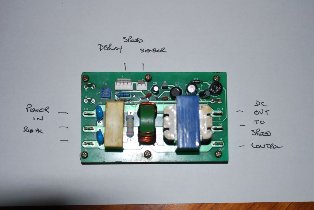

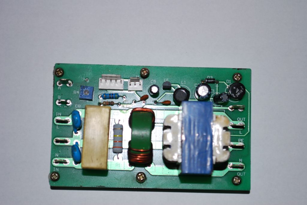

                    #291209
                    Dusty
                      @dusty
                      dsc_0091.jpgdsc_0089.jpgJohn, as requested filer board photo's. I am under the impression that the terminals you are talking about ( right hand side) are D.C. as the old motor was D.C.
                      #291212
                      John Rudd
                        @johnrudd16576
                        Dusty,
                        You should have two wires connected to the terminals on the left marked L and N in……this will power the board, to which you have the tacho connected….
                        The wiring that feeds the inverter, needs to be connected to the L and N terminals marked out, on the right…..
                        Just forget about the old motor and controller….
                        This should get you up and running again…..
                        Btw, the board is exactly the same as mine…and that is how I wired my inverter…

                                              #291817
                                              Dusty
                                                @dusty
                                                John,
                                                I have removed the board and photographed it, as far as I can see there is nothing untoward showing. the ribbon cable appears to be O.K. without any obvious breaks in it.
                                                #291837
                                                Les Jones 1
                                                  @lesjones1
                                                  Hi Dusty,
                                                  What is the part number printed on U1 ?
                                                  Les.

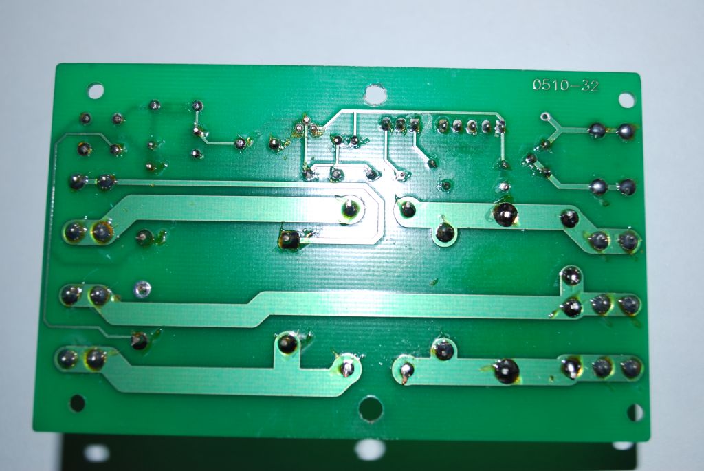

                                                  #291839
                                                  John Rudd
                                                    @johnrudd16576
                                                    Les,
                                                    U1 is a 7805 reg. Albeit in a TO92 case…
                                                    And….looking at the backside of the board, I think there are external links missing that apply power to the transformer
                                                    To be continued…..while I digest my tea and a few beers…
