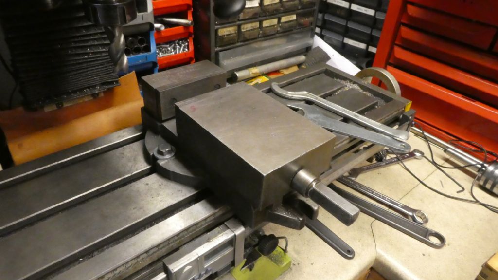

                    The vice on my WM16 is here:
                    Jaws are 90mm wide, open up to 67mm and are 40mm high. It cost me £7 if I remember correctly from a bloke in a field one Sunday afternoon some years ago. First thing I did with it was mill a slot underneath and fit a key to locate in the table slot. Saves clocking jaws every time the vice is refitted to the mill.
                    I have a 6” diameter rotary table purchased from WARCO who advised only the 4” but I though that would be restricting. It came with several dividing plates. Howerd Lewis of this very forum has a correction table available for use with the Vertex HV6 which I believe applies here. If not I’m sure he will correct me. Details here:
