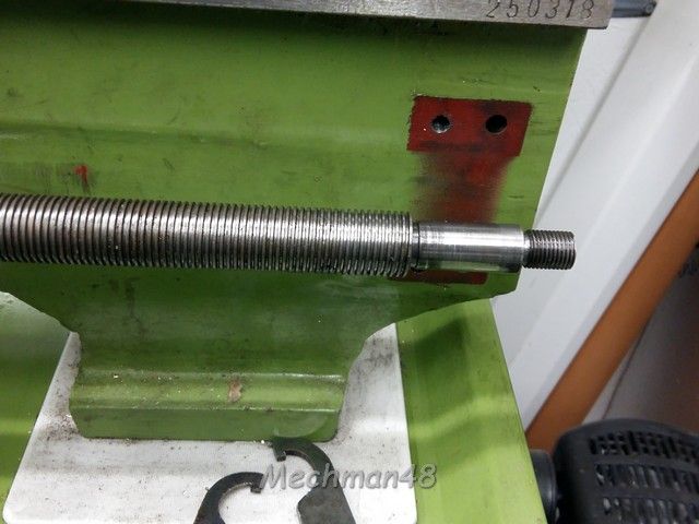

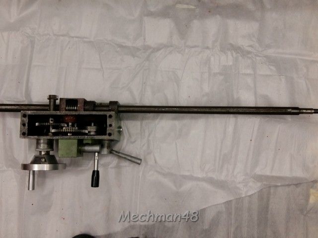

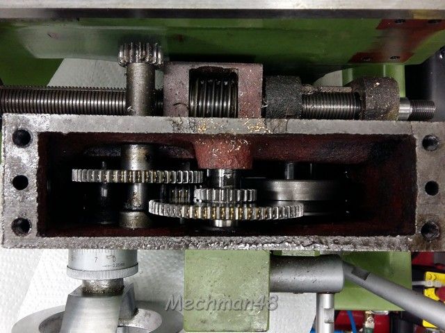

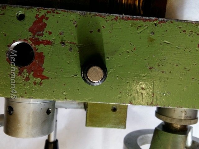

                                              I have just finished a saddle removal on my 250V-F the other week to find the leak on mine, mentioned some time back in the Warco 250 & WM16 family thread I've had the machine since 2012, bought at Harrogate exhibition. I noticed the leak early on but as said it was a minor annoyance & as it only needed a small top up every couple of months I left it.
                                              I didn't have too much hassle dismantling it, but noted that the lead screw only comes out one way, left to right, ( once you've taken shear pin out ), the as the drive keyway doesn't run all the way along the leadscrew, it tapers off at the tailstock end, don't lose the drive key… don't ask, luckily I found it. The spring swarf guard is a PIA to get off/on by the way even so I decided to put it back on when I'd reassembled it.
                                              As others have noted I found some casting sand in there also, but a good wash out with white spirits got rid of most of it, I didn't strip the saddle right down as I didn't want to disturb any other sealing methods nor start punching taper pins out of gears. The problems was the drain plug wasn't secured up tight on assembly… it is a parallel thread not a tapered plug, so some PTFE tape & Loctite sealant was applied as a remedy, I fitted a rare earth magnet onto the plug prior to re-assembly as a precautionary measure. Having checked this week there is still a leak… but noticeably less than before so I suspect some casting porosity is the major problem with these machines, but at the moment I can live with it.
                                              A couple of pics for your interest…
                                              Leadscrew brg off…
                                              General assembly of saddle gearing…

                                              Earth magnet fitted to drain plug…
                                              I made a paper gasket for the saddle joint as there wasn't any form of jointing on original assembly, didn't have any jointing/gasket material/brown paper/Hylomar or the like, other than printer paper to hand so cleaned up a couple of burrs off the edges, smeared some grease onto both surfaces before sticking the printer paper on… well it's not exactly a gas turbine joint is it, so sumfink is better than nuffink innit. It's back in service now & as said can live with the much lesser leak… I know, purists will comment should have fixed in right in the first place but can't be a***d stripping it down again… & with the probability of there being casting porosity in the equation…well… ?
