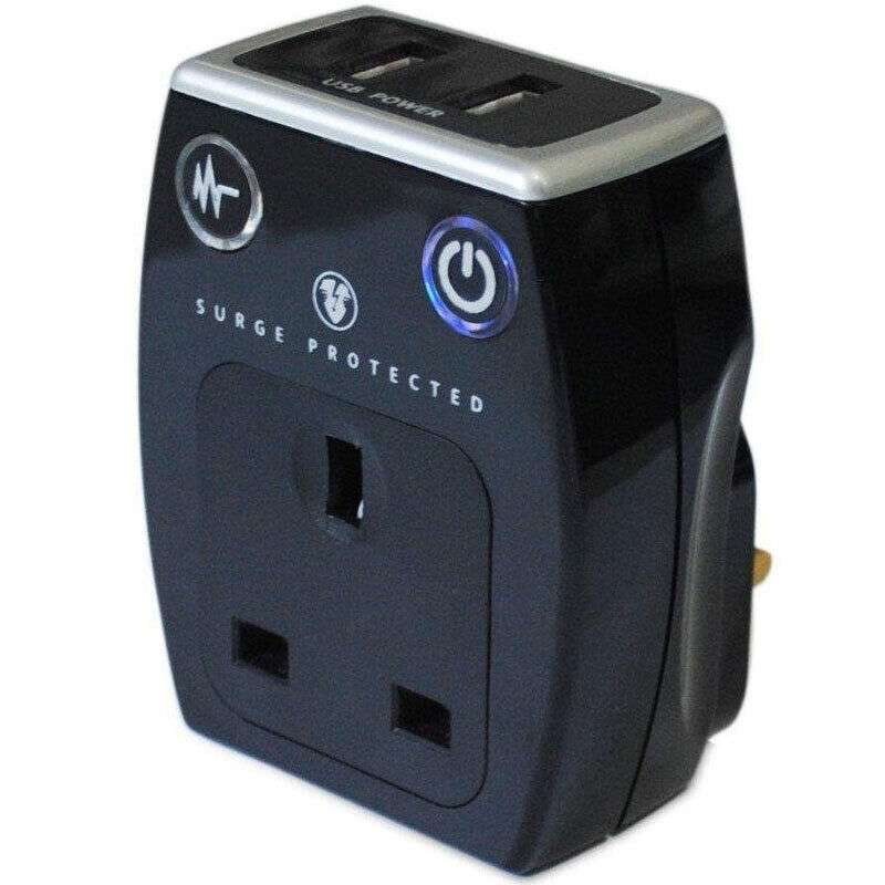

      Journeyman
        @journeyman
        Like this perhaps, 2 5v USB out with through 13A
        wartwithsocket

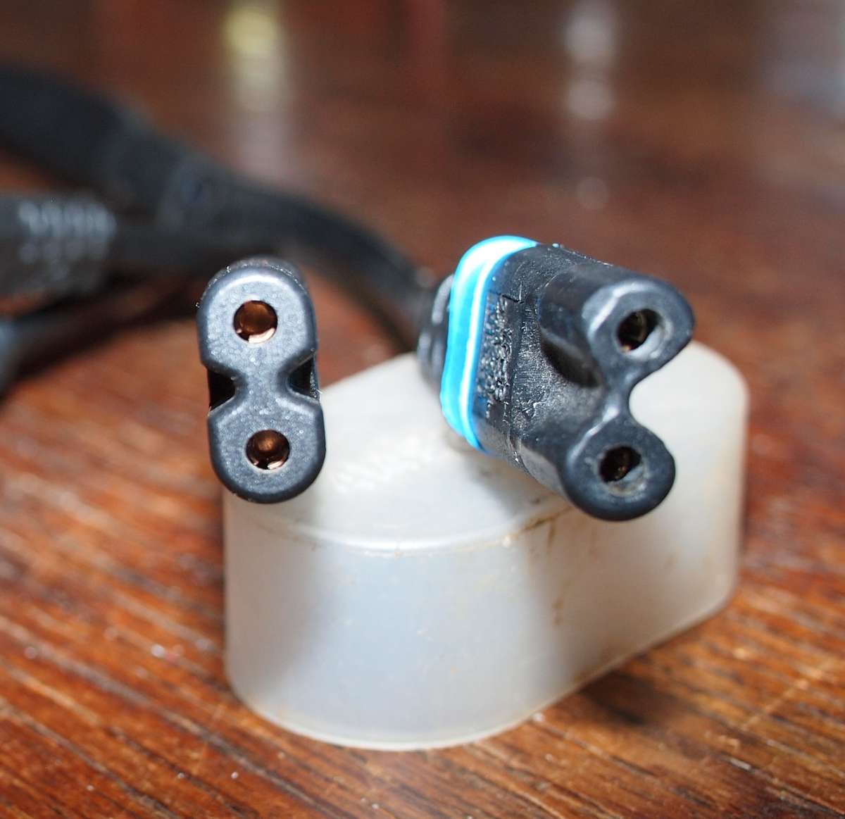

                                            I also change cable lengths with solder and heat shrink tubing, but that’s more problematic if the manufacturers have used co-ax cable as well as plugs; some just use round or flat 2 core.

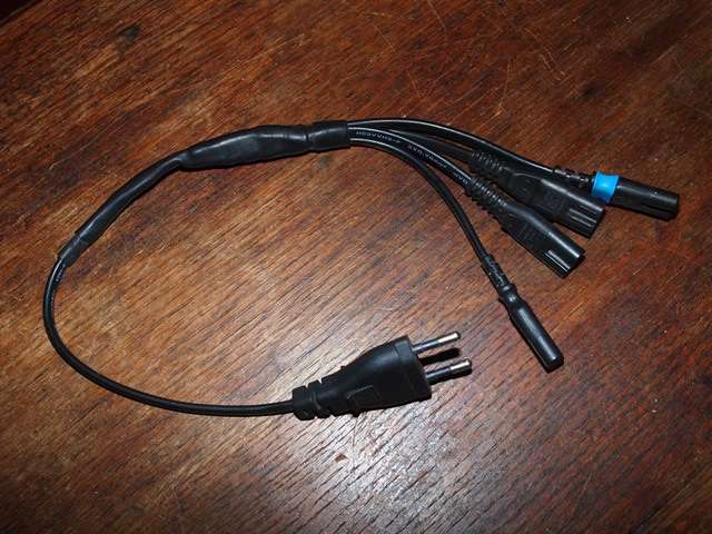

                                            To add the usual topic diversion, my issue when travelling is too many mains connector cables needed.
                                            Again my solution is heat shrink and solder; two layers of insulation on each core, with a further 2 layers on top, and checked with a megger.
                                            DIY Photo Bits_00001
                                            I have others with UK & US plugs; there’s no issue with overloading as the high voltage power demands are quite small.
                                            The end with the blue band, has been Dremmel modified to fit a cloverleaf, so it can be used for my laptop  charger.
                                            I did check, the original cloverleaf – UK cable is only 2 core.
