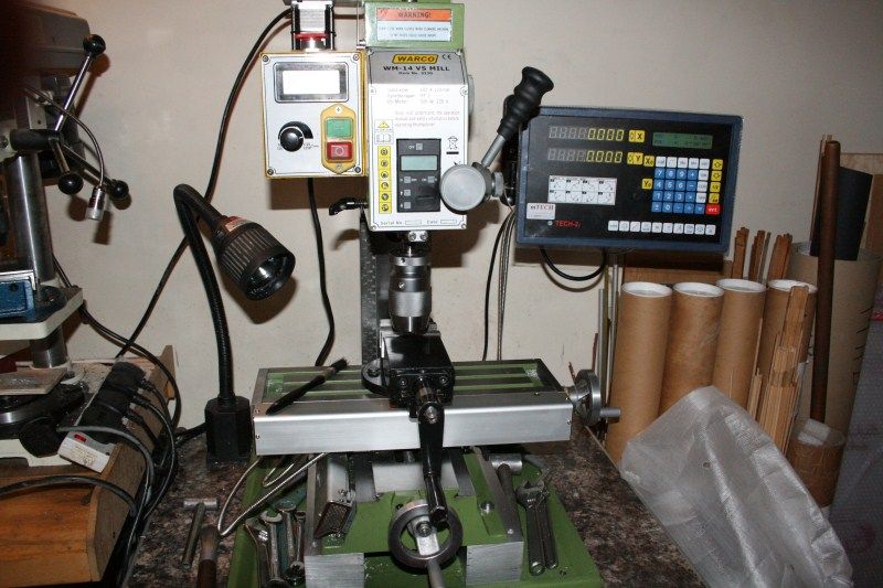

                      also hear is a picture of my mill with the 75mm vice fitted

                        Thank you for the photo, the vice looks in perfect proportion to the size of the mill.
