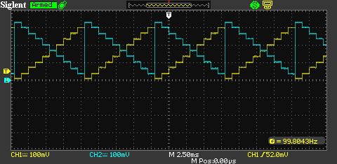

                                          Just to see if my oscilloscope can do an XY display I knocked up this simple proof-of-concept. It draws a single diagonal line by generating X,Y coordinates with a loop. Roger's version will be cleverer!
                                          The microcontroller is a Nucleo F429ZI, complete overkill for this except the chip has two built-in DACs, so no need for me to bread board a circuit. One DAC does X, the other does Y, and they can be connected straight into my oscilloscope. The output voltage can be between 0 and 3.3V.
                                          The demo C program increments X from 0 to 1.0V in 0.1V steps, and Y is the inverse 1.0 – X with a 1 second delay between each step. The code is:
                                          With the oscilloscope in normal YT mode (T is timebase), the output waveforms are X (yellow) and Y (blue):
                                          Putting the scope into XY mode, which maps channel A against channel B, produces the expected 45°diagonal line:
                                          The line is dotted because at 0.1V per step my 'pixels' are too far apart, ie coarse. Stepping at 0.01V would be much better.
                                          So Roger's approach works in principle. All Roger has to do is the hard part – driving the oscilloscope trace with a list of coordinates read by a microcontroller from a PC! Hours of fun ahead…
