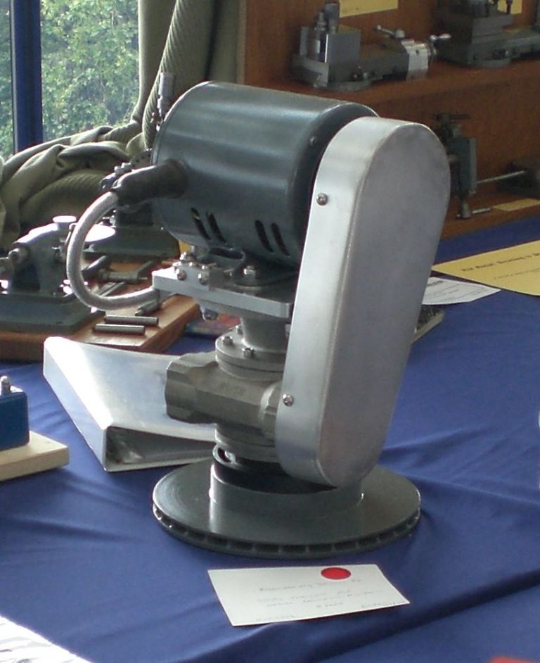

                                  Hi, here's how I've used one.
                                  Speed Reducer
                                  It was shown at the ME centenary exhibition in 2007 and also at the Midlands, and a brief description can be seen in the artical on the Midlands Model Engineering Exhibition 2007 by Richmond in MEW 132 pages 34-36.
                                  Regards Nick.
