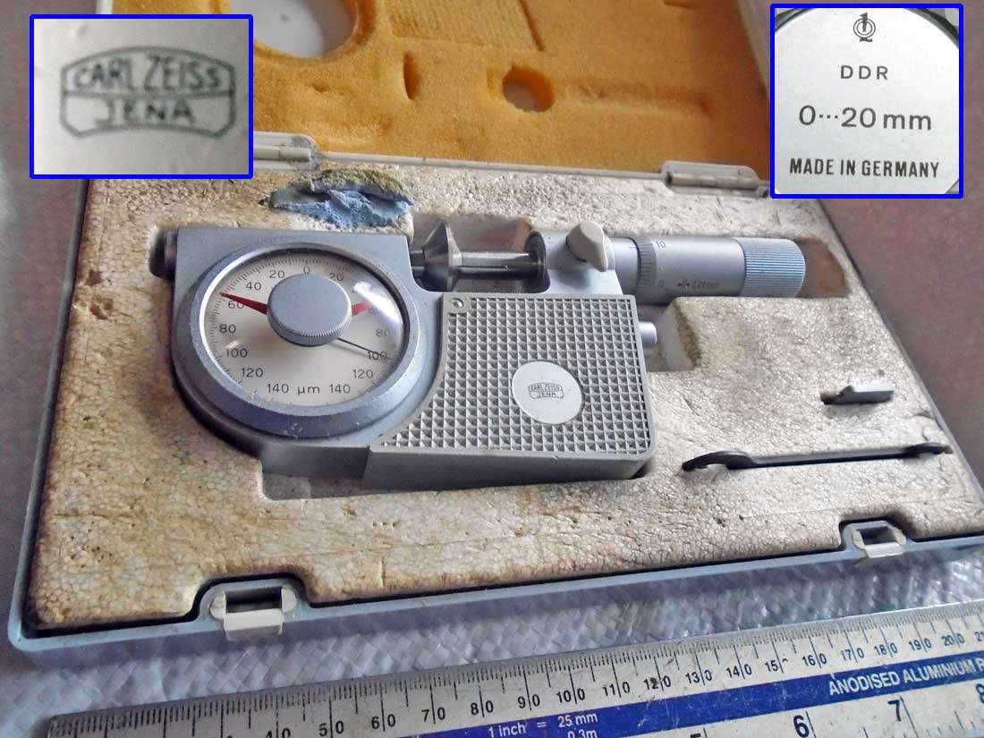

      Hi All

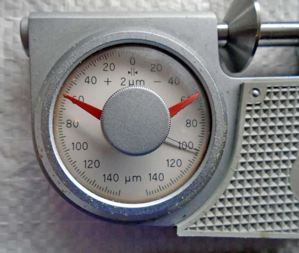

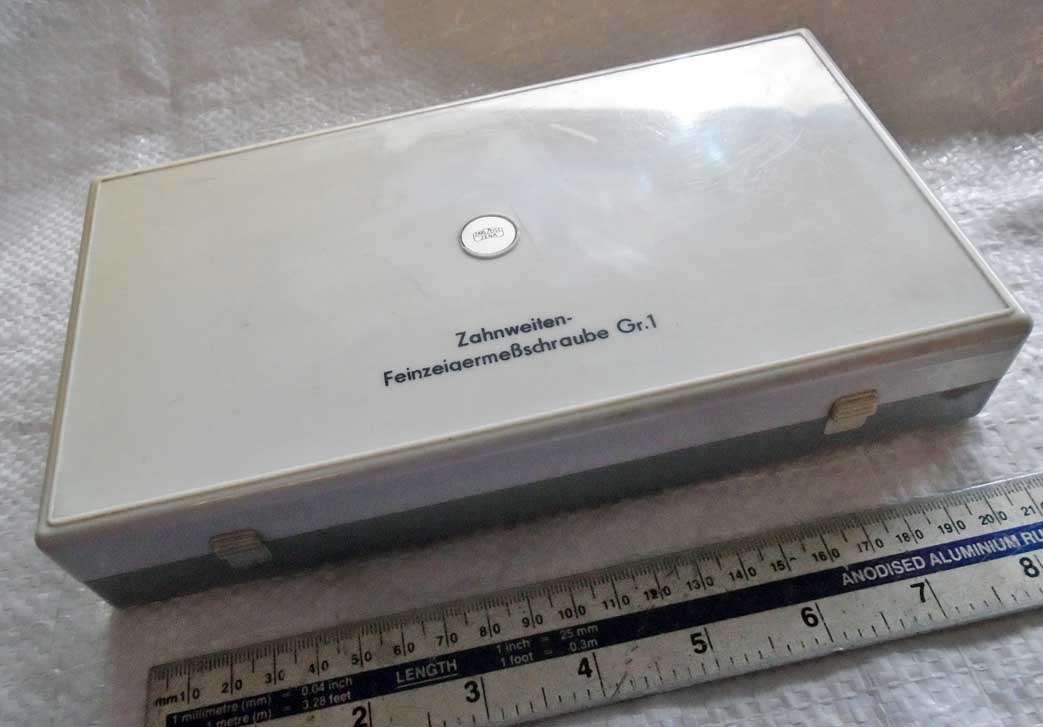

      Just got 3 of these to clean up. Have not seen these before, something to do with screw threads if the German  is correct? The “fixed” anvil is spring loaded and operates the dial gauge.
      At “rest” the needle sits at 6 0’clock
      I would love to know the exact use of these and how they are operated please.
      Cheers, Martin

        I don’t think it helps much, Martin …. but my favourite translator comes-up with:
        Tooth-wide
        Fine -handed meal screw size 1
        Technical German is usually pretty logical … but that defeats me for the moment.

          It’s a comparator micrometer. Thimble is locked and you get a deviation indication on the DTI. Button under thimble should move the “fixed” avil away to insert part. The red indexes are settable for pass limit use with semi-skilled operators. The large contact fces are for soft material or to prevent surface damage.

            Google translate on “Zahnweiten-Feinzeigermeßshraube” gets me the response “Tooth width micrometer”.
            Presumably set to dial zero using a reference standard (gauge block?), then moving the fixed anvil away and inserting the tooth to be measured gives a plus minus indication of deviation. Red markers are allowable error?

                  Often used for measuring across spur and helical gear teeth, or in the OPs case for making comparative measurements on gear teeth.

                          Having now looked closely at them it is apparent that the build quality is very high as one would expect from Zeiss.

                            Some models, seemingly identical to Martin’s are also labelled as Steinmayer (Feinmess).
                            https://www.feinmess-suhl.com/en/company/history/
                            I presume the labelling changed as the various company divisions were separated post re-unification.
                            My own one is labelled as Carl Zeiss

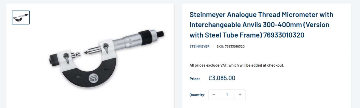

                              Never heard of Steinmeyer before and having looked their prices up I’m impressed!
                              exmicrometer
                              VAT adds another £617…
                              Can’t wait to be asked what I want for Christmas!
