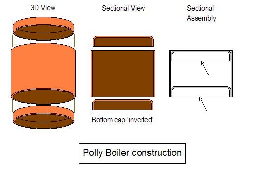

      Hi All ,
      hare’s a pic of the drawing of the little boiler for Tubal Cains ‘Polly’ :
      [IMG]http://i5.photobucket.com/albums/y185/whitebeetle/002.jpg[/IMG]
      I’m unsure about the drawing regarding the end caps.I have marked on the drawing what i assume are where the end caps are fitted but there is another line on the drawing top and bottom that i’ve marked with a ‘?’
      Probably a silly question but is this another plate accross the bottom because i can’t see any explanation of this in the text.
      Any help appreciated

            The end plates have to be “Flanged” that means that a flat disc is bent over a round former in effect giving a dish with straight sides, these sides give a greater surface area for the folder to form a strong joint.
            The lines you see are the rim of dish

                Hi , Yep i understand that but why are there two horizontal lines top and bottom ? isn’t the end cap just one line with the flanged sides against the vertical sides of the boiler ?

                  Thanks for that , yep got it now !!

                      Hi Chris,
                      Reading engineering drawings can be a bit of a black art for the beginner with no experience of them. They incorporate various standard methods which seasoned engineers will take for granted.
                      In answer to this part of your question, the confusion may arise due to the way standard engineering drawings are made. The lines you indicate are the bottom of the end caps. The lower end cap is ‘inverted’ and inserted into the bottom of the boiler. I have made a sketch which shows three drawings of the sort of views of the same boiler construction similar to a ‘Polly’ which I hope explains what I mean.
                      I have indicated with arrows the lines you questioned.
                      Hope that helps,
