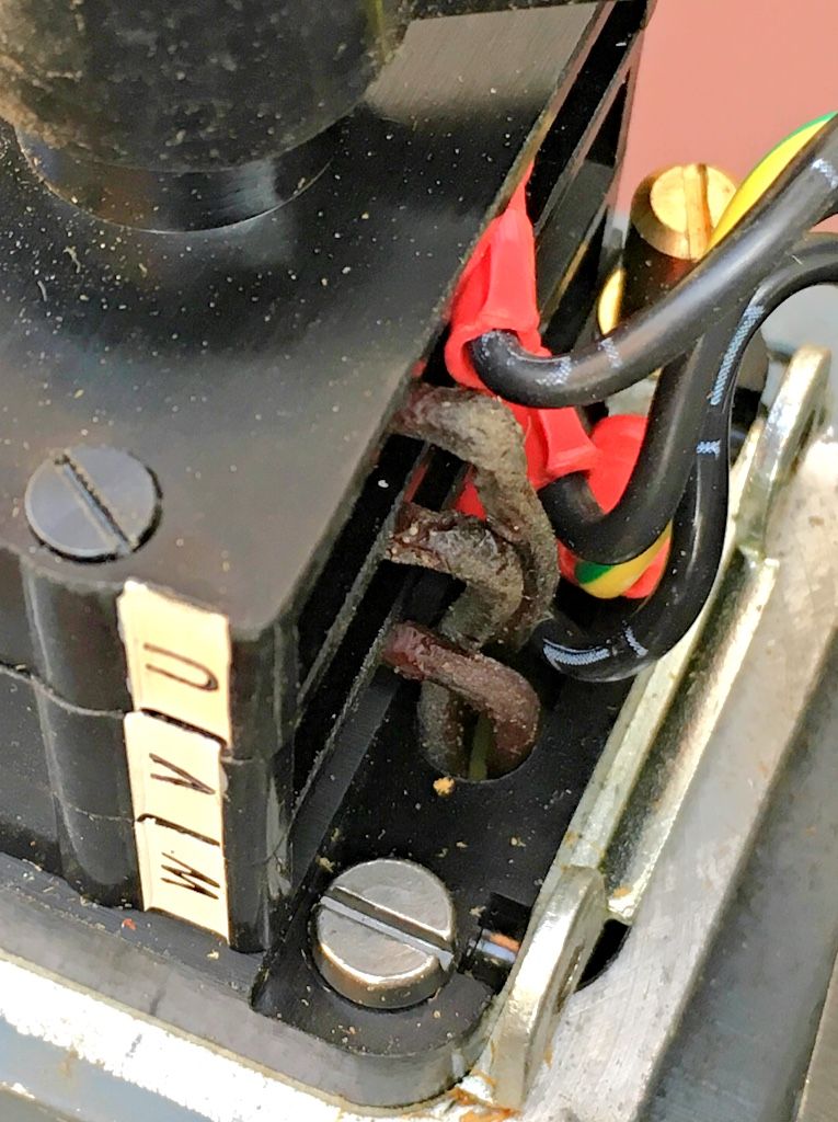

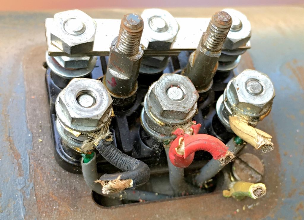

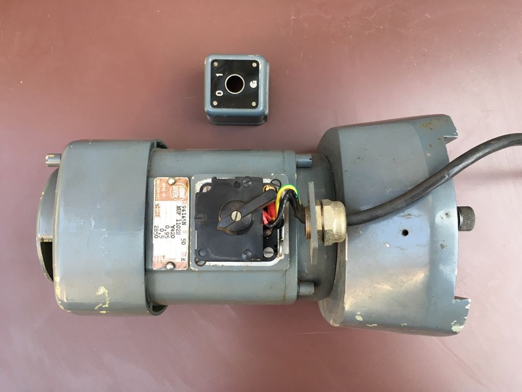

              I had a look at the motors and wiring today.
              The inverter manual correctly specifies screened cable for the motor [see page 30], and advises against externally switching the 3-phase output.
              This therefore seemed an appropriate time to remove the switches and leads.
              • The flex to the Ed'E pantograph motor was rubber, and badly degraded … [snipped off for this photo], but the internal motor wiring has much better insulation, and looks fine.
              • Contrary-wise; the flex on the BB motor, for the Aciera head was PVC insulated, and in good condition, but the insulation on the motor wires felt rather tacky.
              Next step is to remove the switch from the motor and check the condition of those wires.

              Ajohnw
                @ajohnw51620
                It might be some sort of treated cotton wire covering Michael. I have come across that in a number of older things that involve winding bare wire. I can also be slipped over normal cable. I wouldn't worry to much about it feeling tacky but I have no idea what they put on it other than it's probably some sort of varnish that tends to stop like that.

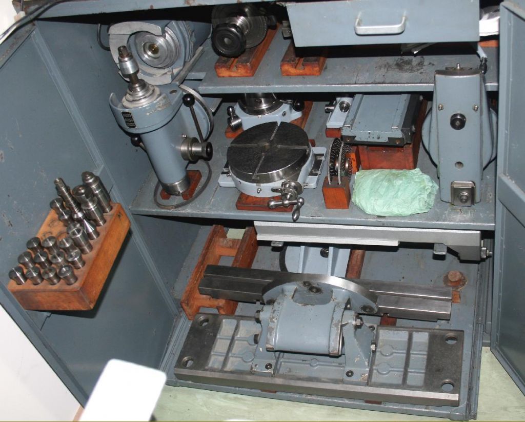

                                              John,
                                              I don't wish to be rude, or ungrateful, but:
                                              I explained about my motors and their mounting to 'Quantum Controls' and asked for specific advice; which they have kindly given.
                                              The Aciera head is like the one pictured here, dismounted, in the stand of an F3
                                              https://goo.gl/images/jH21yF
                                              It is, and must remain "portable" and therefore I have to arrange my wiring accordingly.
                                              Edit: Image froms lathe.co.uk [as credited above]
