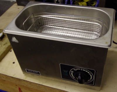

                                  This thread reminded me to dig out an ebay purchase from some time ago, a Walker Ultrasonics unit (110W, about 2 litres I think) which the seller said came out of a dentist's surgery. It had been in a cupboard for a while as I wasn't that impressed when I first got it but never got round to digging into it.
                                  Just tried it again with some hot tap water and washing up liquid. It buzzes away all right but there's little evidence of cleaning beyond what hot water and soap would do anyway. Tried some kitchen foil and it was unaffected after 10 minutes…
                                  Took the bottom off it for a look and the transducer is still stuck to the bottom of the tank. Could that joint nonetheless have failed, explaining the buzz yet lack of cleaning? Or were dental units like this always designed to be rather more gentle than we need for cleaning bits of metal?
                                  Grateful for any ideas to fix/otherwise make it more effective…

                                    You should see a lot of disturbance on the surface of the fluid above each transducer.
                                    A lot of people have un-realistic expectations of what these machines actually do, they seem to expect a grubby old casting to come out nice and shiny. This is not going to happen.
                                    They are very good at loosening engrained dirt from a surface though, if you are cleaning brass parts you can get good results using one of the ammonia based clock cleaning solutions, this will brighten the brass as well as removing dirt (It will do this in any tank, but the ultrasonics speed up the process).
                                    Phil

                                      Posted by Bikepete on 01/10/2016 21:30:37:
                                      How do you mean, "unaffected". If you hold it up to the light you should see tiny pinholes (may need a magnifier).

                                        Mmm, after a bit more experimentation all seems well and perhaps indeed some expectation adjustment was in order
                                        Think the main thing confusing me was that with the basket in place the agitation of the water pretty much disappears – just some smooth ripples left. With basket out and less water in the tub then the vigorous agitation of the water as described above is very obvious. Doing the kitchen foil test and holding to the light shows pinholes (mainly on creases) after 30 seconds both with and without basket, so it doesn't seem to change the effectiveness much. Not sure why I didn't see the holes last night.
                                        Just cleaned some oddments and it does indeed work – not quite blasting away rust etc as might have been hoped but it does loosen dirt and grime. Used fairly hot water from the kettle with washing up liquid again – might try some of the other recipes in future. Also, some gentle brushing/poking with an old toothbrush during the cleaning process to remove loose crud seemed to help.
                                        Would probably go for one with a heater if buying again – as well as any cleaning benefit, having the item hot means water evaporates off pretty fast once removed, so less chance of rust.
