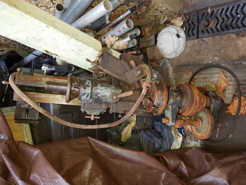

              Thanks Guys. I much appreciate any help you can provide. Ive an album of my Zyto as it was delivered errr 3 weeks ago now. An impulse buy on E-Bay late one evening. My thoughts were its a little lathe ! I will have her up and running in no time :/ Thinking a week or two at the outside. :'( Anyroads.
              Parts i either need or want.
              Leadscrew Handle,
              Motor,
              Countershaft,
              Flat Belt,
              Guards,
              Gears, 45,50 and 63 – The 63 was a later accessory for metric conversion.,
              Orgional Faceplate,
              Origional Driving Plate,
              Any and all litriture pertaining to the Zyto, Accessories, Projects etc.
              Thanks to Chris and Martin for their replies. Will look forward to hearing from you Chris re any spares you may have.
              Im worried that my headstock bearings are shot. I full cups with 3 in 1 oil and turn the spindle by hand and you can see the right hand side cup drain of oil as you turn spindle.. I would't use 3 in 1 when in use but i was just wanting some lube in there to help free the spindle out. I seem to have a tight spot so likely the spindle has been siezed and has gaulling. I should really strip it and inspect it but 've avoided this so far.

                      Hey guys, Can any of you recommend where i can figure out the speed range of the Zyto using the diameter of the pulleys and back gear ratios. Also i need clarification on how the little knurled spring loaded pin in the main spindle 80 tooth gear interacts with the pulley drum. Likewise an explanation of the 'dog clutch' at the rear. Again any help is appreciated. I need all i can get

                        Ok Guys. Large pulley is 4" middle pulley is 3 1/4" and small pulley is 2 1/2"Please ignore my question on the 'dog clutch' i meant backgear and was just being stupid at the time. I get tired as i try to do too much and then stupidity occurs blush. Ive been mostly busy cleaning, inspecting , fettling and repainting the zyto for past 3 weeks now. Every cast part is getting 4 coats of paint im soon to start final coat. Then final polish of parts and assembly
                        #388062
                        Martin Whittle
                          @martinwhittle67411
                          Speed required depends on the work: material, diameter etc. For most practical purposes on smaller work I leave the lathe at a 2:1 step down on the drive from the motor countershaft (approx. 2:1 pulley diameter ratio) so around 700rpm usung a 1400rpm motor.
                          I have the option also of the middle step on the pully giving me a 1:1 ratio roughly, so 1400rpm – this is as fast as i would ever go on this lathe but rarely used. Also a step up using the smallest pulley – I don't use this.
                          The motor and its countershaft both have 2/3/4" 3-step pulleys so I can double or halve the speed here also – I almost invariably use the 3" sections on both so the countershaft runs at the motor speed. The previous owner had made the motor drive arrangement this way and I have had no reason to change it.
                          So using the step down 2:1 to the motor countershaft I get around 350rpm. I think using the back gear gives me around a 6:1 step down so maybe down to 60rpm (I am not in a postion to check it at the moment) for larger work / higher torque.
                          The spring-loaded pin: the pulley is largely hollow with a couple of webs – there is a hole drilled in one of the webs for the pin to go into, to engage direct drive when the back gear is not used. So the pin can be pulled out and rotated 90 degrees to alternately put it in the locked or unlocked settings – the cross-pin being then either on the surface of the pulley side, or dropped into the recess. A previous owner had at one time managed to break out the web hole side and repair it by using a small steel block screwed inside the rim of the pulley having a hole drilled in it to take the pin. I did a little fettling of the pin at one point making it slightly longer with a stronger spring because it was liable to jump out of the hole on the pulley at times.
                          In regard to the oil disappearing from the oil cups rapidly, which I think you mentioned elsewhere: don't worry about it. Mine does this, especially so on one of them; just give it a drink occasionally. But it still works fine; it is not so large and rigid as my Warco WM250, but the runout using the 3-jaw chuck is better than the WM250 at around 1 thou vs. 3 thou. The Zyto still has a valued place in my workshop.
