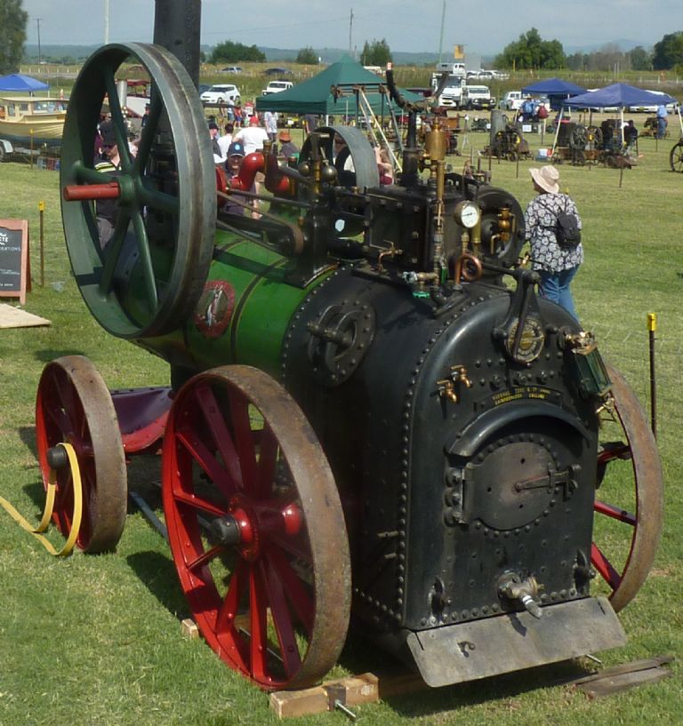

        #545398
        Paul Lousick
          @paullousick59116
          That type of wheel construction was used by a few different engine makers, like those on this 6NHP Marshall portable.
          Paul.

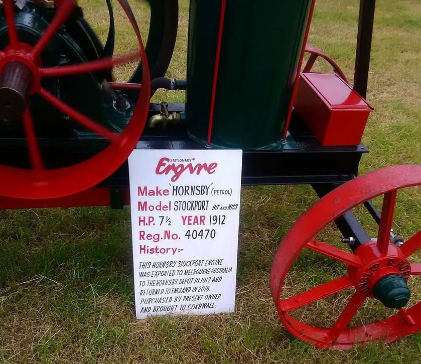

                And these on a Hornsby

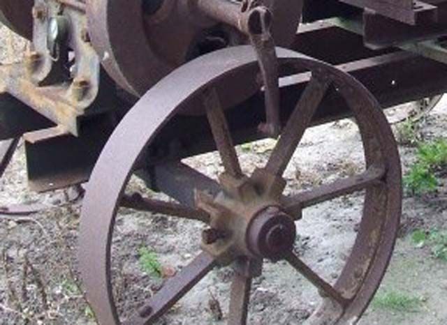

                        Here's the original picture I grabbed:
                        Smaller versions seem to work. Difficult to gauge the scale but I doubt that starting handle is more than 12" long. I caught a passing view of one used as set dressing on 'The Repair Shop' that looked like it was about 18" in diameter and makes me think that they were used on more general agricultural implements. I also guess that they may well have been re-purposed for a cart – farmers never throw anything away.

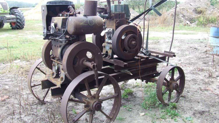

                            Typical cart barrow for a small air cooled engine.

                                    If you are asking about the one I posted then it's and IHC (International Harvester Co) "Tom Thumb" engine from the US.

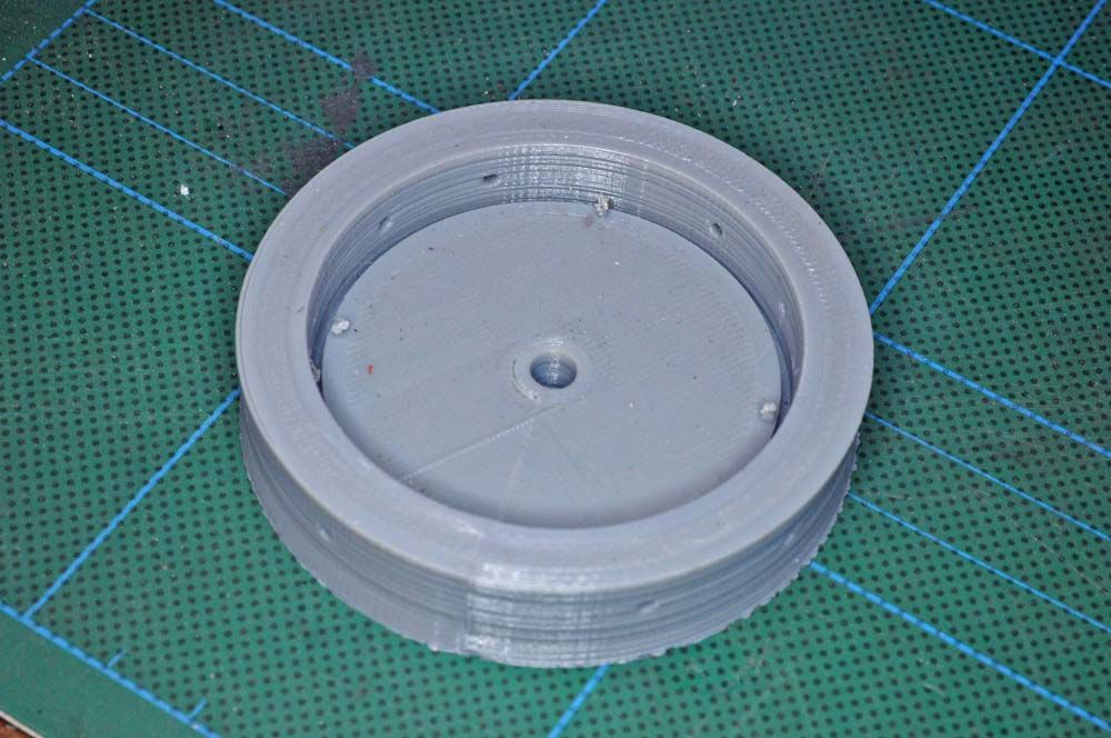

                                      #550816
                                      Roderick Jenkins
                                        @roderickjenkins93242

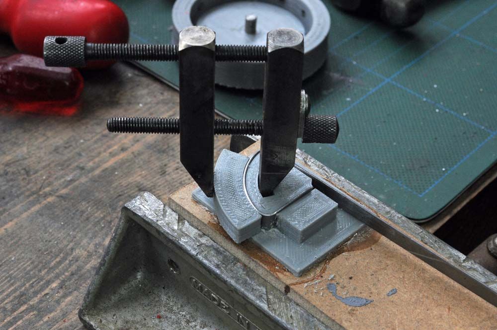

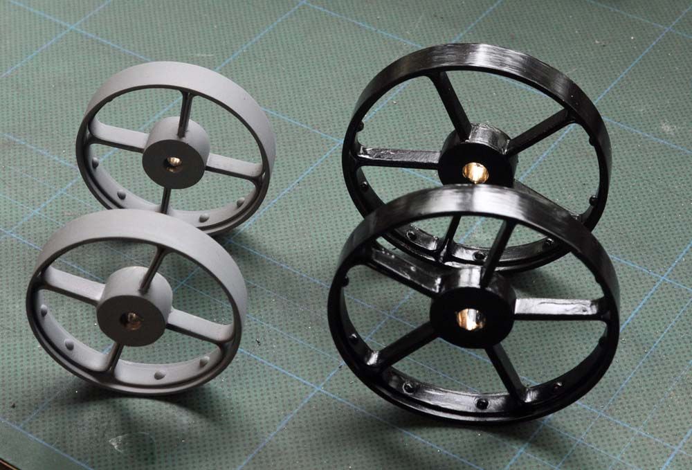

                                        Thanks again for the input chaps and especially to Jason for those links. So far it seems that Marshalls, Hornsby and Boulton and Paul all seemed to use this form of wheel sometimes – all based in the east of England, I wonder if they outsourced them?
                                        I've had a go at making my own so I 3D printed some fixtures (jigs?)
                                        The hubs were sandwiched together with JB Weld
                                        I made 2 sizes (50mm and 65MM diam.) with the idea of making a trolley with a steerable front axle but am coming round to using the smaller pair for a hand cart as in the Chore Boy illustration. The larger wheels were brush painted with straight to metal paint – horrible, will have to come off if I decide to use them
                                        Cheers,

                                          Some lovely work there, congratulations Rod.
                                          #550826
                                            They look the part Rod.

                                                Nice work,
                                                It is a really nice, different way to make a flywheel that I hadn't considered before.
