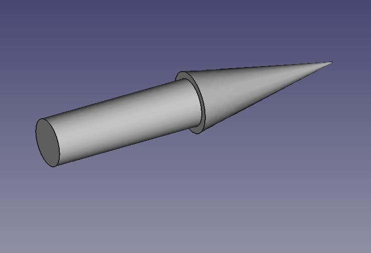

                          OK More detail but not sure I haven't given enough already as it all comes down to a piece of 1/8th dia eound silver steel that approx half is turned down to fit in the punch I have made from EN!A. So one half of the S>Steel needs to fit in the 2.5mm hole drilled in end of hex mild steel and the other half of the S. steel needs tapering then finishing to a point.
                          problem is with approx 5/8th sticking out the 3 jaw chuck the S.steel is very keen to bend. On the Sherline there is variable speed the max being 2800.
                          Chris

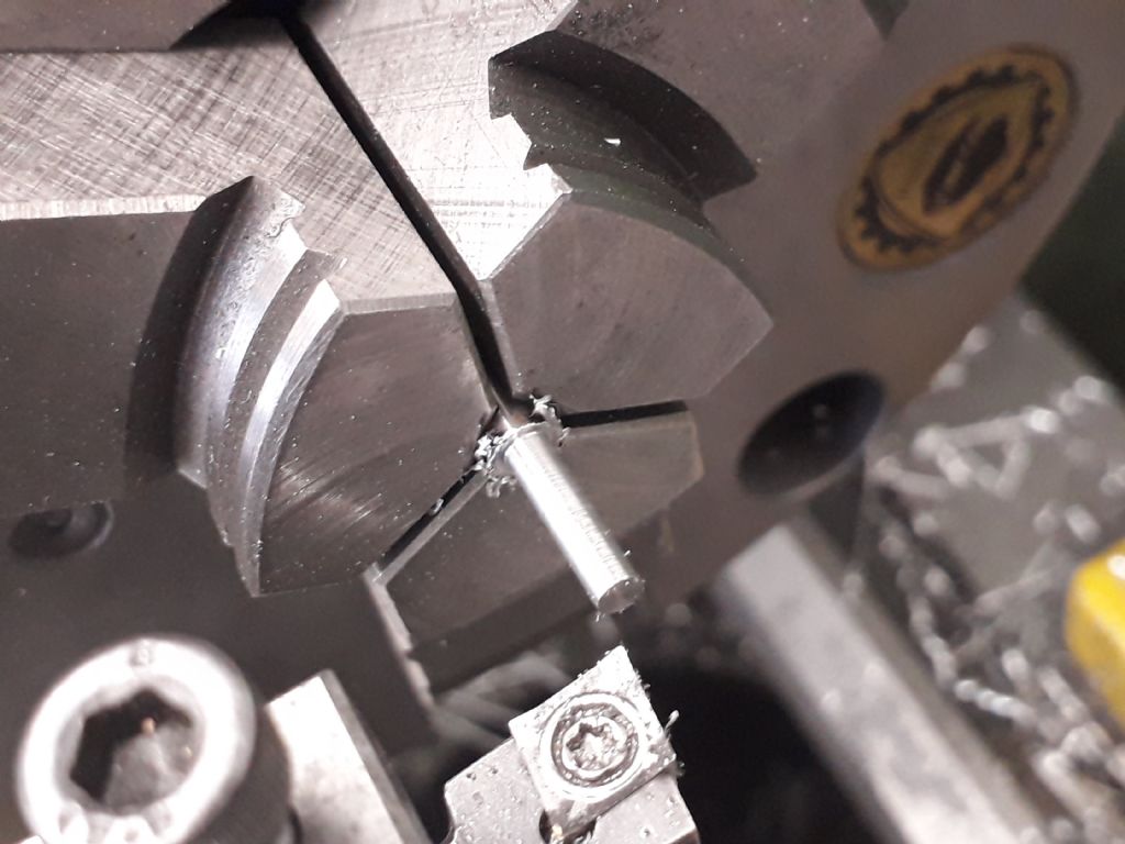

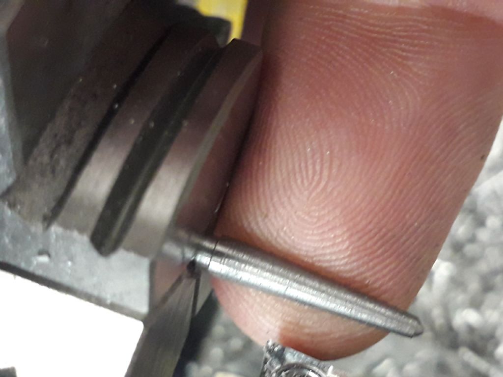

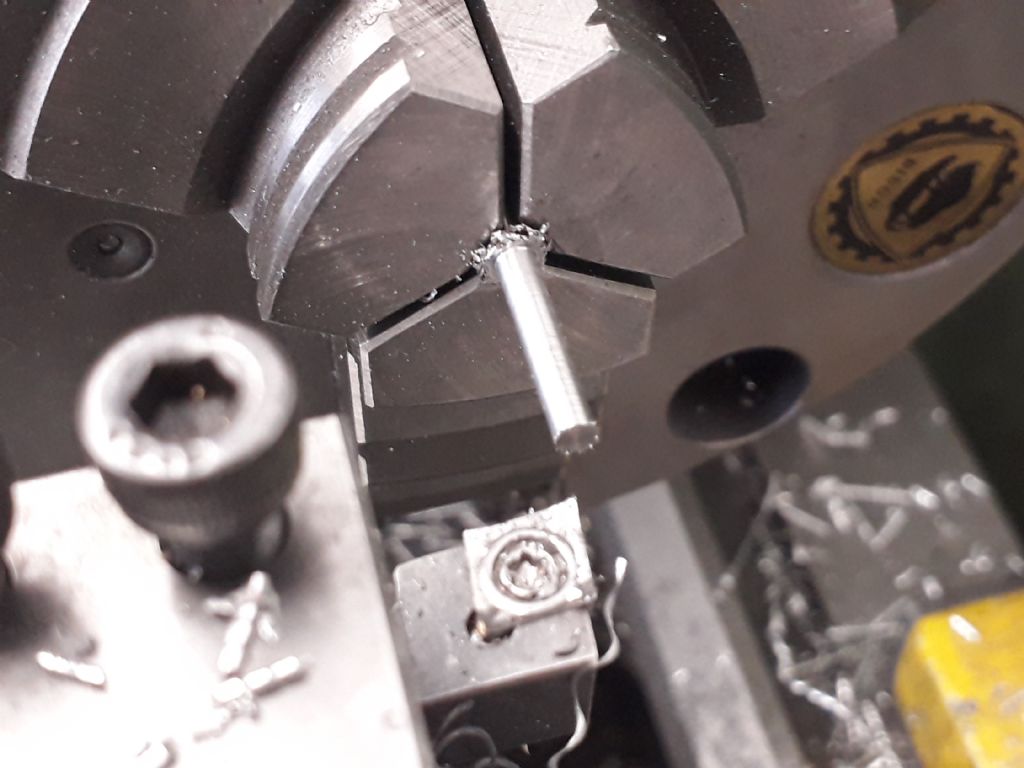

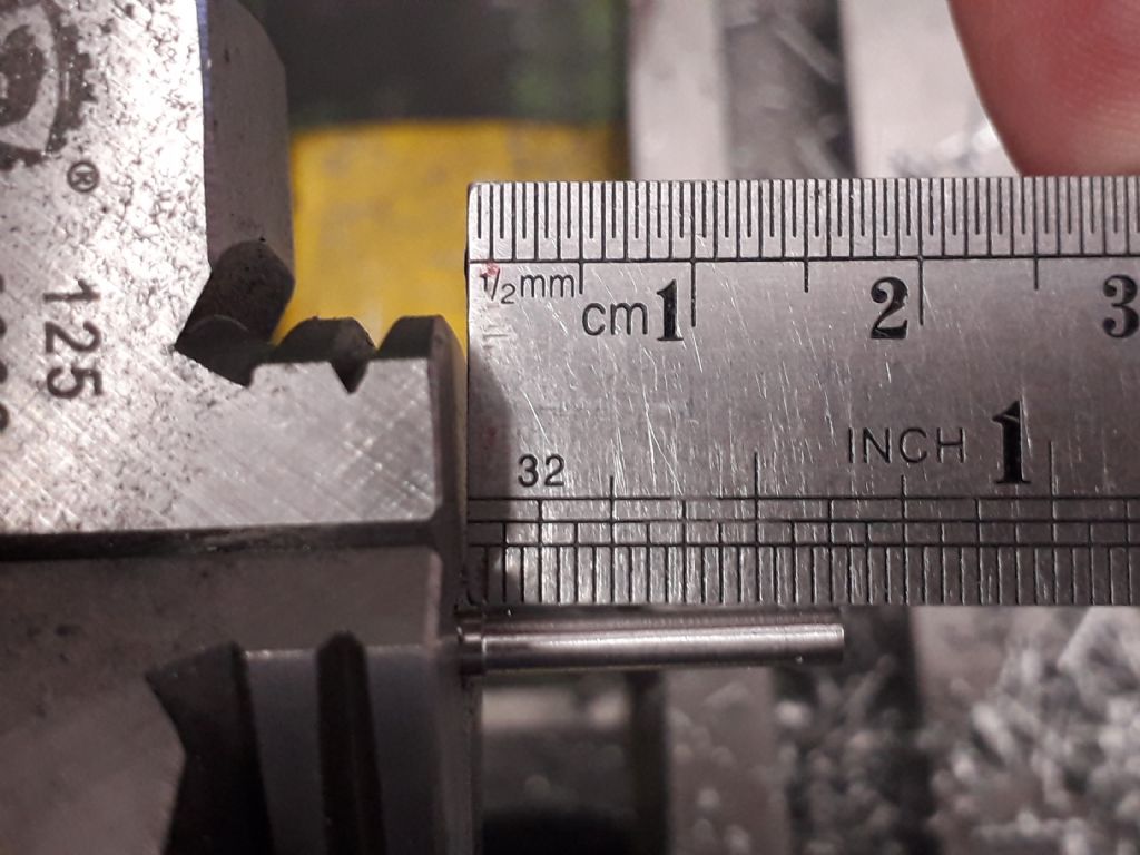

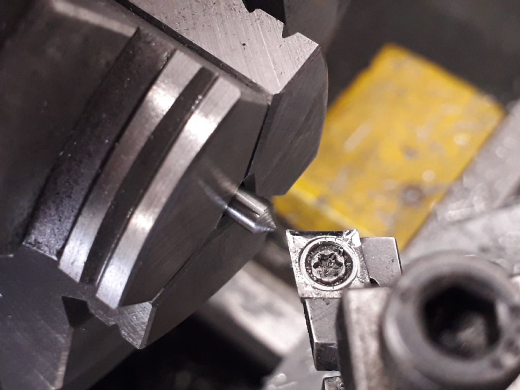

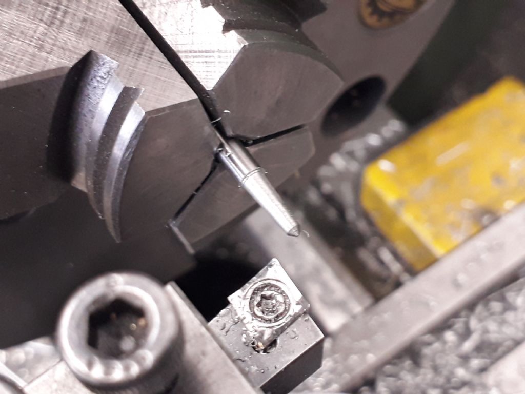

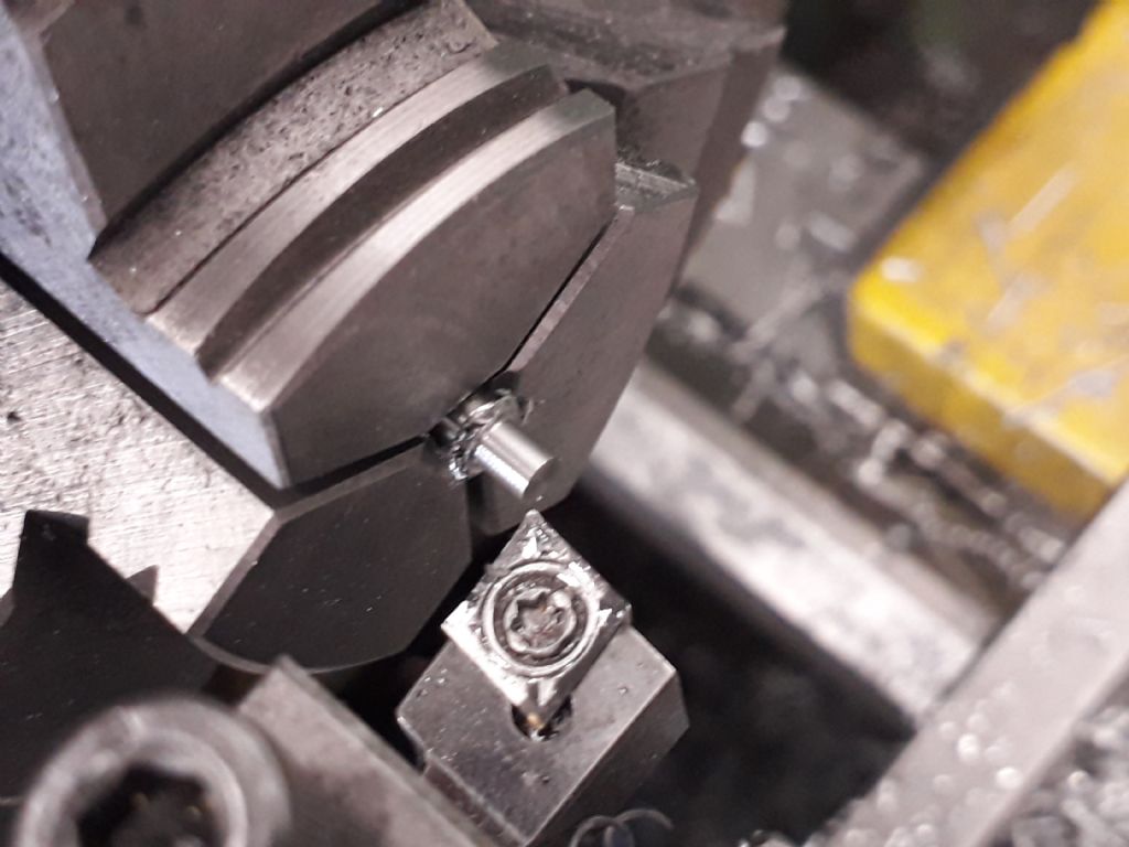

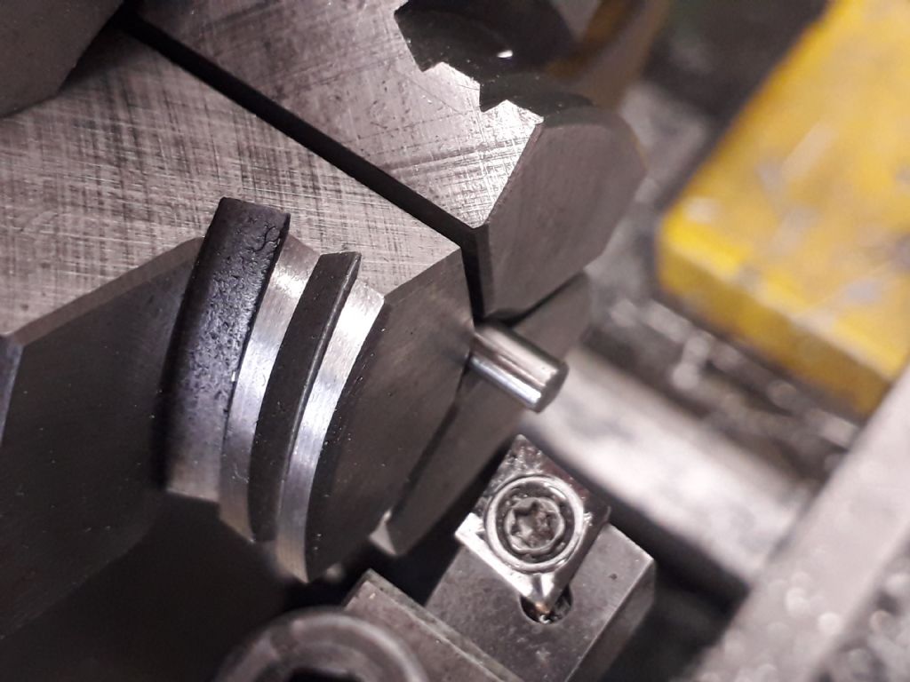

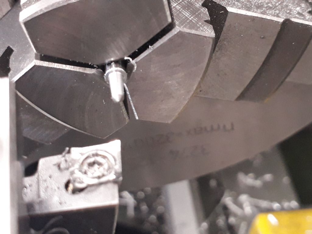

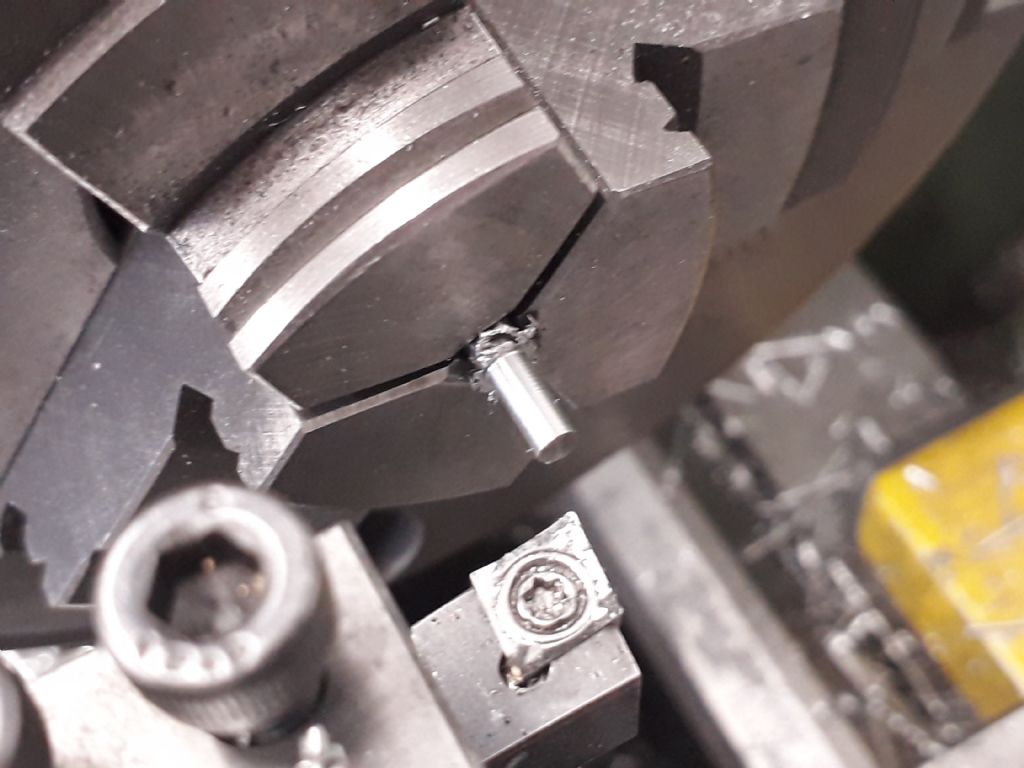

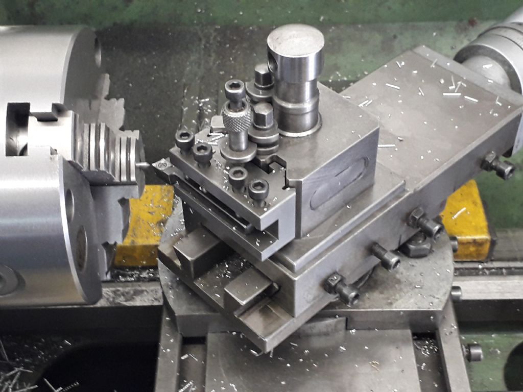

                                  So staying with my approx 1/8" sticking out this is one way to do it without having to bother making tools to make things which is an ever decreasing spiral.
                                  Saw off a bit of rod just over 1 1/4" long and face off
                                  Now turn what is still sticking out to 2.5mm dia I did it in one pass
                                  Slide the work out another 1/8" so total 1/4" sticking out and reduce the next bit to 2.5mm
                                  And again
                                  And again
                                  One more tine and you should have 5/8" now at 2.5mm dia
                                  Now reverse in the chuck again with 1/8" sticking out, set topslide over to 45deg to give the 90deg included angle for your punch and turn a point
                                  Set topslide to taper angle about 4deg and with 1/4" sticking out turn the taper on that bit
                                  another 1/8" etc
                                  last bit will be cut while holding by the 2.5mm dia
                                  Job done

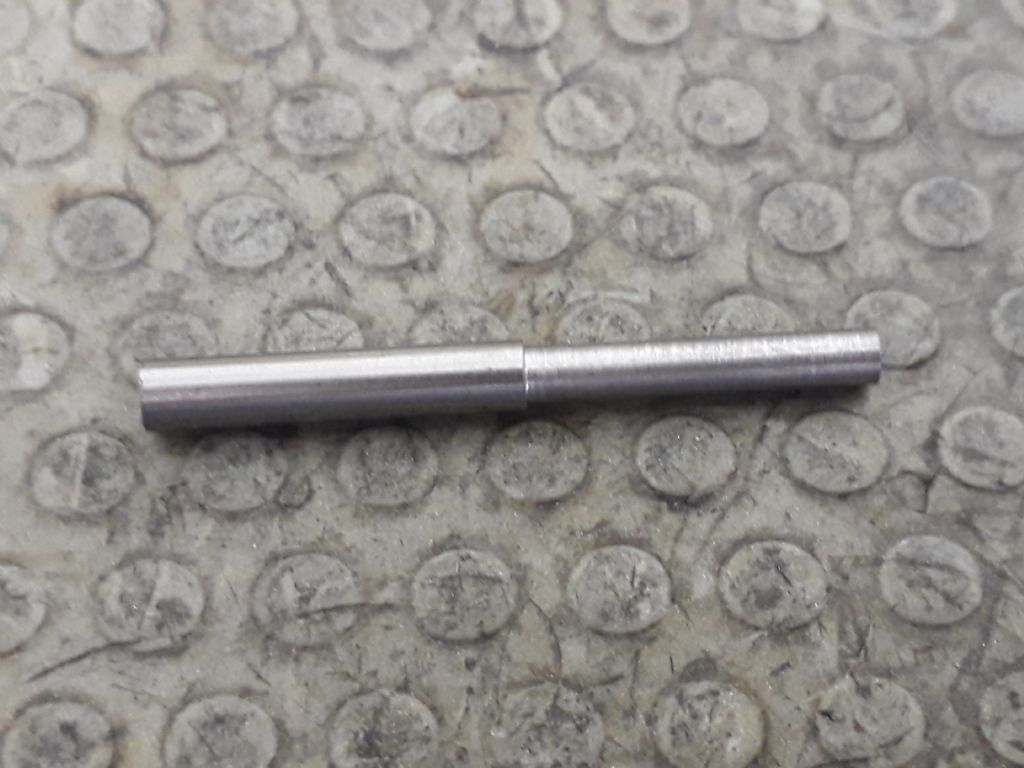

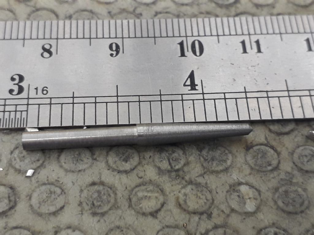

                                                punch2.jpgJob done, thanks to all who helped.
                                                #425963

                                                  #425964
                                                    That should do the job once hardened and tempered and by going for the reduced 2.5mm end you have created a solid shoulder to take the loads.
                                                    Insert is CCGT 060202 so 0.2mm tip radius
