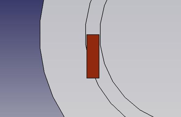

          Make the tool about half the width you have now, you would not try to take a 5mm deep cut with a normal tool at that diameter so why do it with this one. Move it sideways every so often to make sure the tool has good clearance.
          The other question is why trepan out the middle? can you not just make it thinner and leave a hub then cut spoke shapes into the thinner area?

                My first thought would be to reduce the top rake – I've generally used 0 degrees for CI and brass if the tool was made for that material. You can get away with a general-purpose tool with top rake on less demanding cuts, but trepanning's a bit different.
                Secondly I'd agree with Jason about reducing the width, though I dunno if I'd halve it.
                Is there a curve on the front cutting edge? I'm not sure if it's actually necessary, but I've always used one and trepanning *normally* works OK for me…

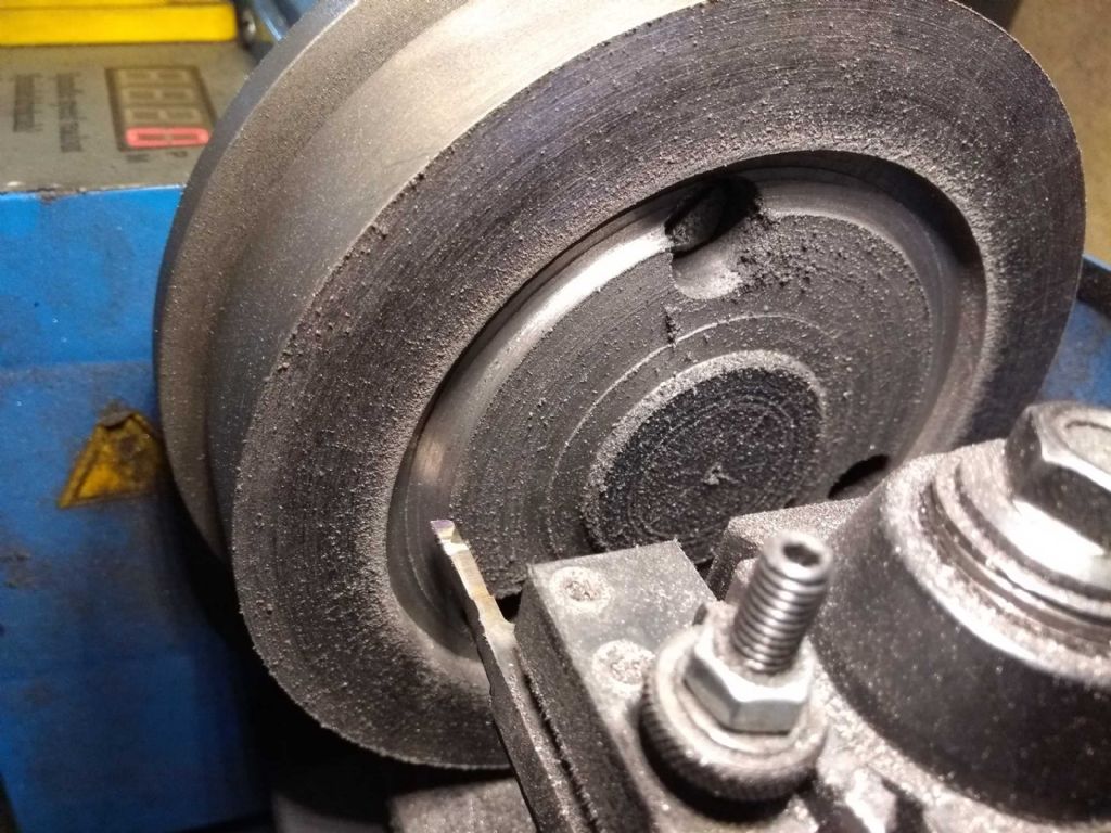

                Iain Downs
                  @iaindowns78295
                  Thanks to all…
                  I wonder if I'm using the wrong terminology.

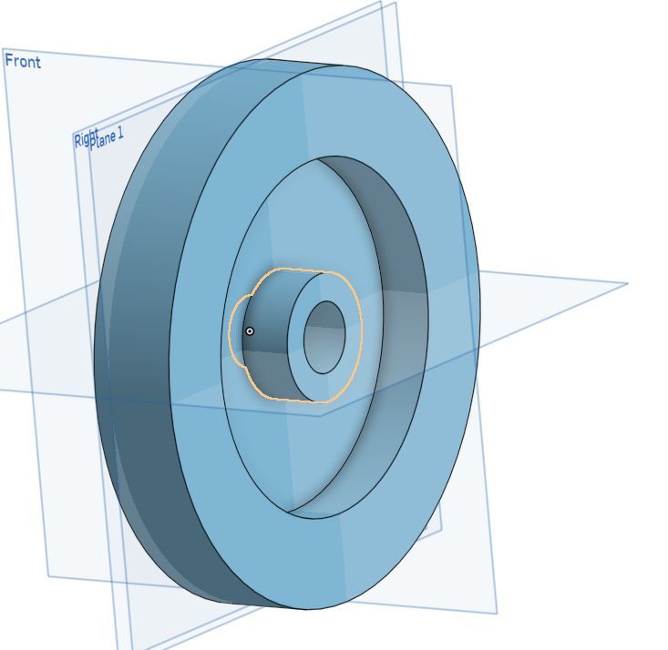

                  This is the thing I'm trying to make.
                  A model of it anyway. There's also a recess on the back side, but 5 mm deep not 15 (though this is a manufacturing requirement rather than a design requirement. I think).

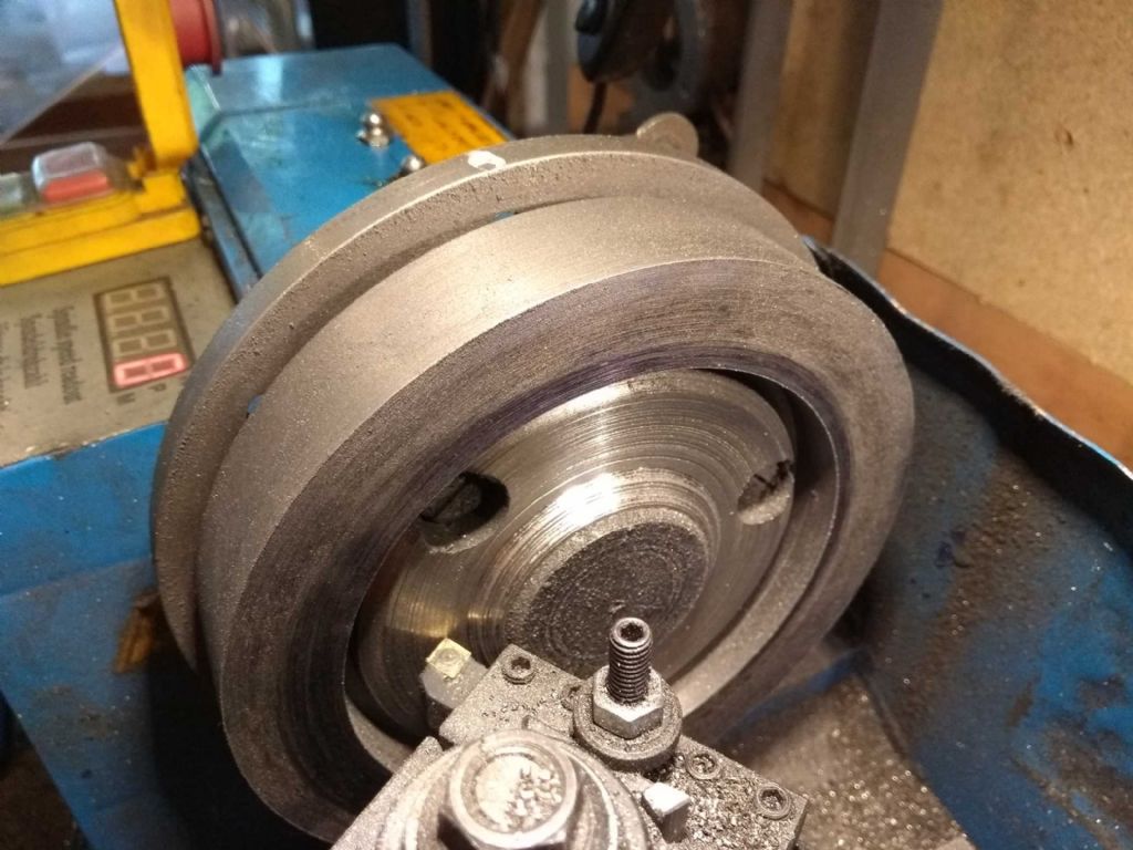

                  This is where I am.
                  I'm digging into the face with the trepanning tool and then was going to go sideways probably with a right hand knife tool.
                  MOst of the progress you see there was actually with a knife tool with at an angle digging in a bit and then to the right, followed by a knife tool the other way to the left.
                  Iain

                    For something like that round the tool and work back and forth across the face while slowly putting on the cut.

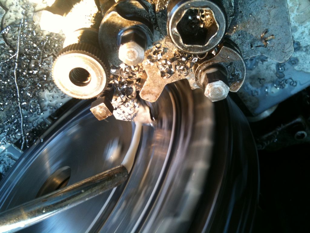

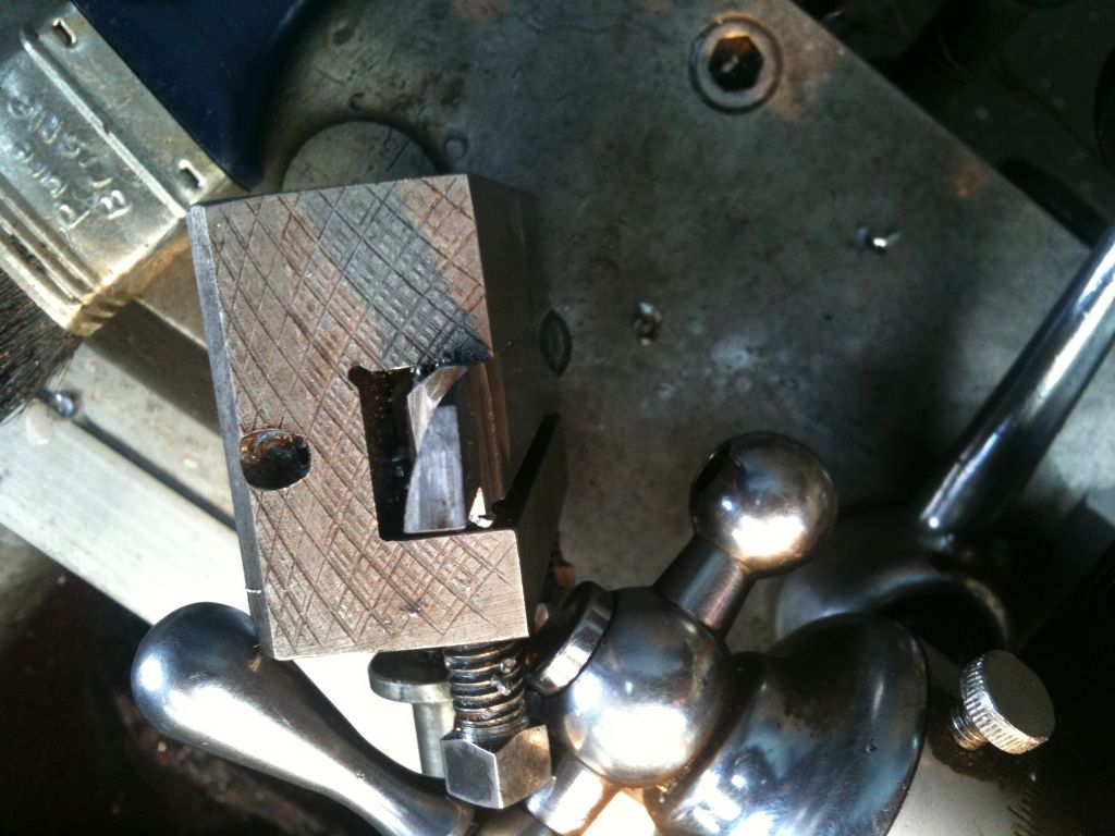

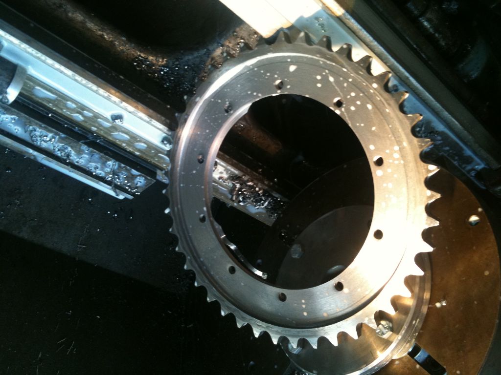

                          Trepanning is a operation that I carry out occasionally. f9644aa1-c052-49ef-afe4-aa0d6adcefcf.jpeg
                          I do this to a 3/4" pitch plate wheel which is then bolted to a carrier, the finished article is shown above.
                          I carry out the operation on a fairly heavy duty CVA lathe using the tool shown below.
                          (This picture is upside down.)
                          I cant remember how wide the cutting edge is but 4 mm would be about right, every time I do the job I consider reducing the width but never quite get round to it. I wouldn't dream of putting the tool to the job without a full flood of coolant.
                          Somehow or other this picture has got upside down!
                          I cut at fairly slow speed to start with speeding up as I get more confident. I hone the cutting edge and maintain it sharp.
                          The whole operation is conducted with tightly clenched cheeks and I'm glad when its finished. The material from which the platewheels are made is, I believe, En8.

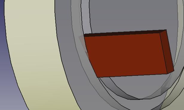

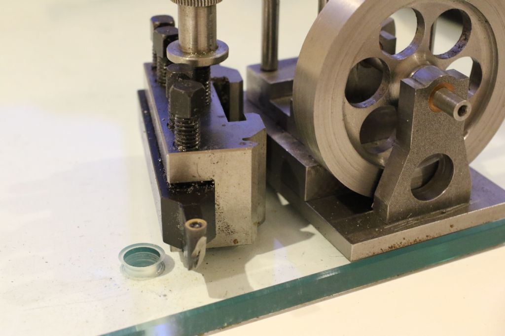

                            +1 on a round insert tool. Had to grind a bit of extra relief so the bottom of the holder didn't foul.
                            #417220
                            Anonymous
                              I'd agree that it would have been better to trepan first and drill holes later. For the trepanning I'd use a multi tool approach.
                              First I'd grind a short "parting" tool from square HSS with the necessary clearance on the outside, say a 6mm deep blade and 3mm wide. Then I'd plunge in 5mm near the outer diameter, move across 3mm and plange again and so on until the inner diameter is reached. Then repeat twice to get near the 15mm depth. Of course you won't be able to get right into the inner diameter on the second and third cuts.
                              Finally I'd clean up the inner and outer diameters and the bottom of the groove using L& R knife tools, or L&R boring bars in my case as I don't have matching knife tools.
                              For cast iron I'd add a little top rake to the tool, a few degrees.

                                  Relief is important when trepanning because there's a good chance the tool will foul the work and it gets worse the deeper you go.
                                  An ordinary parting-off tool collides rather quickly:
                                  For this kind of job I would hack out the centre with a point-first square insert leaving a 45° chamfer on both sides. Then square the chamfers off with right and left hand knives.

                                      Stuart Bridger
                                        @stuartbridger82290
                                        Glanze Circular insert toolholder with extra relief (roughly) ground. Shown with unfinished flywheel for barstock Elmers Mill Engine. Big advantage of the round insert is that you can turn both the inside of  the rim and the internal boss with the same tool.

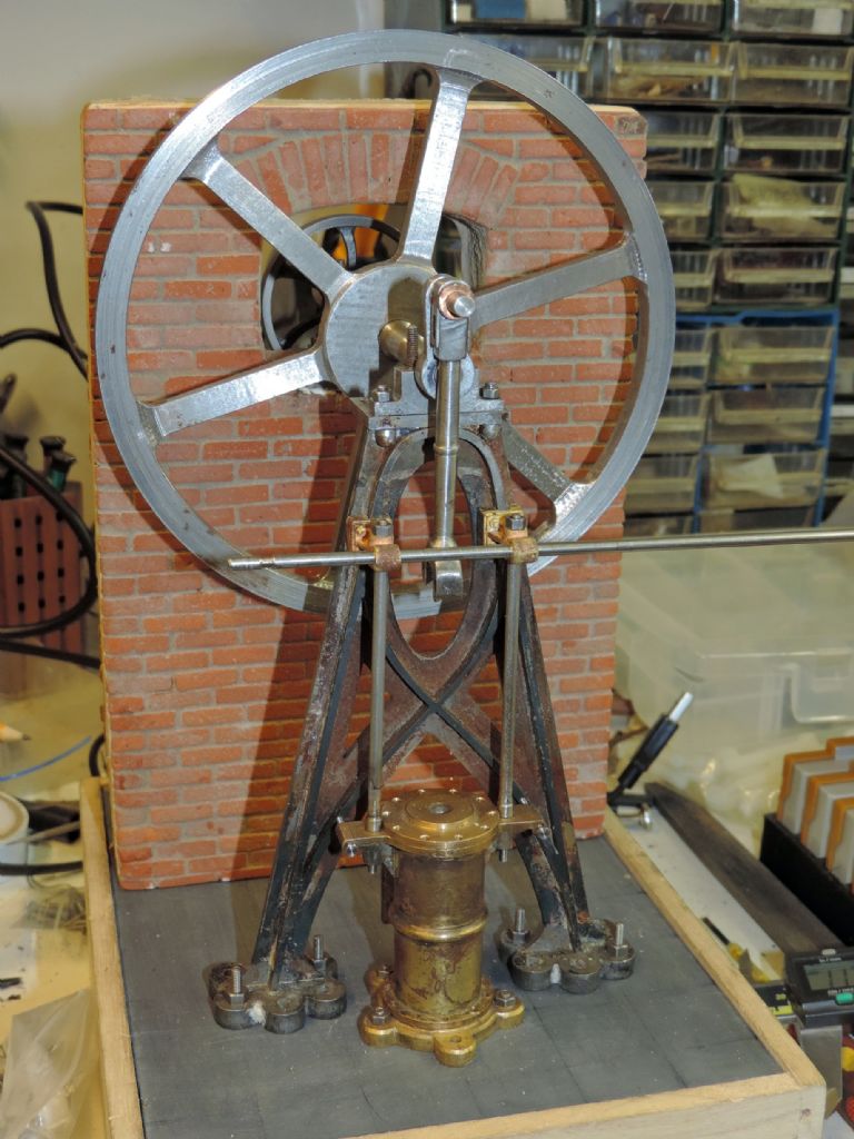

                                          I have done this job as Jason suggests – working a round tipped tool side to side. Works even better if the end of the tool is notched slightly.
                                          If necessary leave the outer radius tapering (that is don't go to the full radius, with each cut do a slightly smaller diameter). Tidy up with a boring bar at the end. Sort of how I did this from a laser cut blank, but used a large radius tool to do the internal corners.
                                          #417614
                                          Iain Downs
                                            @iaindowns78295

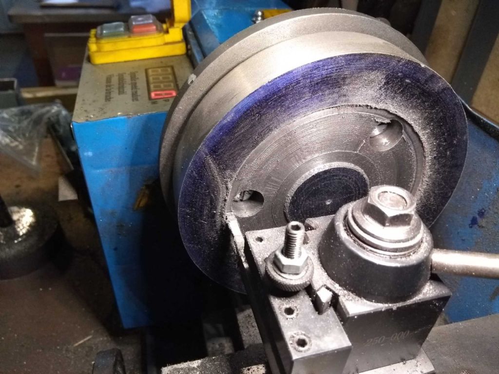

                                            As usual great advice.
                                            The key was to take off the top rake. It's now 0 degrees – well, it might be one degree as per Andrew's suggestion, my hand grinding's not that precise. But it's no longer 10.
                                            I reckon the rake was making the tool dig in and catch which was the heart of the problems.
                                            Still requires a good deal of delicacy.
                                            I could only get in about 1mm without it starting to jam, even though I'm convinced the relief was adaquate (and I kept tuning it), but in this case I didn't need a narrow slot so just plunged in next to it.
                                            I also had a bit of a go at the point technique once the trough was done to start taking the bulk of the metal off.
                                            As you can see it's starting to come together!
                                            Iain
