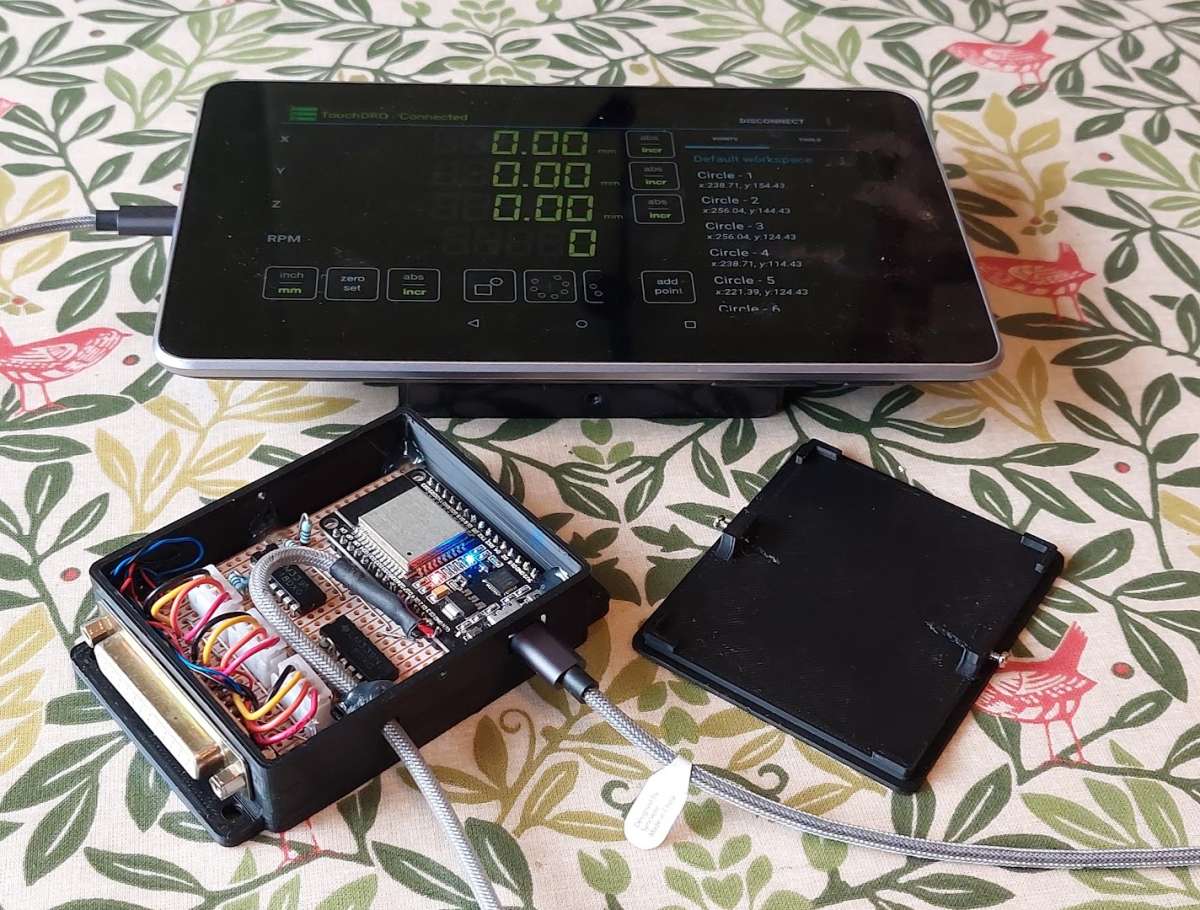

                    Hi Chris, as John mentioned the ESP32 adapter can be built for a parts cost of around £20. I built this one with a 3D printed enclosure to read three Chinese capacitive scales. Andrew.
                    20251005_110215
