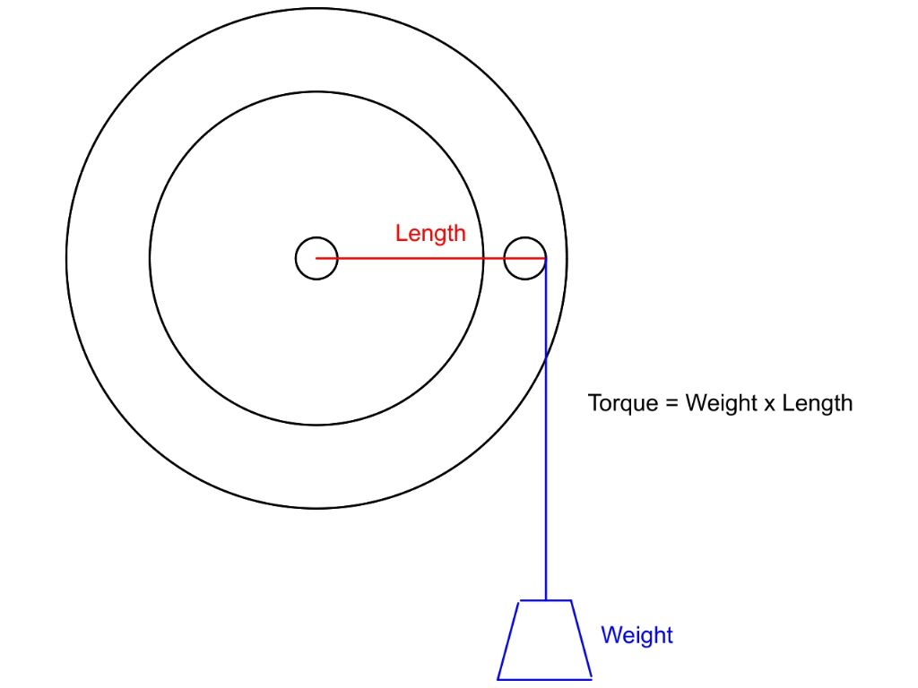

                #251360
                  Posted by fizzy on 18/08/2016 15:58:19:
                  I don't have a spring balance (I do remember them from school) so how do I use tape? Thanks. Im also assuming that the torque required needs to be measured at the crank as it will be a direct attachment rather than from the handwheel? Im confused.
                  Hope this diagram helps. You can measure torque at any distance from the crank because, for a given turning resistance, weight * length is a constant. If length is short, you need a large weight. But as length increases you need proportionally less weight to turn the crank so you get the same answer.
                  In the absence of a spring balance, position the handwheel at 3 o'clock or 9 o'clock and slowly increase the weight until the handwheel turns.
                      The handle rim has a radius so the torque needed to cause movement can be calculated. Same if the handle is used.
                      Tape is just an alternative to string which might be easier to wrap round.
                      Or various weights as Muzzer mentioned.
                      Jason has a point too – really need to do it into a cut.
                      Maybe you have something that you use to weigh luggage when going on holiday? I prefer the spring types as the ones used by fishermen usually a have a sliding part that remains where ever they are pushed to on the scale.
                      frownI've also done it by pouring water into a bucket or jar etc and then weighed that.
