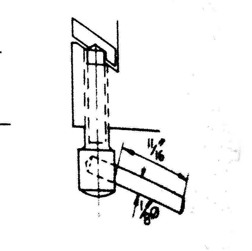

        I recently purchased a copy of Model Engineers Workshop Manual by Geo.H.Thomas and I am interested in the top slide lock, on page 182 of the book fig 16.1 shows the lock screw with it's end turned down to 1/8 x 1/8 then to the right off the lock screw it's shown with a pointed tip piece. I cannot see anywhere in the text anything related to what this tip should be made of, I was this maybe brass but would welcome comments or suggestions please.

            It is not a separate piece, it looks different in the drawing because drawing lower right is partly showing screw through casting and the tip is in "black" as it is a x section.
            It is all one pice of steel with the slightly pointed tip bearing in an indentation in the gib piece. Works a treat especially the pining of the gib to stop longitudinal movement

                I think it may be two separate mods
                The top right one is a lathe users side view for the dowel which fastens the gib to the topslide
                The lower right one is the locking mechanism, turn this 90 degrees anticlockwise to get a users view
                Both appear to be solid mild steel

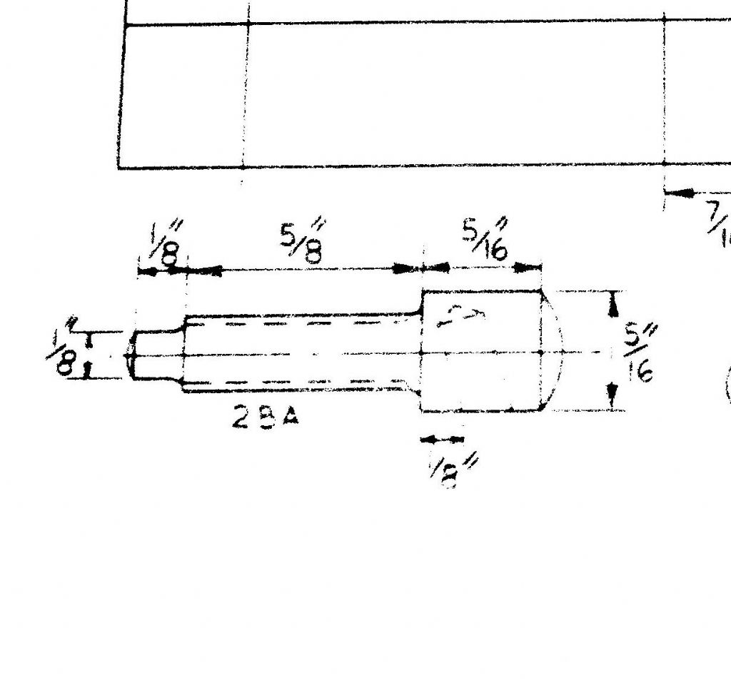

                      img_0061_2.jpgHi and thanks for all your replies/comments is it one piece or two here's a couple of picsimg_0061_1.jpg

                          The 2BA threaded part is one piece steel with an 1/8" pin inserted at an and angle as the locking lever.

                            In the second pic it does look as though the threaded pin has a separate end, but its just where the diameter changes. It is all one piece as everyone has said.
