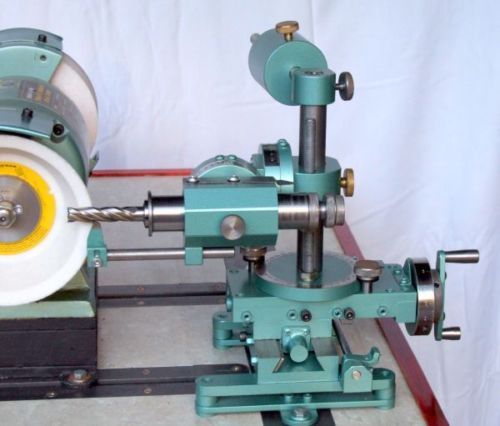

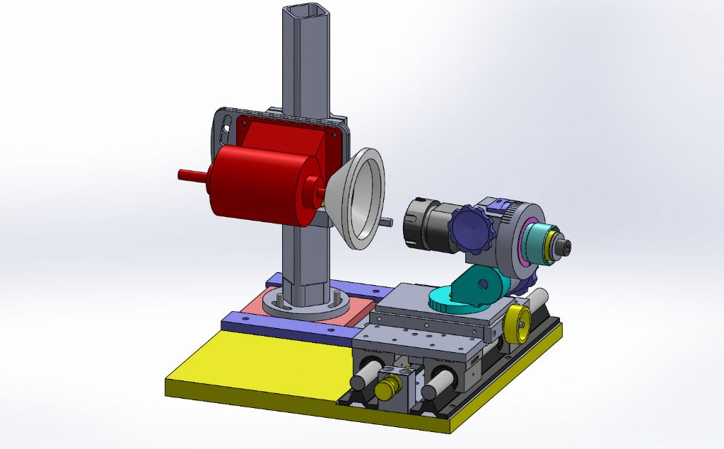

                        Plans for this one are available at
                        http://www.ebay.com.au/itm/Tool-cutter-grinder-PLANS-Acto-/302115704341?hash=item46577fce15:m:m_X1hNGyFu1wh_cQQMHrKbw
                        Edited By Paul Lousick on 26/10/2016 23:18:19
