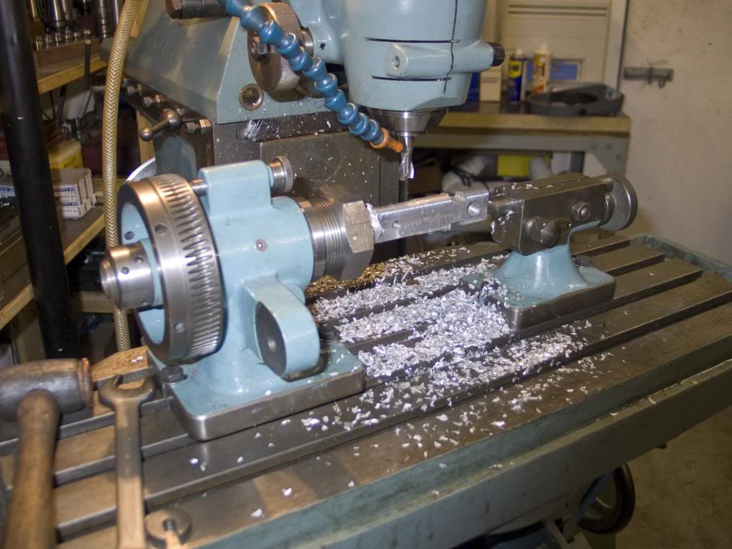

                I made a new spindle for mine so it accepts Burnerd Multisize collets.
                I can hold up to 1" diameter in them.
