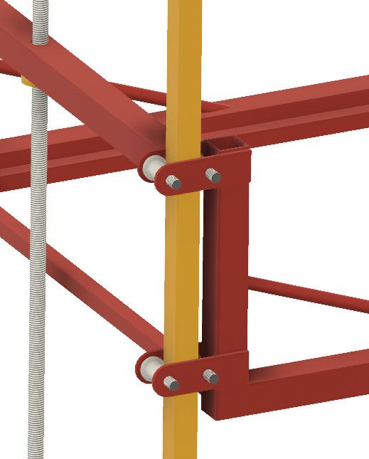

                          If you are literally using the outer of a drawn cup needle roller bearing on a flat surface like a tyre you will have trouble. The walls are not designed to be run un-supported. Running them un-supported will either roll the outers oversize or cause them to fatigue and breakup depending on the material and hardness. Have you considered using bearings with machined rings or even better a track type bearing?
                          **LINK**
                          You might get away with it at light loads but 100kg is not light.

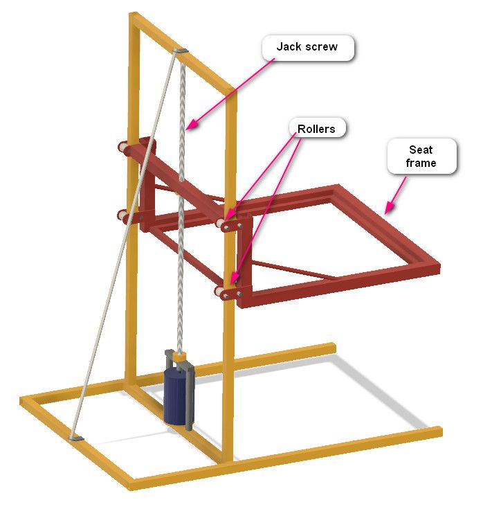

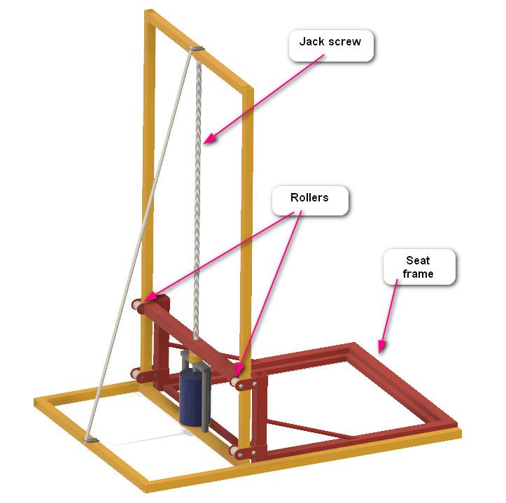

                                        Here is the reason for the query. It's a Remap job to help a 75Kg paraplegic get himself up off the floor onto his wheelchair or bed etc. He has sufficient upper body strength to get himself onto something a couple of inches high, but no higher. The concept is a lift with a seat that is raised and lowered by means of a screwed rod that is rotated by a motor from an 18v cordless drill. The seat, which is only about 1" thick, is raised from the floor up to about 23".
                                        The screwed rod is M18 Allthread, and the nut is brass. Although the motor should be able to lift the person up 23" in about 1 minute, it can't. We think there is too much friction. The original rollers were made of Delrin, but we think that they deform under load to create too much friction. We replaced them with brass, to no effect, so we thought to use needle roller bearings. Here are some pictures from the Fusion design.

                                          Posted by Gary Wooding on 03/08/2019 08:11:11:
                                          A suggestion, if I may, Gary … Re-engineer the roller assembly:
                                          With the seat cantilevered, only the rearmost rollers at the top, and the forward rollers at the bottom actually do any work. … That's fine [i.e. just as it should be], but you need to embrace the fact.
                                          Replace those four rollers with nylon wheels, running on proper bearings, and the other four with simple rods [you can do this because they only act as 'check-straps' and don't actually carry load]

                                            As always with this sort of thing the devil is in the detail.
                                            Delrin rollers should be OK. They work fine on the EazyRizer motorcycle lift which works on much the same principle albeit with single column upright and obviously stronger construction to cope with five times the weight. If I recall correctly from when I had one for about 3 weeks the rollers were rather larger than yours appear to be. If someone local has got an EasyRizer it might be worth looking at it for clues as to why yours doesn't work.
                                            I recall coming across a reference somewhere to the relationship between roller size, loading and freeness of running which suggested that things go very nonlinear below about 1 1/2" diameter leading to much more friction than you'd expect if the design is little out.
                                            I think the thing is twisting which will seriously increase the loads. Having hit that problem in a rather different area myself I think you need either 8 extra rollers to stabilise it in twist or to start over. That rectangular "doorframe" style upright is very flexible. A single, larger, column would be much better behaved.
                                            I'd prefer a proper lead screw and nut to Allthread too.

                                              Hi Michael, I'm not interested in being right, I just want to make a device that works, so I'm open to all suggestions .
                                              In order to reduce the overhang as much as possible I designed the roller assemblies to be symmetrical; all 13mm basic diameters with cheeks or flanges as guides. The "jockey" rollers don't actually do anything except help guide the seat. The axles were originally 8mm diameter. By "proper" bearings I assume you mean ball bearings. I thought of that but was advised that ball races with an OD of 13mm wouldn't withstand the expected forces – that's why I thought of needle rollers.
                                              Unfortunately, increasing the diameter of the rollers increases the overhang of the seat relative to the upright guidance rails.

                                                I wonder whether the problem is the threaded rod rather than the rollers.
                                                18mm diameter seems quite large and need quite a lot of torque to rotate it, I presume the diameter was chosen to avoid buckling.
                                                I would have thought a 12mm diameter screw would be more than adequate if its is in tension. It could be driven from the bottom but the thrust load on the screw would have to be taken at the top (so the screwed rod was in tension) and have a decent thrust race.

                                                    It would be doubtful if the design with a single screwed rod could be made to work reliably, unless the load is spot on for balance the platform will cant over and jamb, you really need two screw jacks geared together, or a pair of winched, which ever they should be placed as far apart as you can get. You might get away with 4 skateboard wheels, bottom ones on the seat side of the pole, and the top on the outside. There is enough material on the wheel to fit larger bearings and still take the outer diametre down a bit.
                                                    A jack arrangement that  I helped design can be seen on the draw bar of this machine for feeding out hay, it will take a load of two or three tons at least. It consists of a 50 sq tube sliding over a 40 sq tube, there is a 24 mm nut welded in the 40 sq and a bit of 24 mm threaded rod down the middle. The jack is designed to be farmer operator proof(almost)

                                                      I originally used M12 Allthread, but it vibrated so much that I concluded it was too thin – hence M18.
                                                      I tried precisely that chairlift Neill, but apart from being rather unstable, it had two insurmountable problems:
                                                      1. In its collapsed position it was too high – the guy couldn't get on it.
                                                      2. It couldn't lift high enough.The seat of the wheelchair is 23" above floor level.
                                                      The part number of the bearings I've purchased is HK0910 (13x9x10).
                                                      I'm pretty much convinced that friction is the enemy here (comments are welcome). Would an Acme thread be any better than a standard metric? What size rollers would be more suitable, bearing in mind that bigger rollers increase the seat distance from the guide rails?
