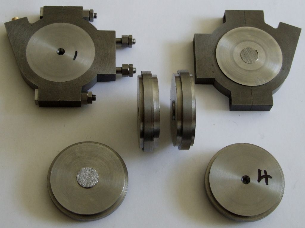

          Yesterday, after it started raining and thus killed any hope of flying the big glider (see note), I started roughing out the eccentric sheaves:
          Next job is to make a jig to hold each sheave to clean up, and bring to thickness, the back face. Bit of a pain, but previous experience has shown that using a chuck can damage the running surfaces and results in thickness variations round the circumference of a thou or two. After cutting a deep groove final 'parting off' was done with a hacksaw. This was mainly due to the workpiece hanging out of the chuck by 6" to start with, and the inevitability of failing to catch the part as it separates and dinging it as it bounces off the lathe bed.
          I was quite pleased with the finish obtained on the 3" bar when taking the diameter down to the initial 2.75":
          I haven't bothered to measure it, but by finger comparison with Rubert it's probably ~1µm Ra. Even better the diameter only varies by a few of tenths over the length. Final cut (insert tooling 0.4mm radius) was 82 thou off the diameter at 370rpm and 6 thou/rev. All the grooving was done with a 3/8" square HSS toolbit.
          In due course I will be boring holes for the crankshaft on the sheaves for the water pumps, as I know the throw. The sheaves for the valve gear will have to wait until I have re-designed said valve gear, or not, depending upon the maths.

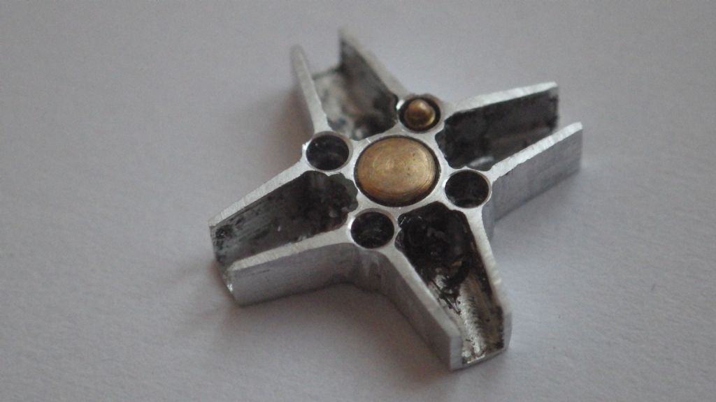

                I've finally got the boring/facing head to work. I had to alter the profile of the star wheels and fettle the drive pins, but it now works as I intended. The feed is VERY fine, even with both drive pins inserted but it remains to be seen how it performs when cutting metal (hopefully tomorrow). While it was stripped down, I tidied up the gib screw locations and re-drilled the slide stop screw location, misplaced due to reading the drawing incorrectly and reduced the size of the travel stops. The feed screw dial has not yet been engraved as I need to decide how to mount the rotary table securely at 30° to the mill table.
                Here's what it looks like now:
                Ready for a test run

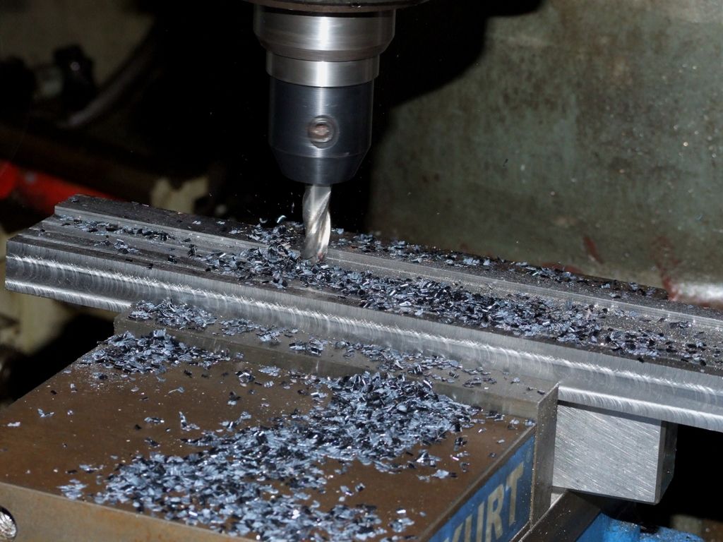

                  Spent an hour this evening hogging out a 10" lump of hot rolled steel to make the water pump eccentric rods. The exercise brought the lump to size in width and depth, plus a 1/16" give or take:
                  The cutter is 10mm uncoated carbide, three flute and is running at 2000rpm, 3mm doc, 7.5mm woc and 500mm/min. The chips are **** hot, enough to turn the air a rather deeper blue than the chips if one drops on the skin. The picture was taken from 4 feet away. smile

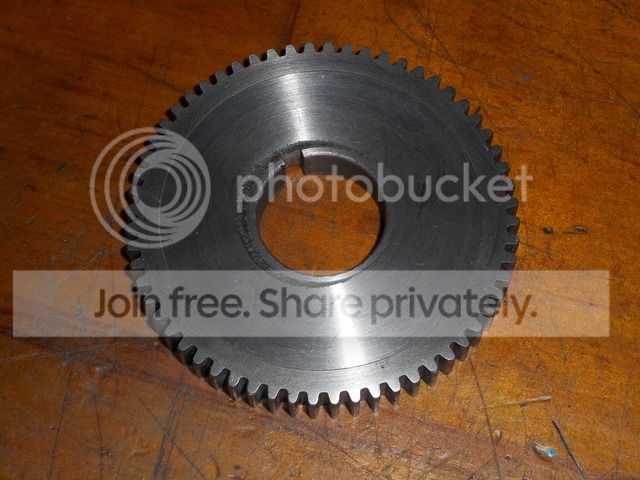

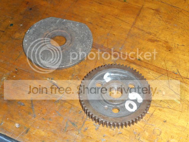

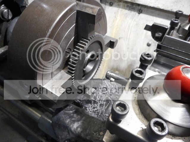

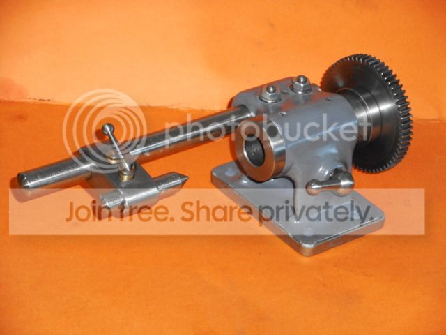

                    Made some progress on the fabricated Versatile Dividing Head after a bit of a hiatus. Got the last ball handle done. Glad to see the back of those critters! My homemade ball turner was never intended for stuff that small.
                    So it was on to the 60-tooth gear. Now if you buy the kit, you get a nicely made helical cut gear that engages nicely with a worm to provide the compound indexing. But this being a scrap-box special, I am using an old 60T change gear off an unknown lathe. Maybe an early Myford or Raglan? I dont know. The worm will be mounted at a 4.5-degree angle so it meshes correctly with the straight-cut gear. Maybe later on I will use the completed VDH to make a proper helical gear. Maybe.
                    Problem using this gear for now is that the gear is cast and has a recess on each side. BUt one side at least needs to be flat and without recess in order to be able to drill the 24 holes used for direct indexing with a spring loaded plunger. OK says I, machine the recess out nice and round and square, turn up a suitable large washer to fit and loctite it in place before machining the face nice and flat all across.
                    Done, but my piece of scrap used for the washer had a big dint in the middle, which left a slight .005" deep  "witness mark" but, hey it will be covered by the retaining nut.

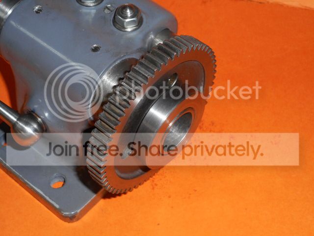

                    I cut the 5/32" keyway (good old GHT could not go with plain old 3/16 or 1/8" ) using a boring bar with the toolbit ground to 5/32 wide and running the carriage back and forth with the rack feed as I fed the tool outwards in two-thou cuts. Actually did not take that long to do and came up quite nice.
                    But on assembly, I still think the recess on the back side of the gear needs filling in, just for aesthetic reasons.
                    After that it will be on with cutting the keyway in the spindle, and drilling the locking holes and spanner holes on the gear retaining nuts and the main spindle collar.

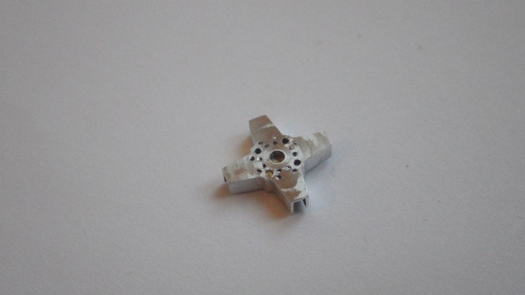

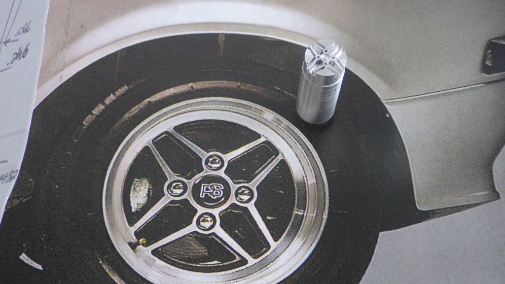

                          Got around to using my microscope mount to make a part. One problem with the mount (among several) is that it needs an alternate boom with an offset in order to view stub tooling at a decent level of magnification and at a high enough level of inclination to give the lay of the land. As it is currently, I'm good to use my 8 mm gear with the adaptor dropping the cutter 3/16" or so, but drilling in milling collets is mostly at the top of the view almost out of sight.
                          That said, I managed along well enough roughing out a wheel centre for a Ford Harrier. At Vancouver mini makerfaire one of the automobile modelling clubs had a flyer saying they were after someone to do up the part. It looked interesting so I bit. Machining it at the show was a bust as I had to first scale it and then draw it out for the angle offsets and only managed to rough out and drill the first blank in the wrong place before I slunk back to making chimneys and sand domes on the lathe.
                          Working with the microscope at home I still managed to knick the centre of the part in a couple of places. I think I can fill them and fix up before parting off the wheel centre. I'm sort of looking forward to hand finishing the little inner radii after all those passes it took to get the endmill to full depth. Tests so far with a sharp exacto seem promising enough. The bolt holes also need counter boring.

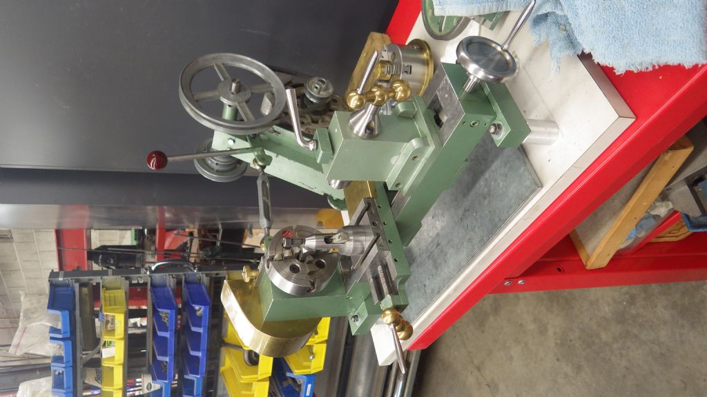

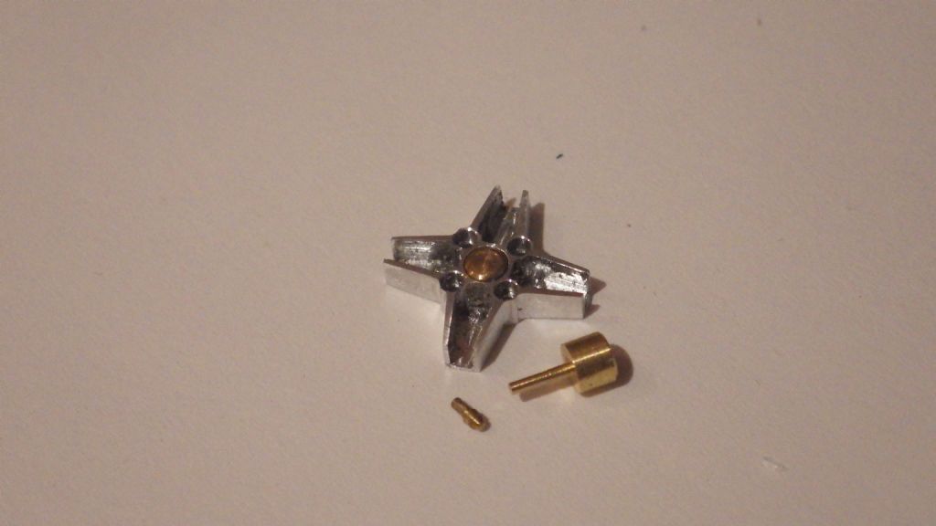

                                        Lost a week to the usual stuff but I managed to make a spindle lock for my Sherline mill. The lock was needed to make a series of small slots around a crcumference that I didn't end up doing. The headstock bearings are from a well used CNC machine due to be replaced sooner or later so I thought it couldn't hurt too much (cuts in the .001"X01" range in 6061). The lock will get used on the lathe until I make a shaper head to work against my rotary table.
                                        Spindle lock precluded doing anything else on the harrier wheel until Friday night when I counterbored it a smidge too large. The button was to pick up the holes. Didn't have the D-bit when I needed it and had to pull the part from the set-up. I raised a burr and will have to face down a couple of thou to get back to the good stuff. In more successful business I made a go at the retaining nuts. So far they're un-hexed. The one in the shot I did by numbers but I've since been to my parents to use the torch and made a small form tool for the domed end of the nuts. That sort of stuff is fun. Cleaning up the wheel would have been a breeze had I been able to mill the part to depth but I had to extend it manually and that precluded parting /facing it off at a million miles an hour. I've made some small steel blocks to sand/ grain with that I haven't tried yet. Most of the epoxy held up. I suspect that which didn't got contaminated. It has mostly been fun and very educational for the next couple of jobs I have lined up. If I get asked to do it again or have to remake I suspect I'll CNC it but I'm worse at that and it's never any fun.
                                        rimg0758.jpgrimg0762.jpgrimg0763.jpgThe photo below is a lathe that one of the BCSME shop gurus built forty odd years ago when he had a highschool gig showing kids how to build machines. A friend of mine with limited resources wants to get a lathe and so Ian MacGregor brought his machine into the shop. The feeling is that there are enough unfinished spare parts around that my friend could be up and running with his own variant for a minimal outlay and the machine would also work well with his living arrangements. I believe it is to the 1937 woodson design with updates as Ian saw fit. Topslide is just out of picture.
