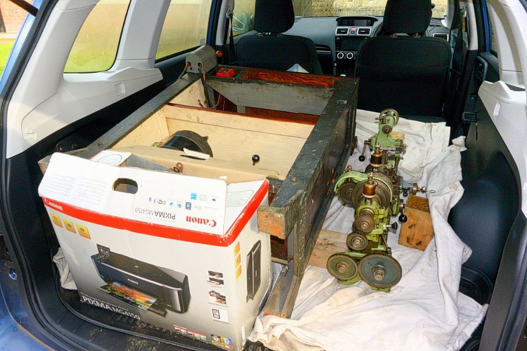

      disgust I drove 350 miles total to get this yesterday.
      Worst thing was I couldn't find much wrong with it to knock the price down.

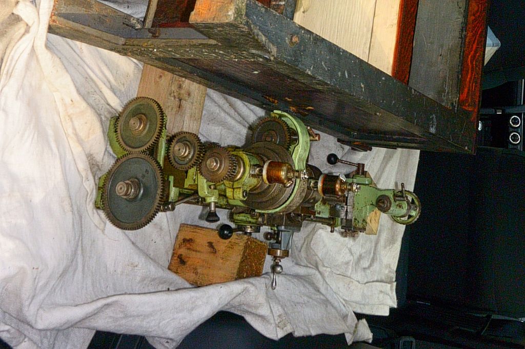

      Slightly better shot of the lathe
      Even more shots here
      **LINK**.
      A Supa Dupa Adept would be no good for me so thought I would give this one a try. It's 27" long 3 1/2" centre height and came with steadies and change wheels. Even a 127 it seems. The makers name is also cast into the legs of the stand.
      Not much info about the maker but there was a company called Crosthwaite Furnaces who later joined up with a tool making company. There is also the place itself in Cumbria. If anyone has seen add's in old Model Engineer etc I would be interested in any details. I do want it to use though. Spured on by JS's comment that we used to make crap here. I used an old large Victorian lathe briefly once and it was one of the better lathes I have used. Be interesting to see if the small ones are as good but I suspect these are newer.

                It is the same lathe. Initially owned by a doctor then a chiropodist. The motor drive stuff is also with it. Hefty cast iron again. Motor full of dust so I suspect that will have to go. Going on the cost of some of the motor drives mentioned on lathes co the doctor must have been rich and bought the lot including the steadies and purpose cast mounting for the lathe itself. Some one also made a myford style dividing attachment for it and the plates. There is a lot of bits to sort out.
                Think I'll call it a Super ML1A. the version they should have done. I mean, it's got tumbler reverse built in. Centres look to be circa 15 – 16". The bed is unusual. It's an I beam. I did wonder if it was made out of an old cast I beam but the base frame is cast as well with the same name on it.
                I didn't have much luck finding warts. The tail stock quill is very loose so will need to fix that. Maybe it comes on centre when clamped. It does lock solid. The bed may be a bit looser in the centre. Hard to tell so maybe not. Next to no play on the lead screws – as new I would say. No dial on the screw cutting lead screw. The saddle is reasonably wide compared with the width of the bed – better than many. No gap bed and for some reason the V finishes short of the headstock. Looks like it was cast like that.
                It should have bronze bearings. Rear definitely is. Can't see the front one and sometimes people remove them and make a new spindle to run in the cast iron. If anything needs doing with these I may change the arrangement completely or try and use sintered bronze. None destructive I suppose if I change the arrangement

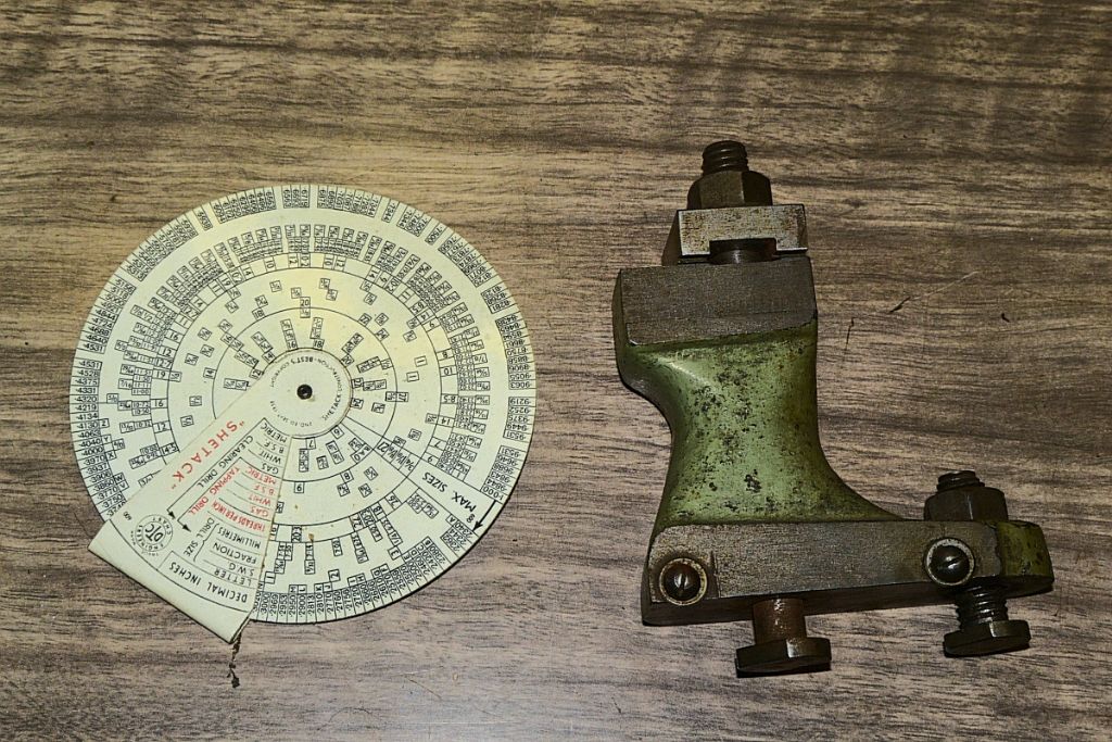

                              I've found a Crosthwaite parting off tool holder. Interesting idea,
                              The round thingy is for thread pitches etc. Dated 1938 and includes metric coarse and fine. It reckons 3/16 for M6. devil (Thread engagement posts) There is also a well made vertical slide fitted with a toolmakers vice.
