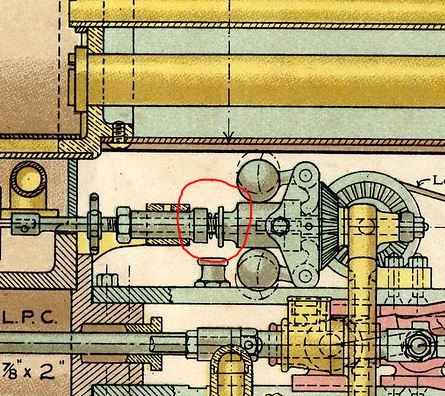

      Yes I know this is an old design, Greenley from 1908 and the re-design by Taylor from 1971.
      Just bought a set of drawings, and there doesn't seem to be any mention of copper thickness, or working pressure, for the boiler.
      Greenley suggested 15swg, 0.072", 1.80mm, as suitable for a 5" diameter barrel with 75psi. It is a compound so wouldn't 100psi be better?
      With a 5" barrel for a traction engine or loco then 3mm seems to be the minimum thickness?
      An alternative could be to make the boiler only 3.1/2' or so diameter, it isn't going to be worked like a loco so just enough steam to turn it over would do. Reduce the copper cost as well!
      There also seems to be one or more drawings missing. It is very hard to make out how it is all plumbed together around the cylinders. There is this ring mentioned but what is it for? Why not flange the throat plate forwards and backwards?

                  Martin Johnson 1
                    @martinjohnson1
                    Just had look at Jasons link to a print on Flickr. The boiler definitely needs updating, but the governor caught my eye – there does not seem to be a return spring, so how does it work?
                    Martin
                    #618871
                      12swg sounds a sensible sort of thickness and a nice model Chris
                      martin I think there is a spring
                      #618877
                      Chris Gunn
                        @chrisgunn36534
                        Martin, there is a spring in the sleeve.

                                      The coloured drawing I posted a link to was part of the 1903 Greenly article, clearly has 75psi as the safety valve pressure which would be fair to take as the working pressure.
                                      #618945
                                        Posted by JasonB on 29/10/2022 10:07:39:
                                        … and rather a fine image it is too yes
                                        I’ve just downloaded the ‘full size’ file to admire.
                                        Edit: __ personally, I think the use of “brass tubes” without any material specification might be of more concern than not specifying the copper thickness. …But, It’s from 1903, and ‘of its age’
                                        Note: I have never seen the ‘manufacturing’ drawings, so am only commenting on this image.
                                        Edited By Michael Gilligan on 29/10/2022 10:27:52
                                        #618969
                                          I did also mention the brass tubes when I posted the link.
                                          It's not just the main tubes, if the colours are consistant then there is so much brass in there such as the front plate of the firebox, all the firebox stays etc.
                                          I is also almost entirely held together with caulked brass (yellow) screws.
                                          Just like the watercolour washed shading the drawing is of its time just as much as the materials and construction methods. It would be interesting to compare with the later Taylor drawings.
