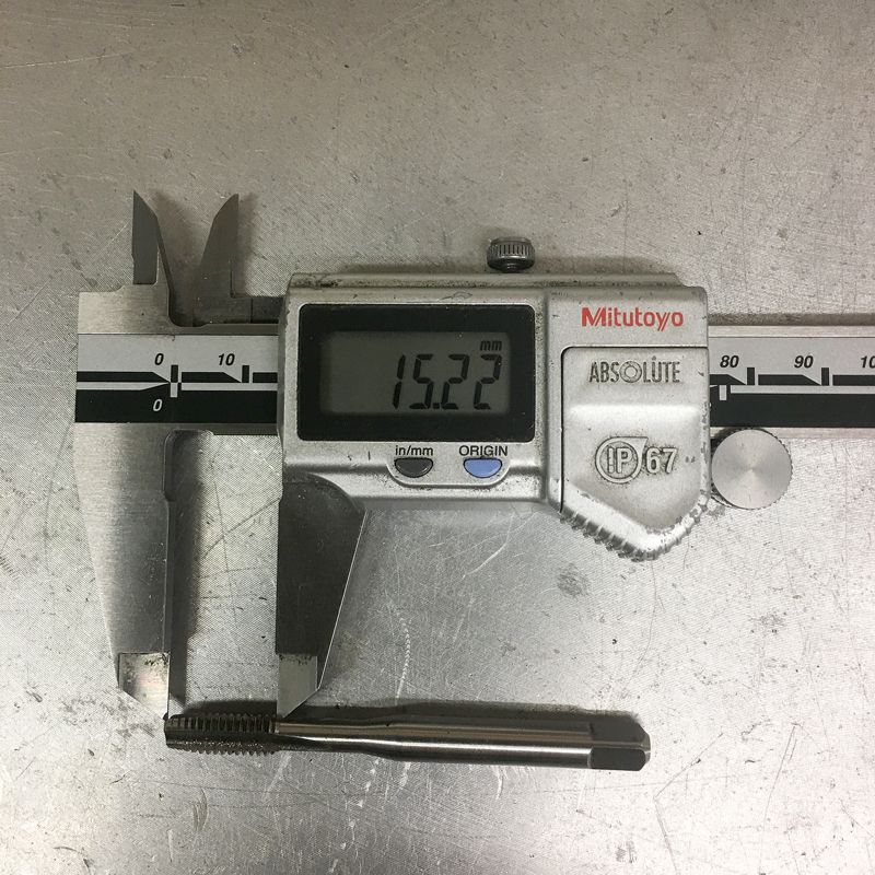

      Can someone out there give me the lowdown on taps and files, let me put you in the picture I bought some taps and files from B&Q, what can I say they were a complete pile of rubbish the taps wasn’t even very good for cleaning up an existing thread, never mind trying to cut a new one.
      The files again after a few rubs was like trying to remove metal using a nail file, you know the type the ladies use for shaping their finger nails, I believe both of the above sold by B&Q are made from carbon steel which is absolutely useless.
      OK the taps namely an M6 x 1.0 2nd, I’ve been looking on e-bay at HSS Volkel and I’ve found the business end, the end which does the cutting is only 19mm long.
      Now I’m going back donkeys years but I thought they were about 1.25 to 1.5 inches on the end which does the cutting unless of course I’m getting mixed up with the old whitworth taps.
      My question, is 19mm long about right for an M6 tap??
      I’ve tried to find a standard which states how long the cutting thread end should be for the various size metric taps, can anyone tell where can get this information from??

          Don't know of a standard for cutting end length on taps, but usually they are relatively short these days, 4 or 5 times the tap OD or so. Certainly not as long as you remember for M6. Enormous thread engagements usually don't help an assembly much, the first few threads do the major part of the holding anyway. If you have a deep hole to tap, like a pulley hub on a flywheel, you can always bronze weld or silver solder a mild steel rod to a regular tap to reach in.

            This is a Dormer 6mm 2nd tap.
            I have ground the very tip off though. (before the cutting edges start) So yeah, I would say about 19mm is more than enough for a M6 2nd tap as this Dormer one is less than that.

                    Any tap beyond the first tapered tap will have already cut threads to keep it aligned, so they do not need to be so long. Even in deep threads, the tap will only be cutting threads over a short distance.
