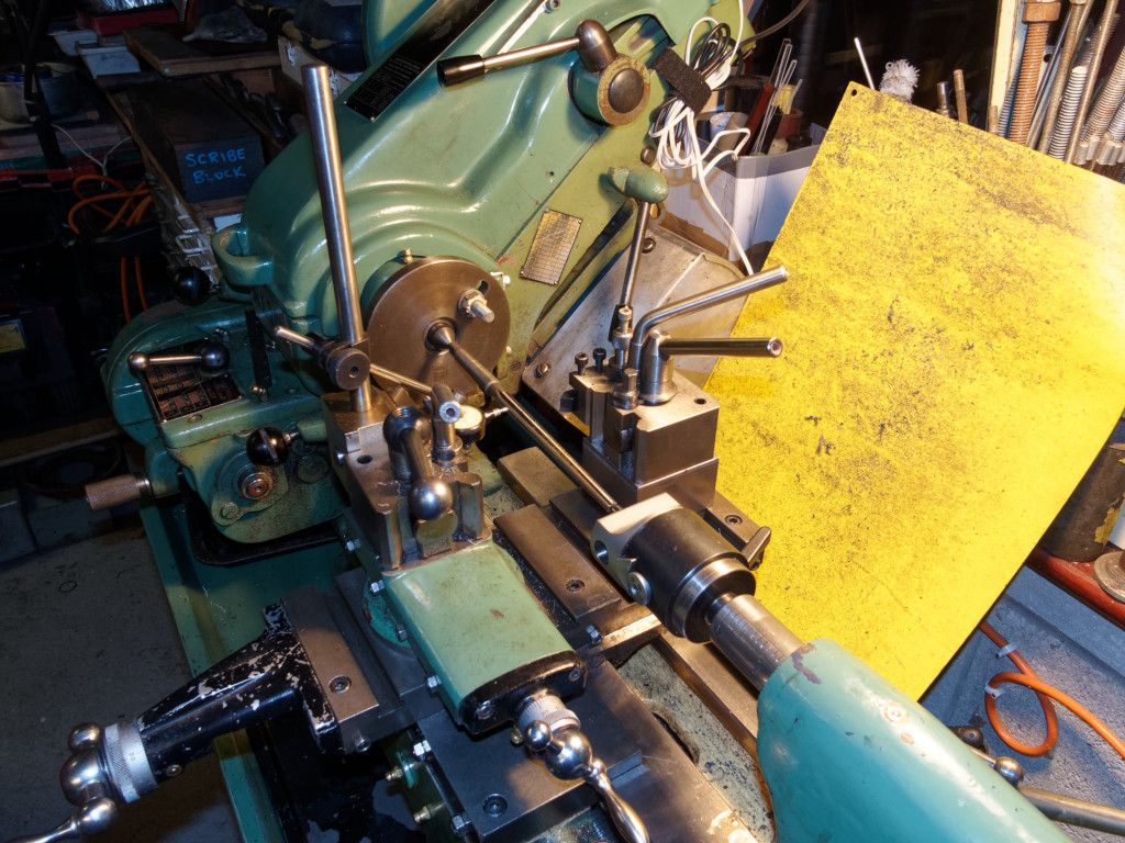

              George, If you have a boring head, have a look at the two photos below before you disturb your tailstock setting.
              The idea is that you can easily dial in a chosen offset using the sliding part of the boring head.
              In my case I made the boring head centre using a broken solid carbide centre drill.
              I had a need to make a taper pin for a newly acquired shaper, so clocked in the correct offset using the actual taper pin reamer that I was planning on utilising to re-ream the clapper toolpost.
              Note Imperial reamers are 1:48 taper, whereas Metric are 1:50
              The one thing you must remember, in a case like this, is that the workpiece must be exactly the same length as the taper you are trying to reproduce; centre to centre. In my case that was way too long for the pin required, so I just turned the workpiece round and made a spare.
              The photos below are a quick lash-up I've just done to illustrate the principles for this post. At the time, I had a clock set up more rigidly in the front toolpost.

              There are ready made devices available for this type of offset turning, but why shell out if you already own a boring head.

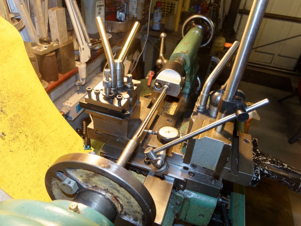

                                            Pete Rimmer:
                                            Was it this kind of thing you had in mind?
                                            The adjuster screws can be seen bearing on the "topslide" base (it is actually a cross slide adopted for its extra length in boring a taper in work supported by bush-type steady).

                                              Yes that's exactly the idea. It was a one-off setup for cutting one particular internal taper angle in a hardened shaft using PCD tooling.
                                              Love that cross-slide idea.

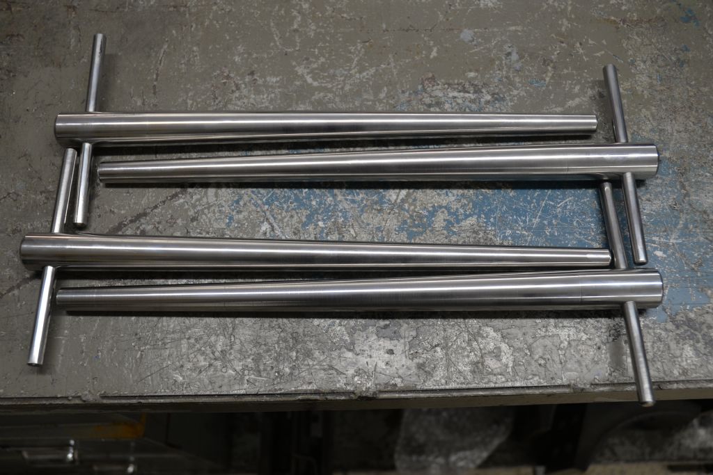

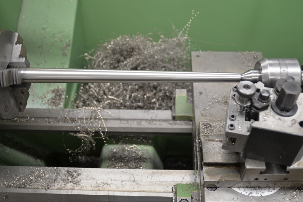

                                                David Standing 1
                                                  @davidstanding1
                                                  You can cut a long taper just by offsetting the topslide.
                                                  The one I recently did in stainless below was 300mm long, involved resetting the top slide five times.
                                                  Get your initial taper calculations spot on, and take your time, one perfect taper.
                                                  I had to do four matching ones too! surprise
                                                  My neighbour builds and repairs oak framed buildings where the mortice and tenon joints and braces are joined with oak pegs, he asked me to make him some framing pins, so he can rough assemble frames prior to installation on site.
                                                  Christ, they were a lot of work, but they turned out well smiley
